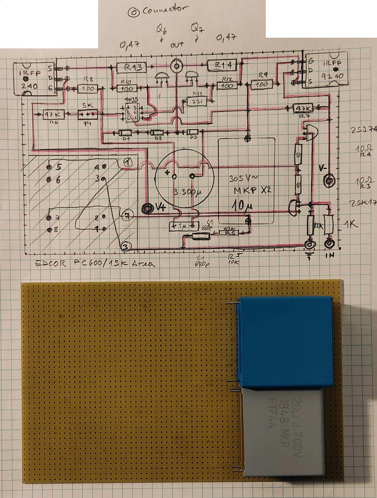

Hi all,
After the successful diy assembly of another PASS amplifier (the Aleph 30) and after enjoying it a LOT, I'm very motivated and planning to build the M2.
As the M2 has less components I'm thinking on using a 160x100 mm perforated pcb and making point to point soldering with copper wire (it's not the first time I do this, so I feel confident. In fact my TDA1541A nos DAC was made this way).
In any case I would like to share my first sketch of the pcb layout (it's hand-made, sorry for that) just to ensure it's correctness and maybe get some advice.
The overall dimensions of components should be substantially correct. The lines red highlighted with crayon shall be interpreted as galvanic bridges and the view is from above. Two upper corners are to be cut to place the mosfets.
I have a question regarding C2 (10uF). I have at home some MKP big caps and two of them can also be seen in the photo, so I would like to use one of them (the blue or the grey type). The blue is a big 10uF MKP high voltage X2 type and the grey is a Vishay 20uF (700V model 1848). I guess that the MKP shall be the best option in this position (signal path) and I also guess that 20 uF can work as well (or even marginally better regarding the low frequency cut-off) as the 10uF. I'm right?
(I would prefer the 20uF as it's the smaller of the two).
Many thanks
Many thanks

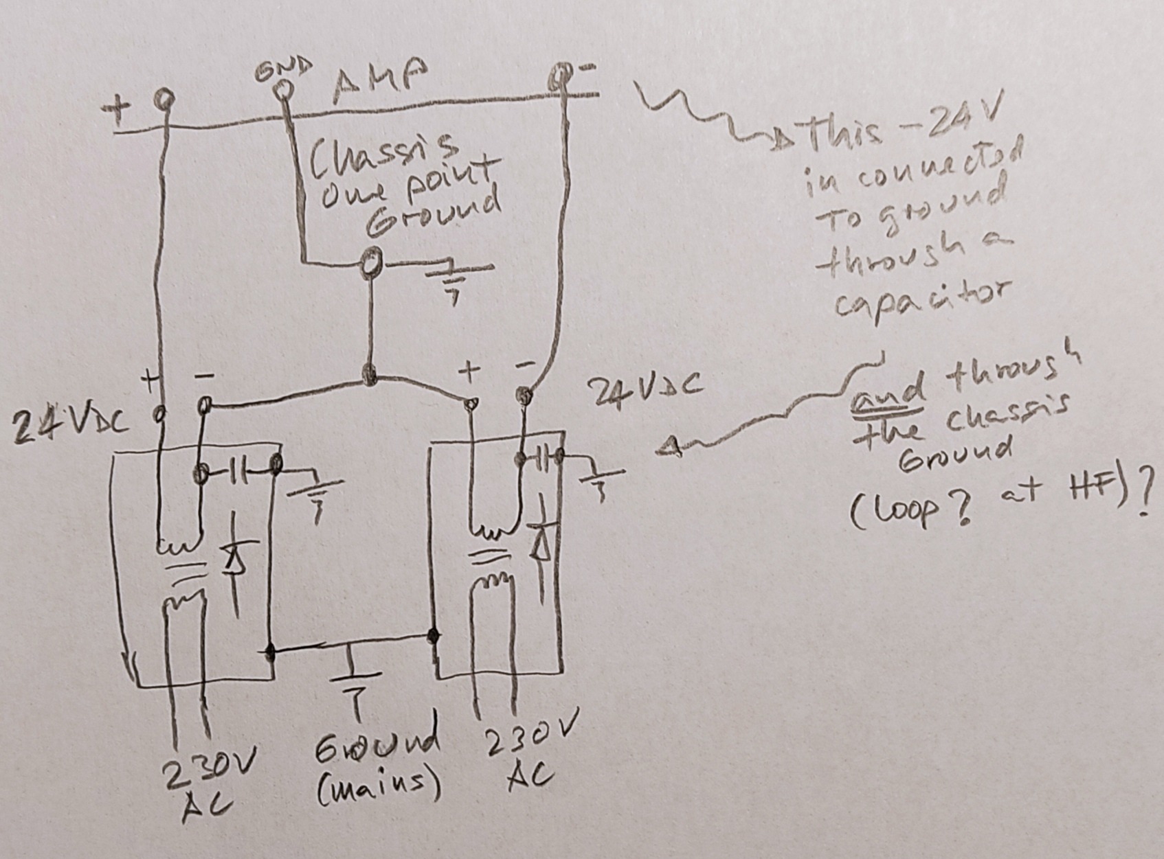

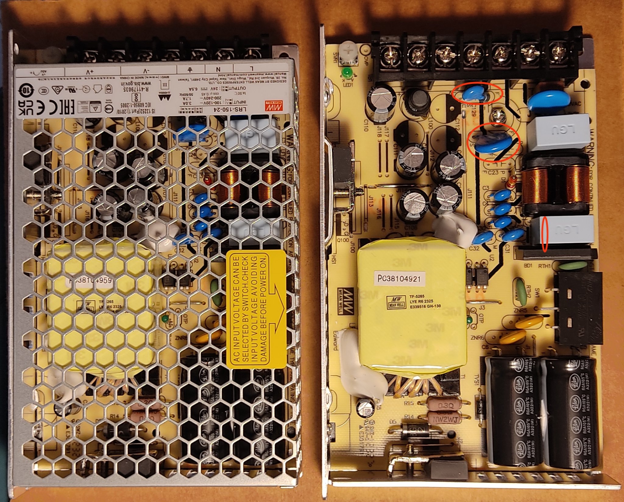

I'm making progress with my hand made pcb M2 (some pics below), hope to finish within January.
I decided to use switching power supply and bought two meanwell LRS-150-24 to make a series connection with center TAP to ground. First time I use switching PS.
But (there's always a but) despite 24V output Is galvanically isolated from the mains, I noticed (and confirmed) there are two ceramic capacitors between ground and negative output (marked in one pic below).
My plan Is to cut these two capacitors legs to avoid ground loops in the high frequency because I will make a one point star ground.
Some experience with this issue?
It is right to cut these two caps?
(I put capacitors between each +/- 24V to ground on the PCB to filter the power supply, 1000uF electrolytic bypassed with 0,22uF poly, at the bottom of one of the pics below, so not strictly necessary to have more capacitors in the ps)
Thanks again

I would not touch the ceramics. My guess it that they will not cause any troubles. At least wait until you experience a problem.
Consider having the meanwell's in its own chassis. I think this can give you more "silence". And then a couple of DC-filter chokes and large E-caps to filter out switching noise. This approach worked well for my Lazy Singing Bush mono blocks.

Hope the sketch here may explain my point better. I really don't know if some nF ceramic capacitors between negative output and ground could create a high frequency ground loop still audible.
In normal circumstances no, but with a center tap grounded maybe.
I'm planning to keep the meanwell enclosure and to put additional steel around to reduce possible interference.

OK, the SMPS's I used for the Lazy Singing Bush I needed -65V so I had a similar problem as the + was used as audio gnd.
A small capacitor and a resistor was implemented from - to gnd. The reason was to prevent to much static charge to the power transistors on the heatsink. So I guess it could be safe to remove the cap when the SMPS is installed and properly grounded. I removed the resistor as it would burn anyway as it would get 65V. They were smd so I removed them using a heatgun. From memory the cap was removed also as they were very close so the heatgun took them both.
I'm also using two Meanwell LRS-150-24 smps for my M2 clone and didn't have to make any modifications to the Meanwells. I don't hear a high frequency ground loop.My plan Is to cut these two capacitors legs to avoid ground loops in the high frequency because I will make a one point star ground.
You can read about my build in post #3526, #3531 & #3535.
