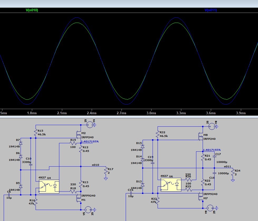

Adding two large capacitors at the output biasing resistor able to make the original M2 simulate significant better at low impedance loads...🤓
- Official M2 schematic
