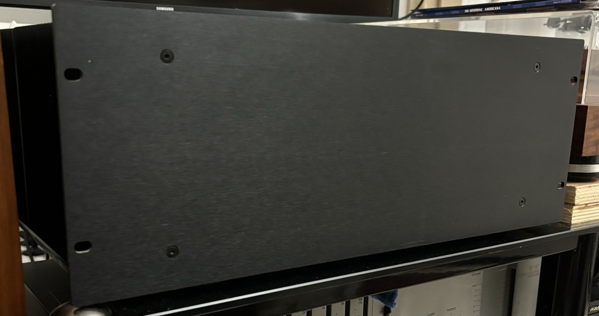

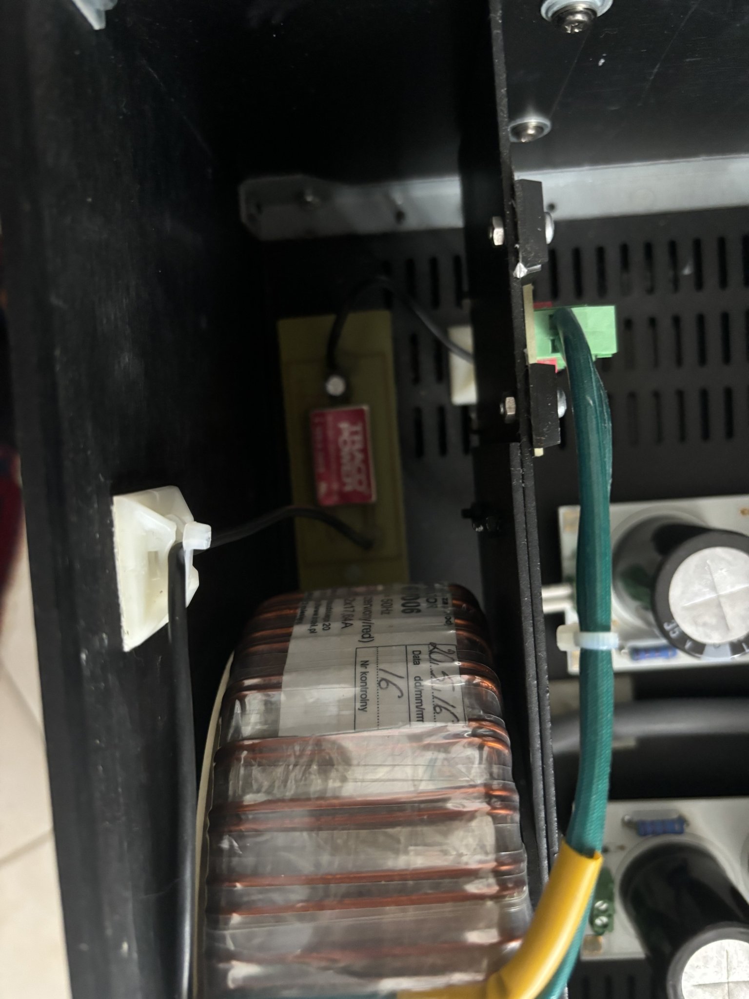

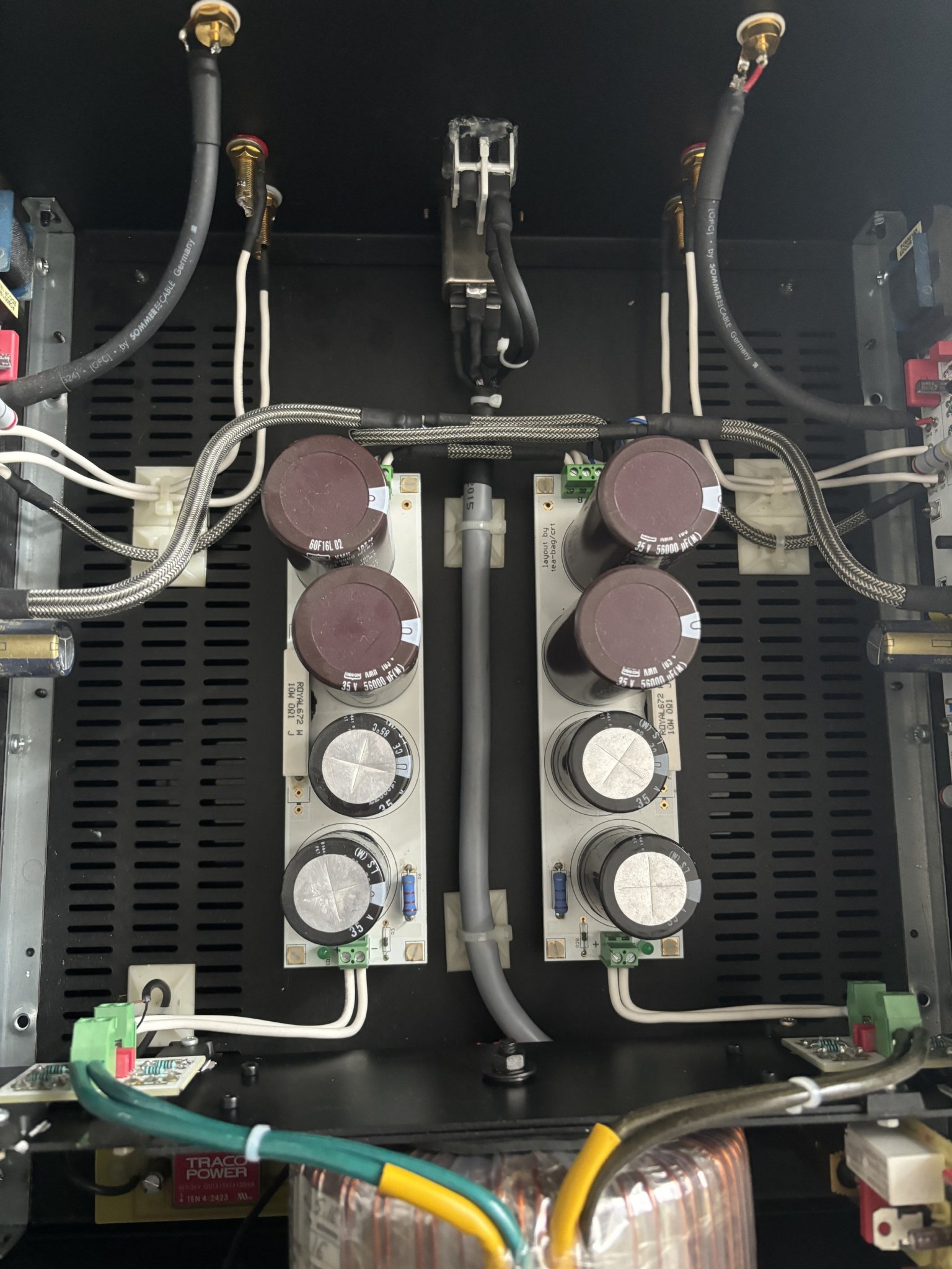

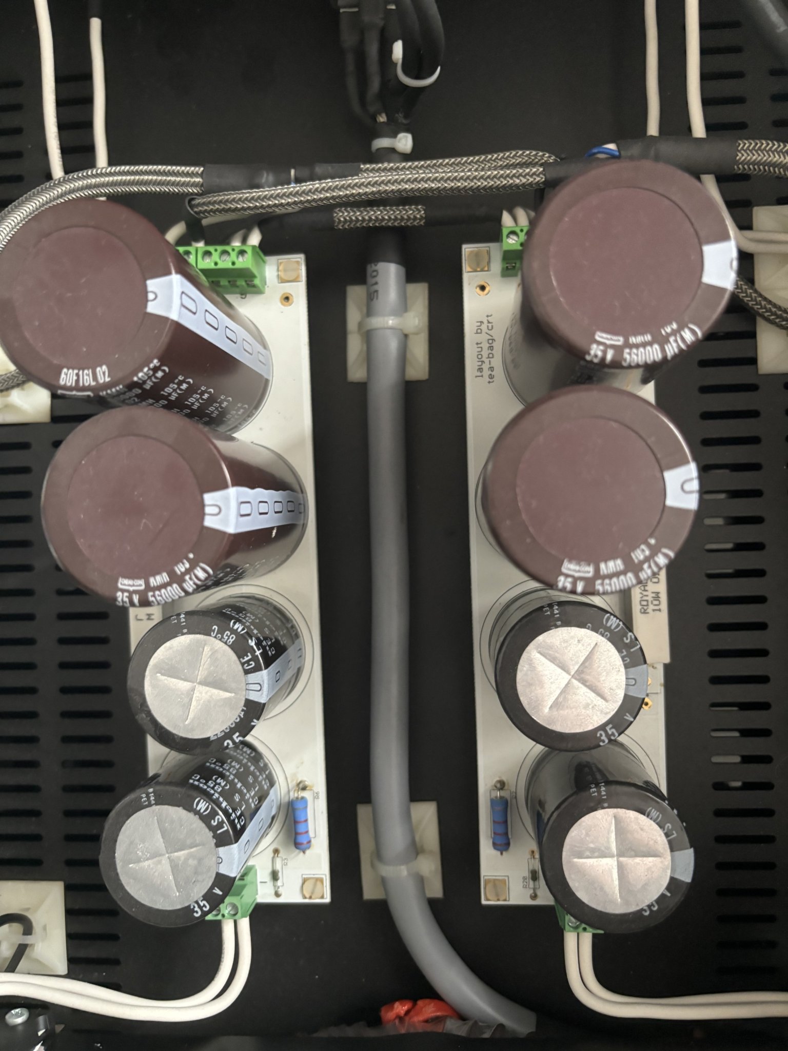

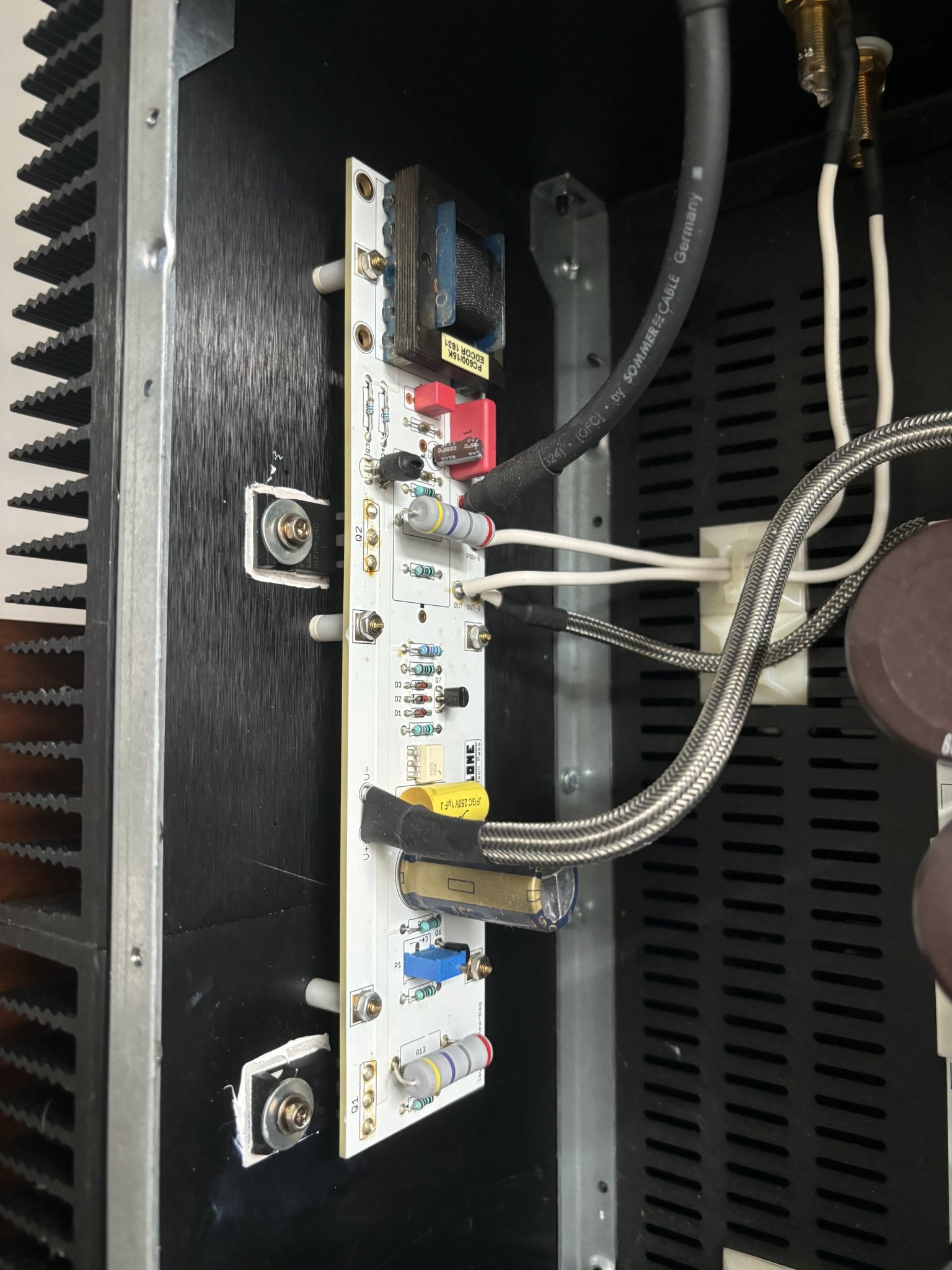

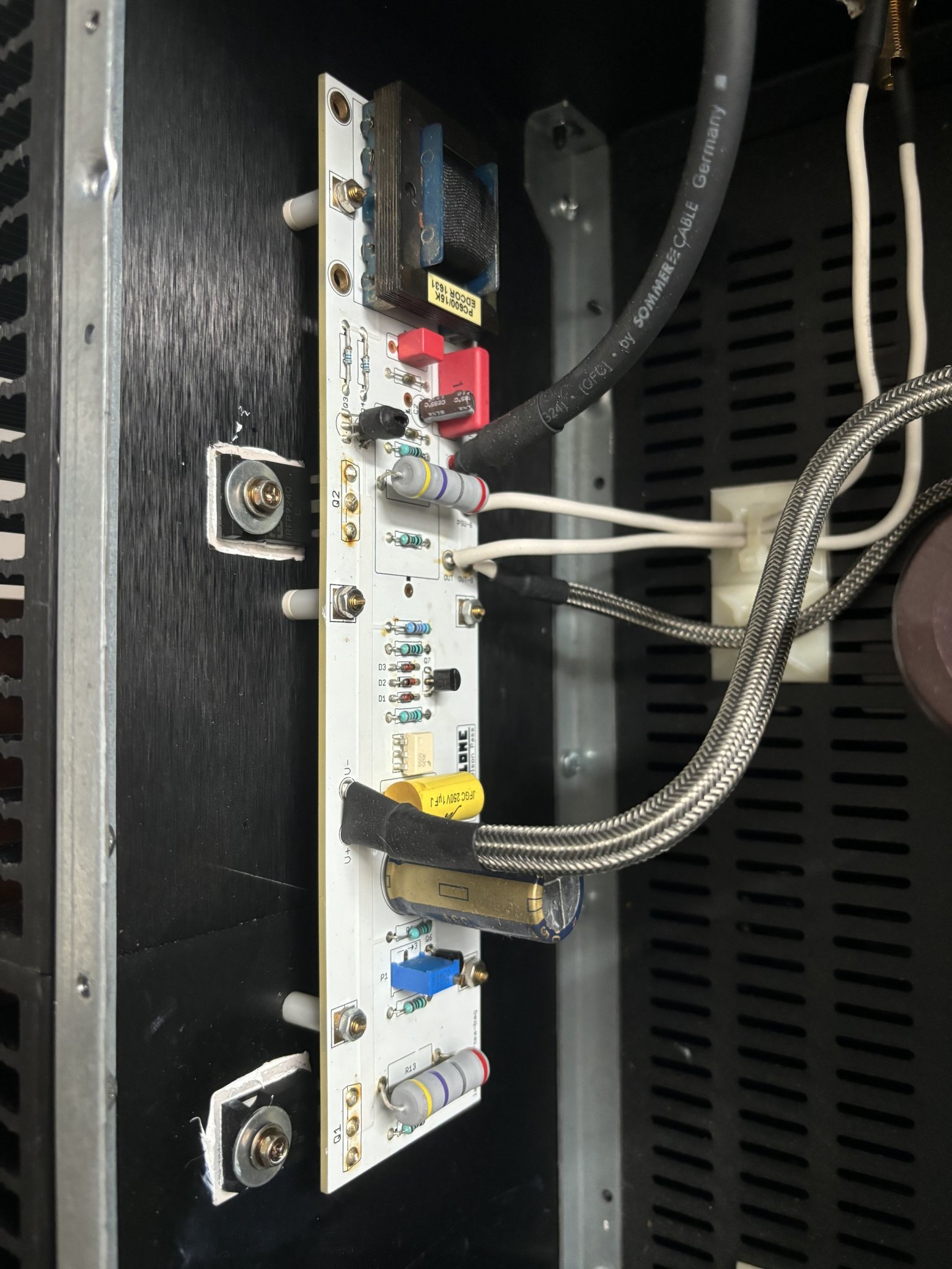

Well, it's kinda odd, not that I posted many interesting things on, the old forum but I don't even remember creating this account, though I can see why I did.
I remember talking on the Nakamichi PA-7 on the old forum on another account but not this one and I had to reread my own messages.

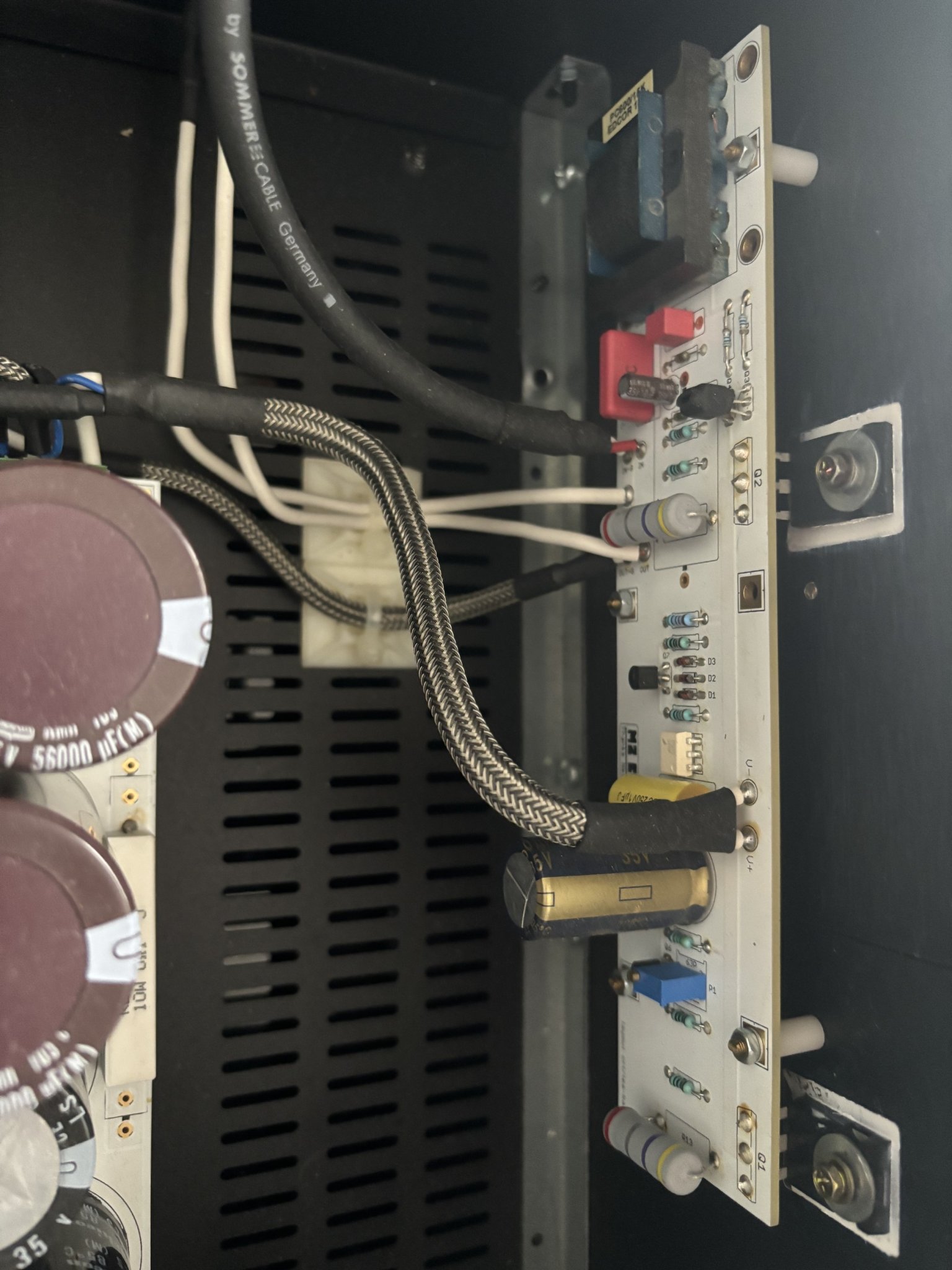

Anyway, I am in love with the M2 amp, I actually now own the M2 Tea-Bag pcb made by uchu007 years ago and I feel like I am kinda late to the party, I'll enjoy reading everything about this amp and all the topic page. I may fancy myself a M2X Mountain View one day since I quite like this amp but I feel like I'll try sooner or later to add some mu metal to shield it as everybody seems to have done it, funny thing is that maybe the room is quite cold but I don't feel it going that hot unless I crank more the volume pot (or it's taking its sweet swiss time to heat up).
Here are some pictures of it.
Maybe I should check also if screws didn't come lose over time.

Oh yeah, put it on, and enjoy it ! I think to have or make a preamp with no nfb to go with it. In the meantime, I am gonna read more the post about M2, I stopped where it was mentioning 3rd harmonics from the amp. I am used to very dynamic amps with precise and clear sound such as M-7050, M-L10. I gotta say this one doesn't hold back to them but it adds the last bits of realism I lacked for the full immersion. Or maybe it's because of the novelty, gotta listen more to it when possible.
Yeah, the Tea-Bag are clean boards, I wonder what the difference with a Mountain View would be. In any case, the clean build must help and big passive cooling, it's not as hot as I thought it would be, it's hot yes, but only if I hold my hands on the top of radiator. If I just touch the chassis or the side of radiator, it's way less hot.
It's really interesting. I'll see more tomorrow what some Tara labs free cd can bring and if they bring something to it but I do love this amp. It kinda makes me curious about the AX-25 as well.

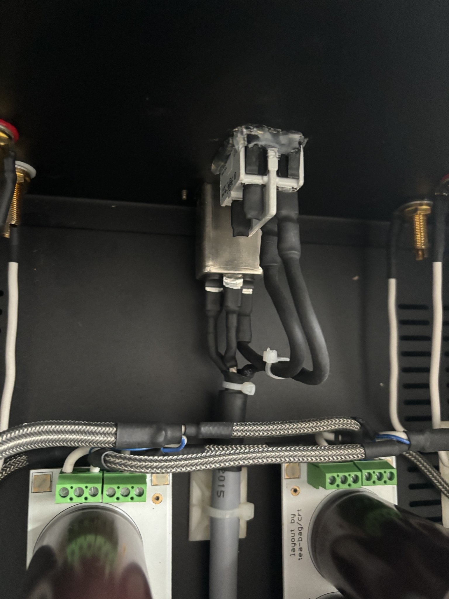

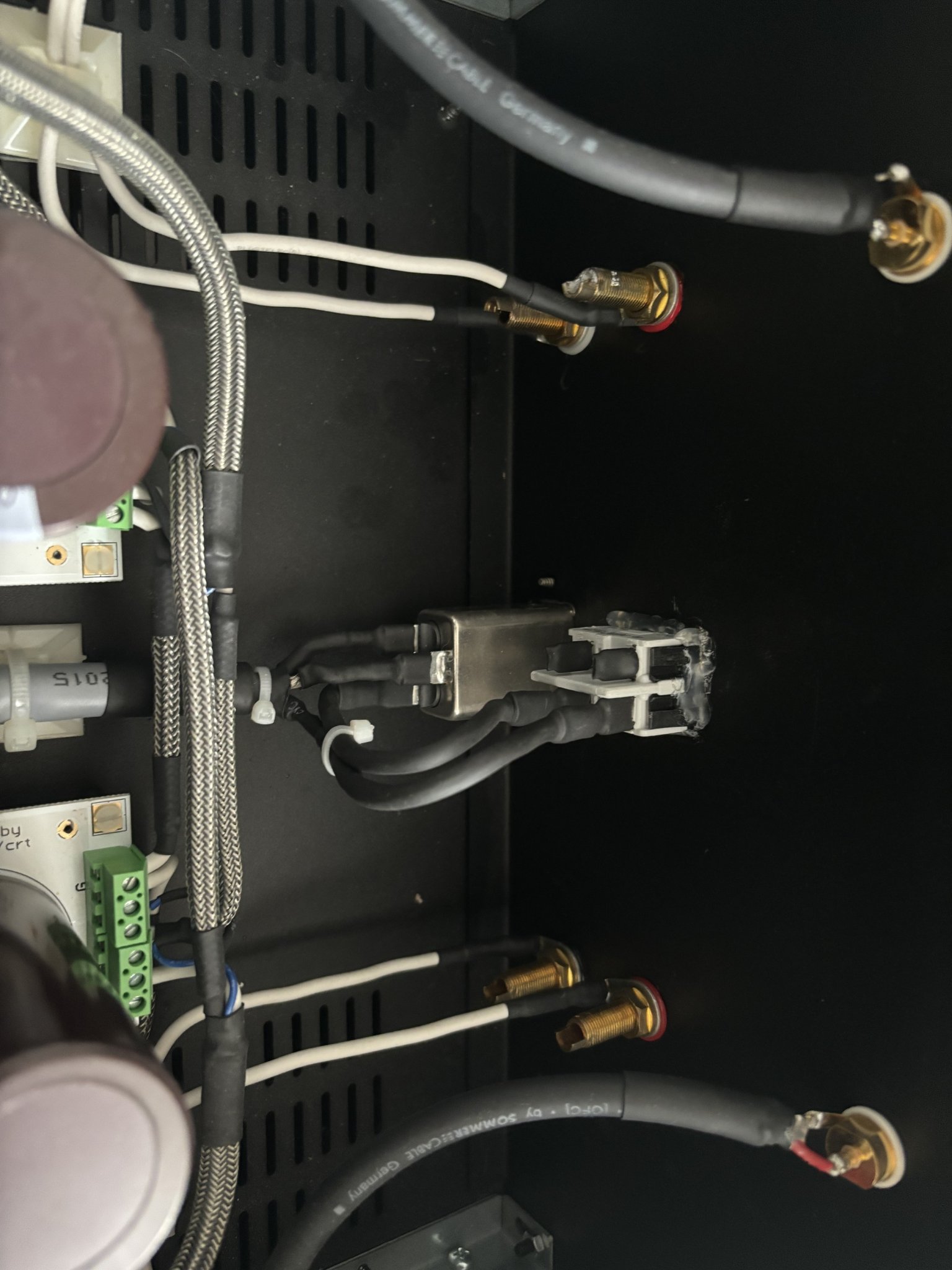

However, in this build, there are two circuits that the builder added and for which I have no idea what they do, I'll post more pics tomorrow while tightening every screws.
