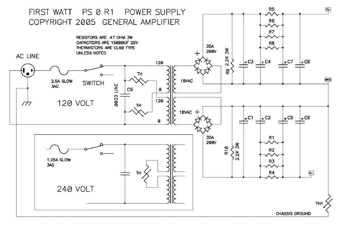

Official M2 schematic

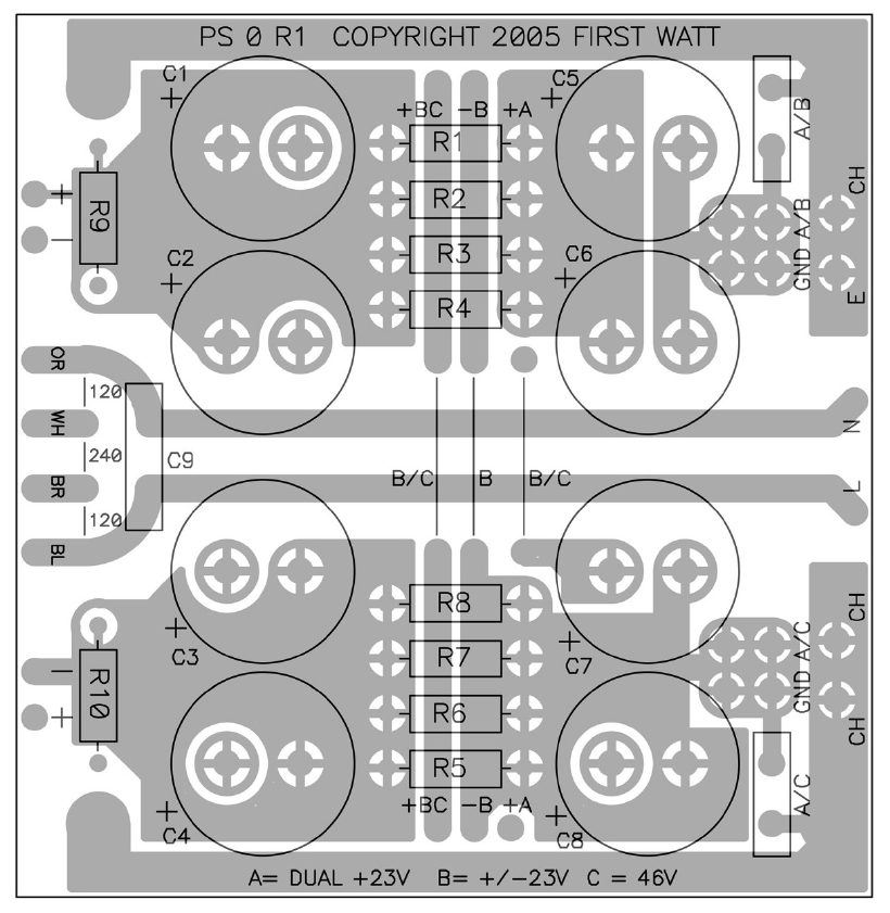

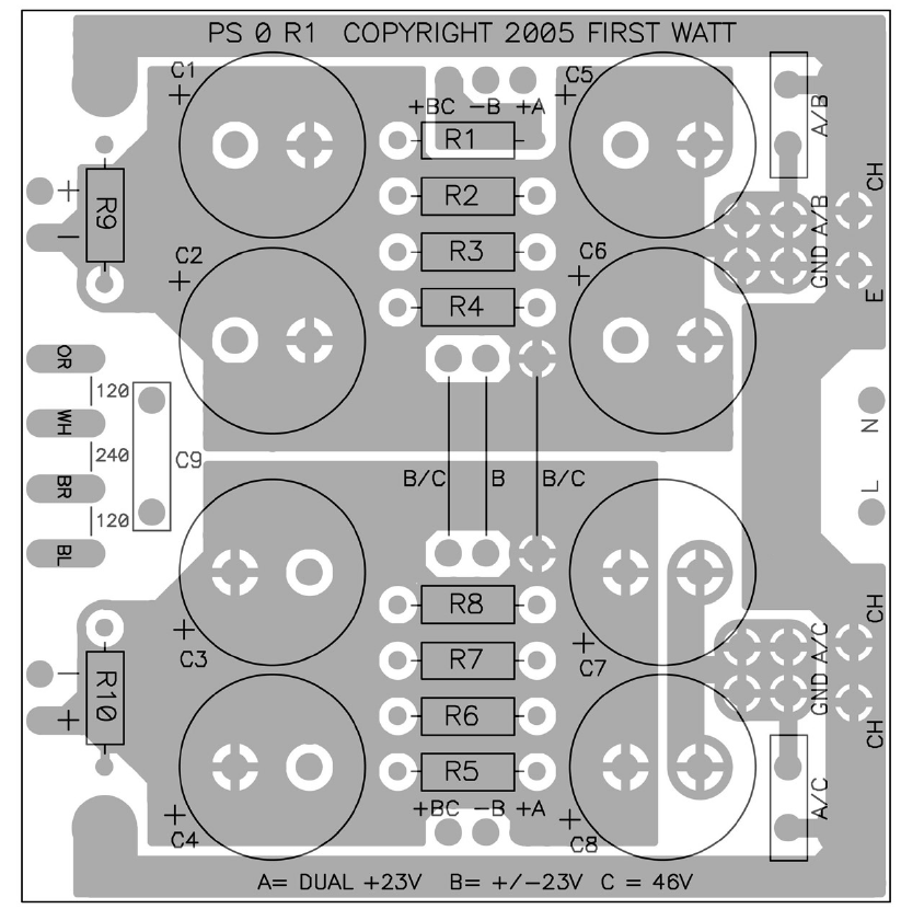

- It looks like the CRC board in many of the FW amps has a track for running 115/230V AC in the center of the board, with the PT primaries connected on the other side and space for thermistors. Also there are V+/-/gnd taps on either side of the board. It seems like a neat solution. I suppose one could do something similar with AC simply running the AC from the inlet between the caps (or under the base plate a la ZM), but has anyone implemented these features in a DIY-available CRC board?

The manual for one or another First Watt product, I forget which, includes these figures on the last few pages.

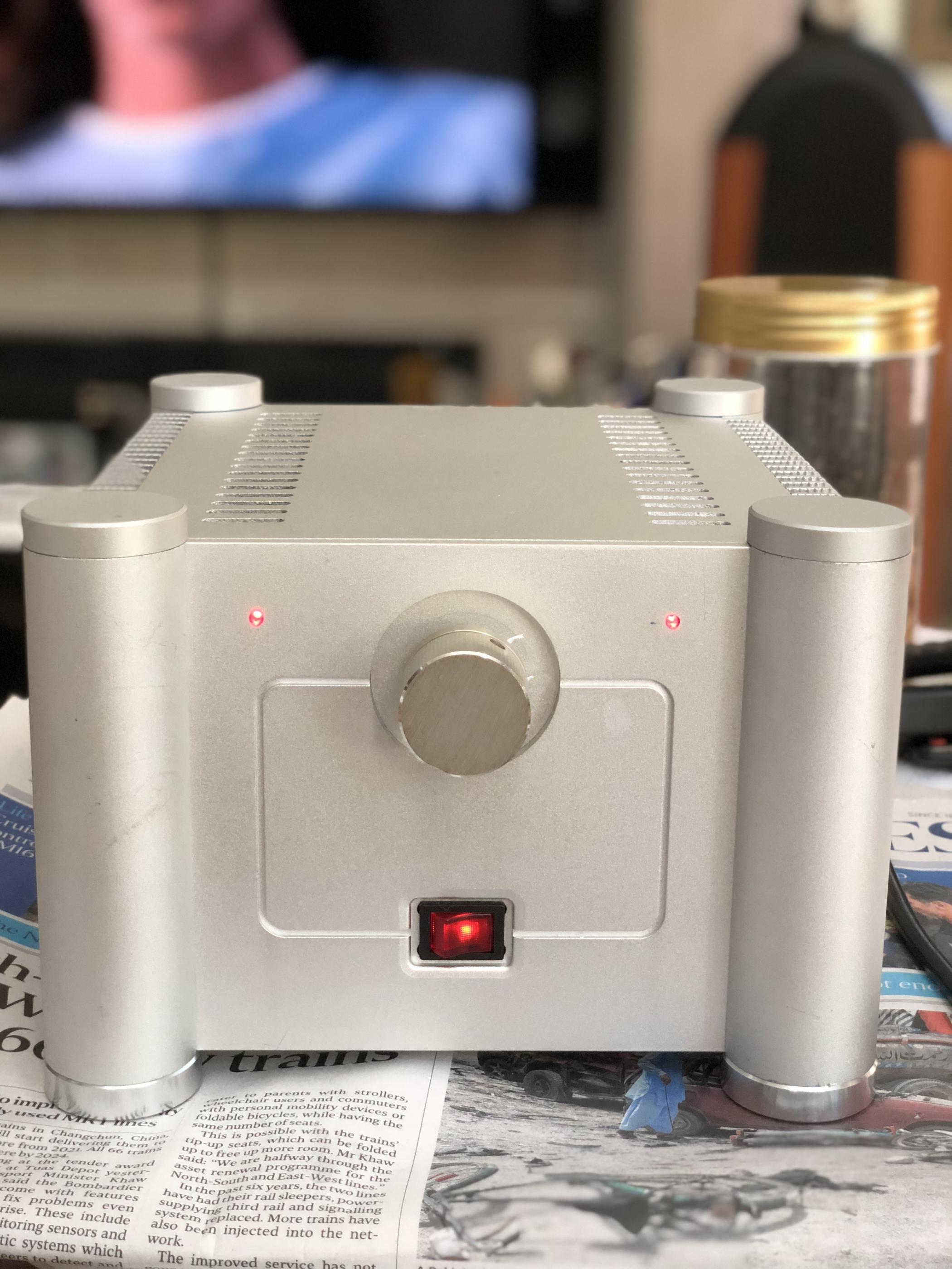

M2 Headphone Amp

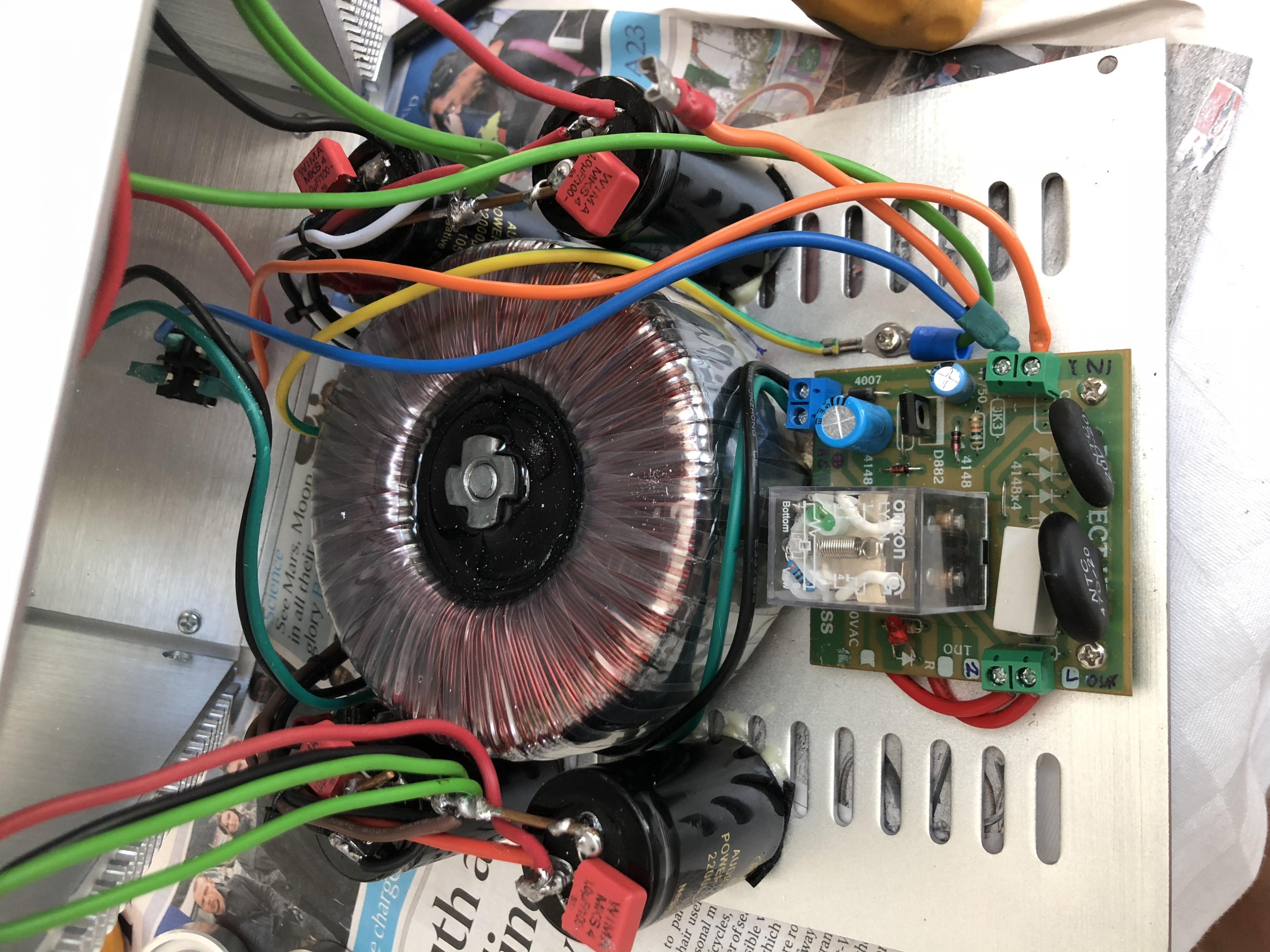

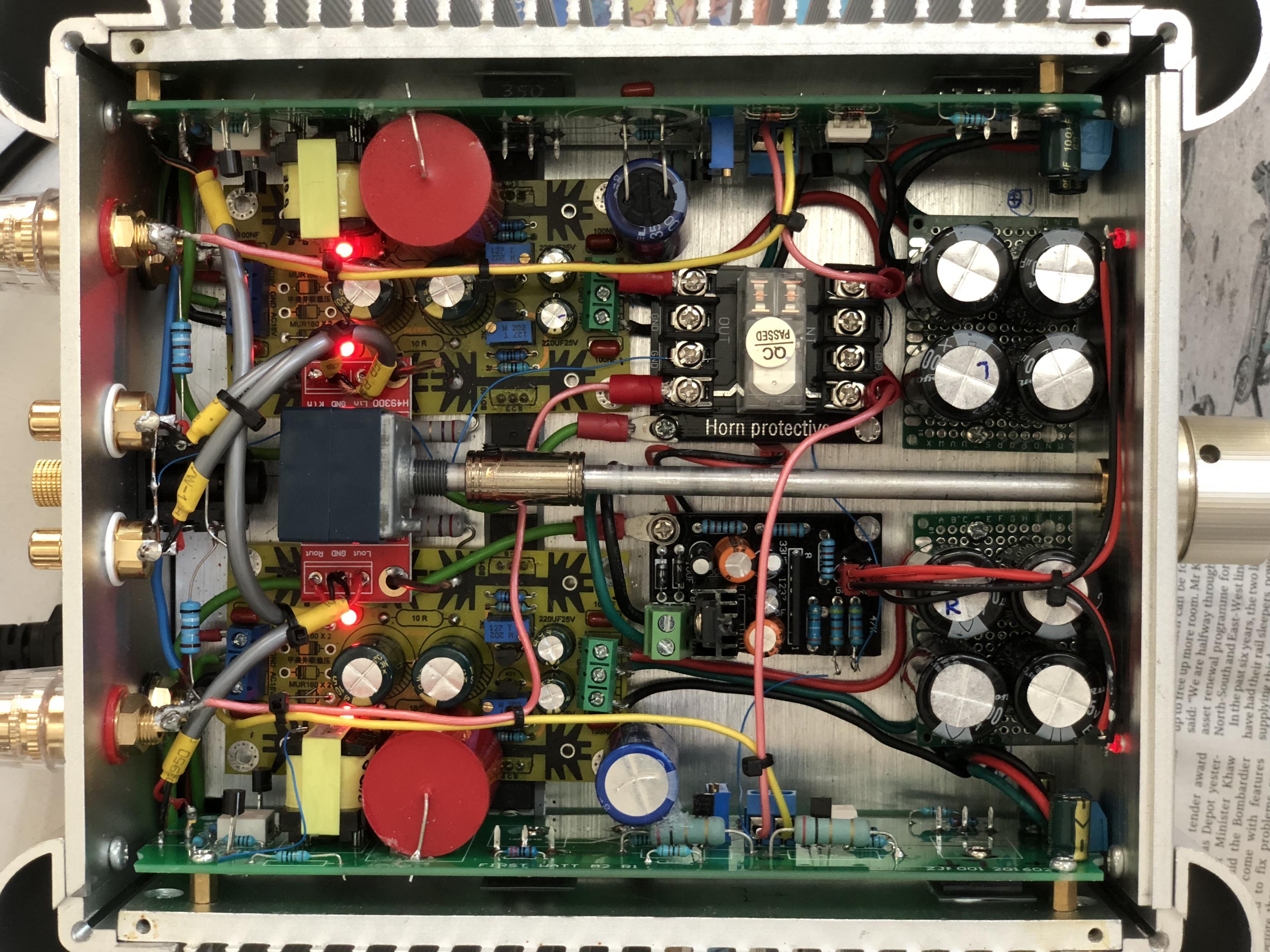

M2 headphone build. After getting very impressed with the the performance of the M2 amp I decided to build a headphone amp too. Used an oversized 300va transformer with separate windings for the left and right channels. Added voltage regulators too. Biased current was set at 300mA with +/- 22V rails.
M2 Headpone Pictures
The chassis has two compartments. The lower houses the transformer, bridge rectifiers, soft start modules and first filter capacitors. The upper compartment houses the amp boards, regulators, post regulators filter capacitors and headphone protection module.
