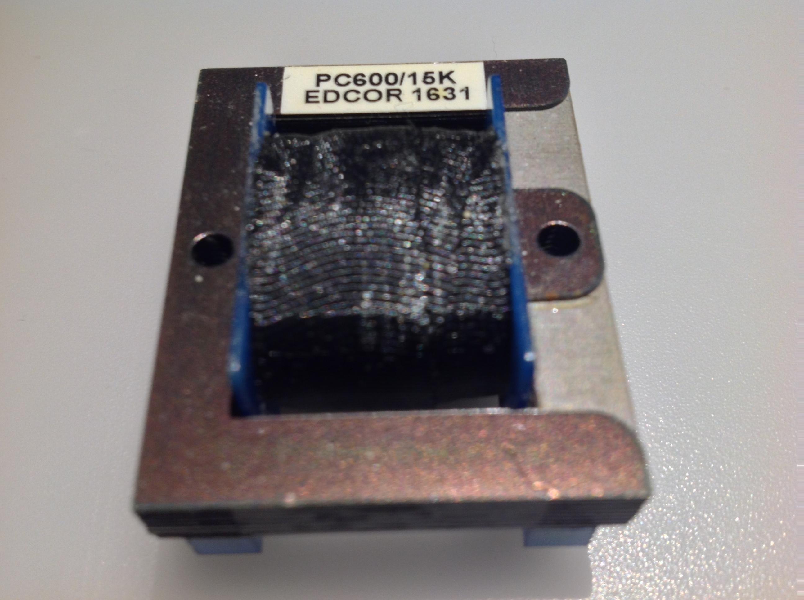

Hi I think I ordered 600:15K from Edcor but my invoice shows 15K:600, I havent got them yet. Are 15K:600 and 600:15k the same transformer or is there an issue with orientation in the 2M PCBs .. and as the Transformer will be connected as an Autofomer does that matter at all?
Best regards
Kjartan
Best regards
Kjartan

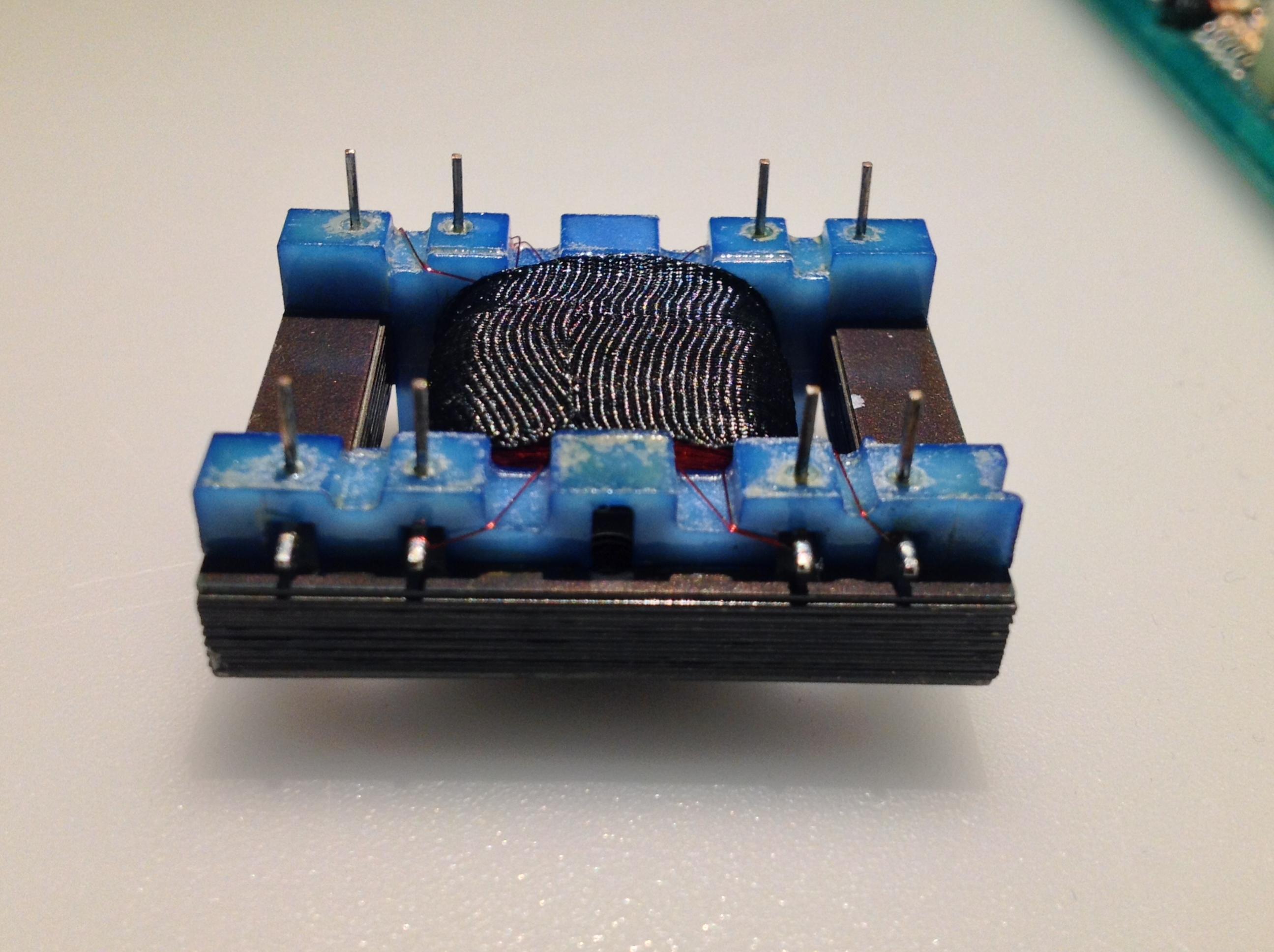

I believe pins 1 and 2 are closer together than the others - making it 'keyed'.
All you'd need is a hammer, or extend the leads.

My question regarding 600:15k vs 15k:600 if there was an orientation difference and if it mattered at all as the trafo is connected as an autoformer.

I find that the "600 ohm impedance" winding, has considerably lower DC resistance as measured by a low cost DMM. The "15K ohm impedance" winding, has considerably higher DC resistance as measured by a low cost DMM.
I think you could perform a couple of DC resistance measurements to find out whether you have a step-up or a step-down transformer.
I just checked at EDCOR - PC Series
on drop down menu , there indeed are separate 600:15K and 15K:600
you can only hope that difference is just swapped position of windings , Edcor having fixed arrangement of primary and secondary , so you can solve tgings with some creative wiring
once you get them , buzz , I'll give you Rdc and L data for 600:15K , to compare with
Those measurements are 42 and 230 ohms for 600 / 15k
Thanks mr Pass and ZM. I just got confirmed from Edcor support that they shipped 15k:600 to me and that I can do a 180 and use secondaries as primaries for 600:15k. I just need to wait for both the trafos and pcbs to arrive to see if they, because of possible pin spacing difference, can be fit into the pcbs in a resonably neat way.
