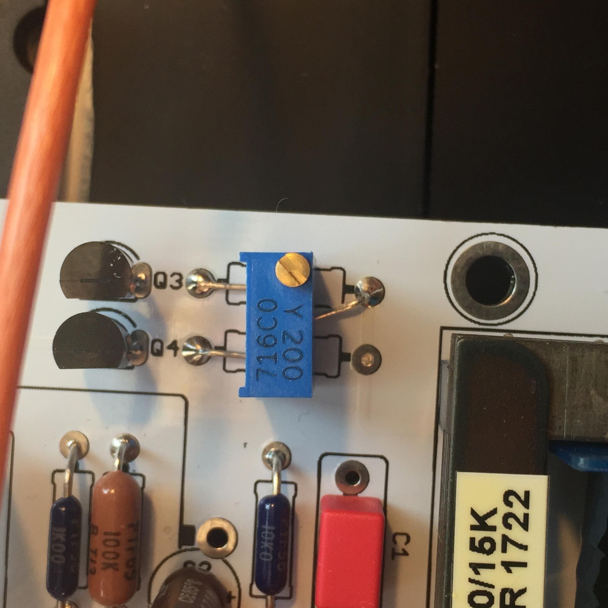

Latest hack: Bourns pot on R3/R4. Offset on Edgor back to 0mV
Interesting. Please explain how it's done.
20R0 linear Bourns pot instead of 2x 10R resistors. Leg 2 towards the Edcor.
Thanks, I can see that in the picture. I mean, how do you measure the offset on the transformer.
xformer input point red probe
gnd black probe
shoot for 0V ......... practically no more than 10mV in temp. equilibrium
gnd black probe
Thanks ZM. That seems easy enough.
I'm waiting for my boards, etc. from Teabag and I'll do this hack.
Btw, why should one aim for 0 offset?
When I measure the DC resistance of the Edcor primary, I get about 44 ohms. (average of two transformers)
If the DC offset voltage at the output of the 2xJFET input buffer circuit is 0.1 volts, that results in a DC current of 2.3 milliamps flowing in the primary. {Ohm's Law: I=V/R} I don't know about you but I don't want 2.3mA DC, flowing in the primary.
