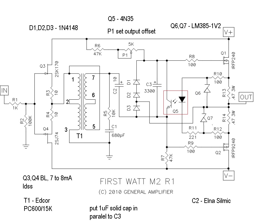

I have a couple questions
First I plan to use Toshiba power mosfet I have a matched pair purchased them a few years a go, I do not see any other project to keep them in my box. I know here I would not need a matched quad mosfet.
1) Should I adjust any component value or I can use these schematics how it is? I would like to a full advantage (if there is any)at the Toshiba mosfet.
2) The 3300uF should be 35V or 25V enough? I ask because of the size of the capacitor. I will use 20-0-20 VAC transformer.
Thank you very much!
Greetings

1.pretty much as is ; read notes about offset and resistor corrections
2. 16V cap is enough

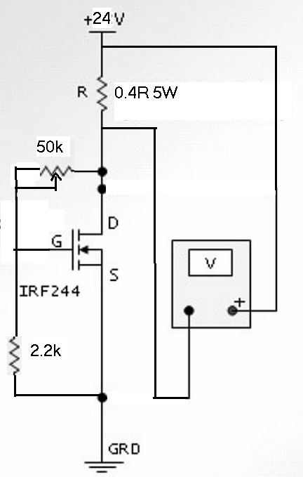

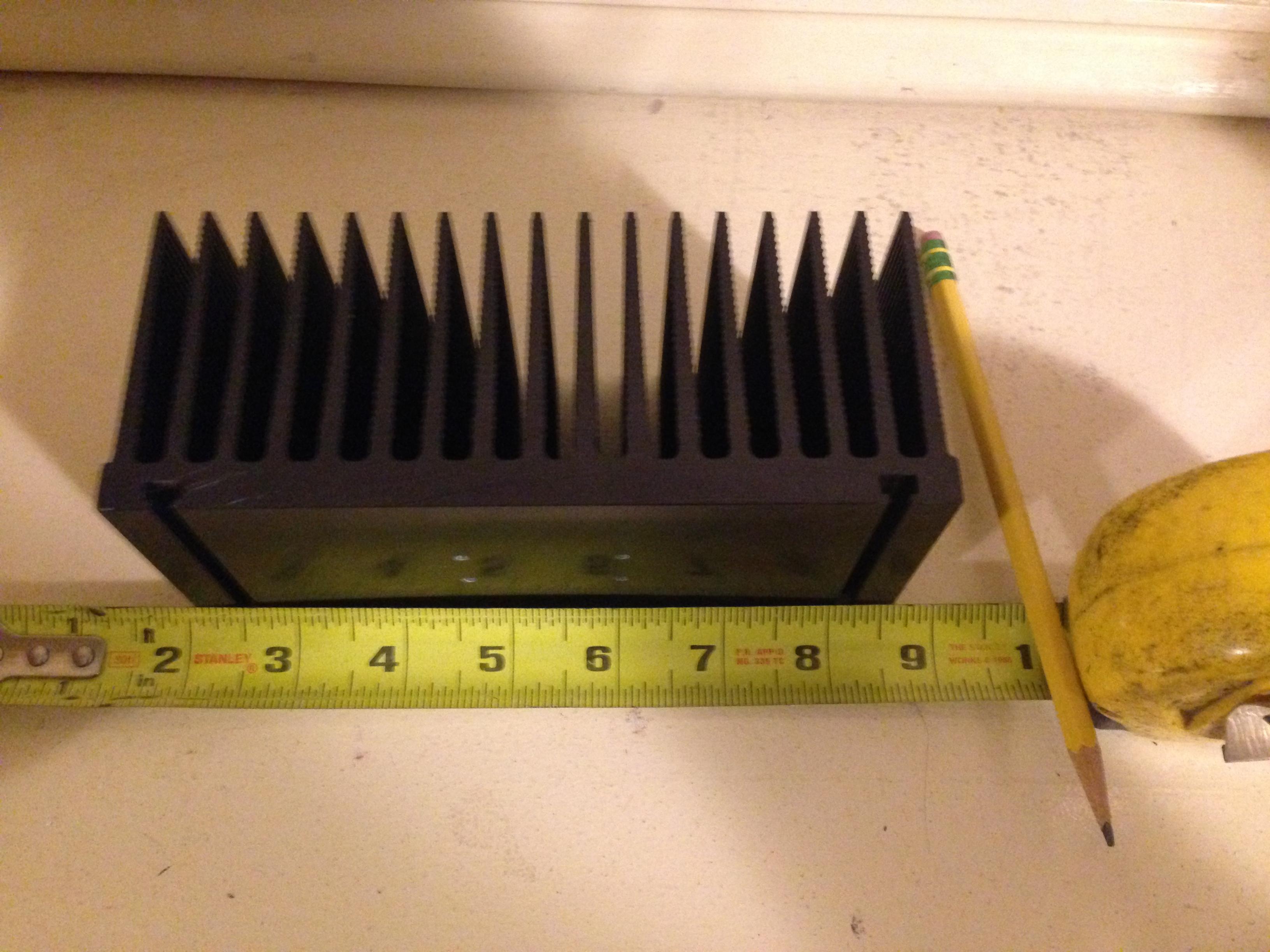

I'm building a + / - 24v 'universal First Watt' PSU in a separate chassis.
Except for the reason of heat dissipation, My amps can be rather small, at least smaller than usual.
I had in mind to use four of these smaller sinks for an M2. I was a bit worried if they would do the job... borderline maybe. I did some calculations, but didn't trust it much.
I decided to clamp an IRFP140 to it. I biased it up using a 24V supply, .4R source resistor, and a pot to adjust the bias. Running at 1.8A (0.6A excess over M2 bias for safety margin) I could only get the sink to 50c after several hours. I could top 60c with over 2A bias. This is in a 'room temperature' room.
I can be reasonably sure that these sinks are good for the application. I'm thinking that this is the best way to truly evaluate heatsinks with unknown (or even known) specs.
