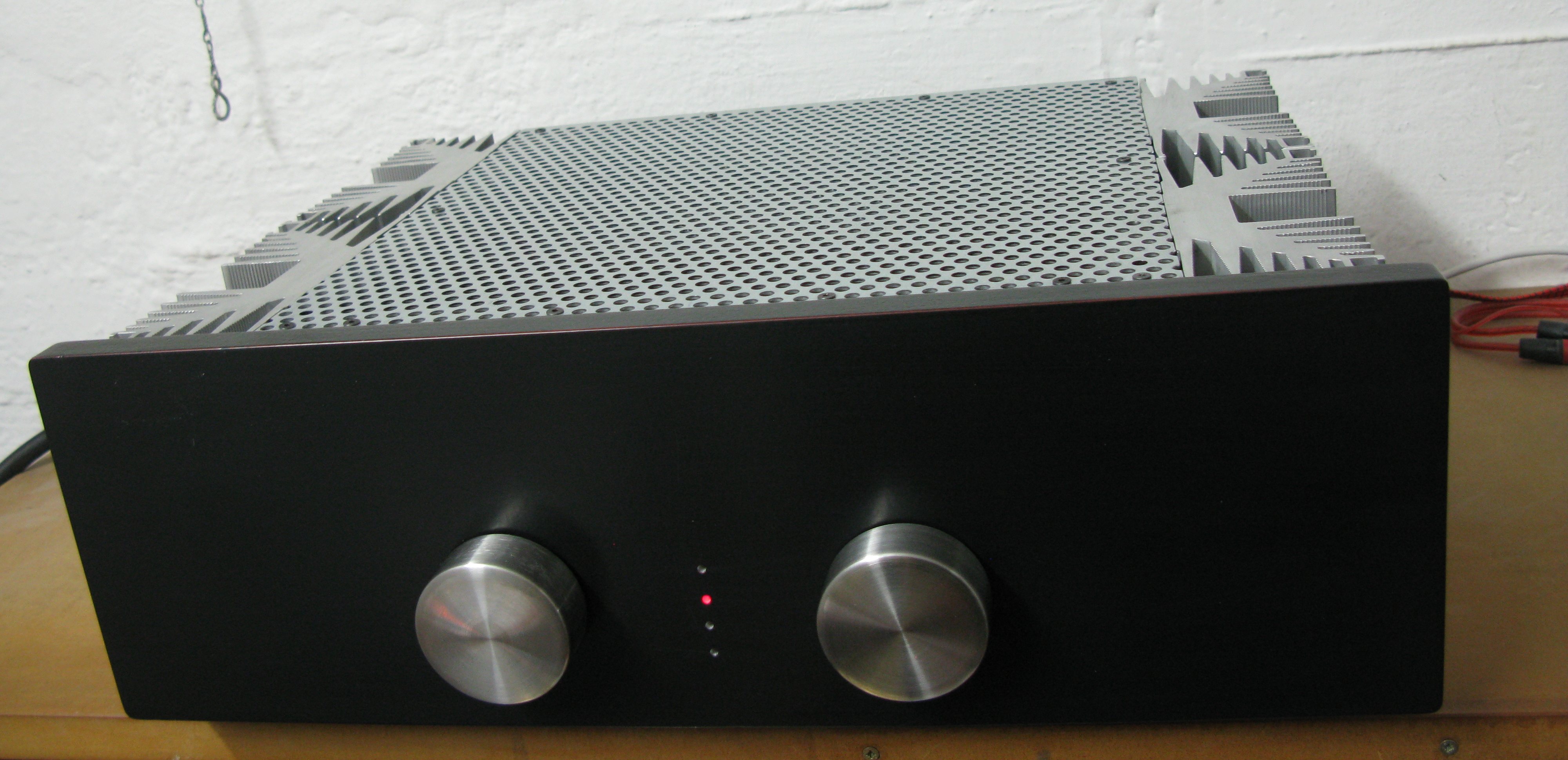

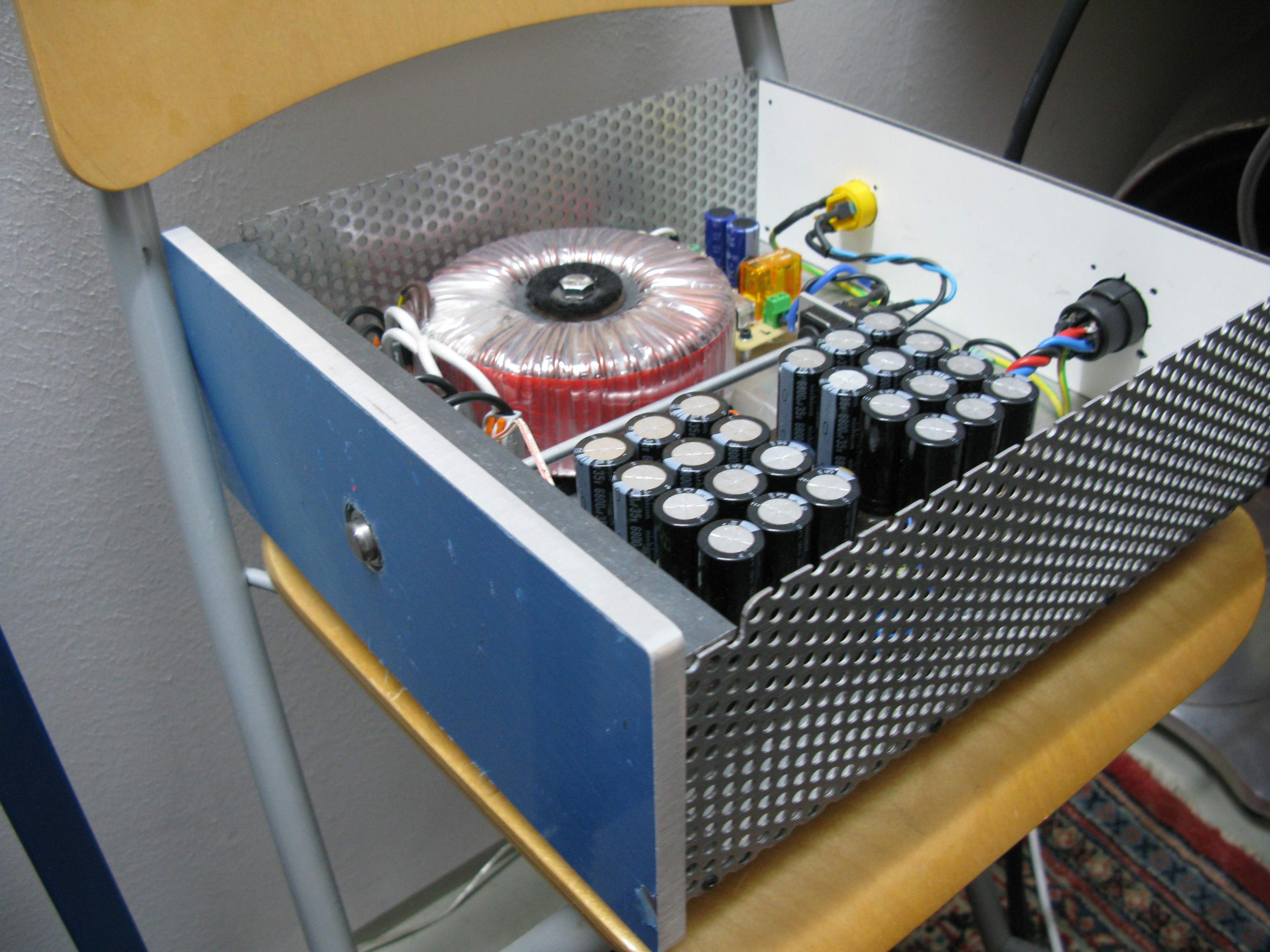

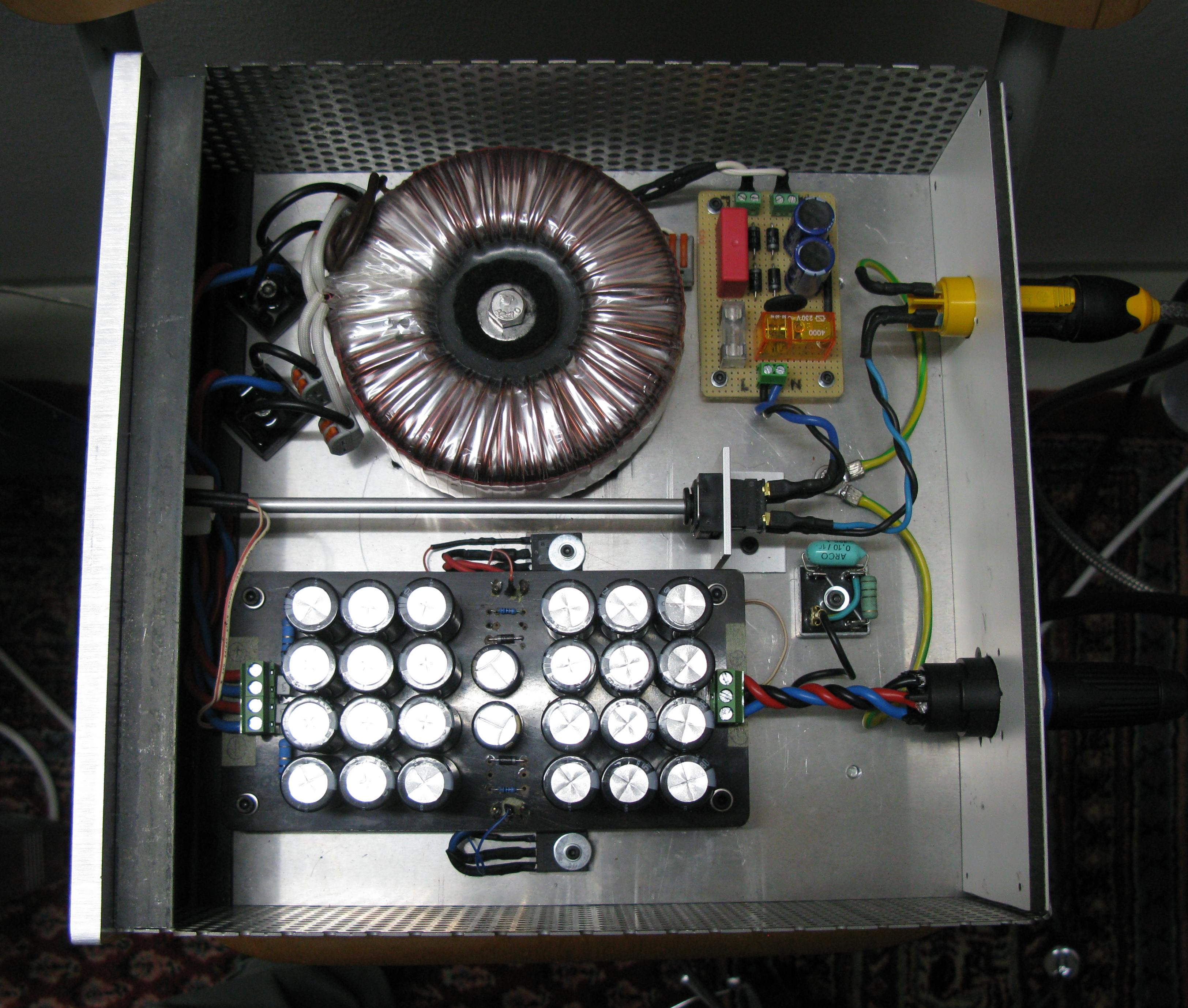

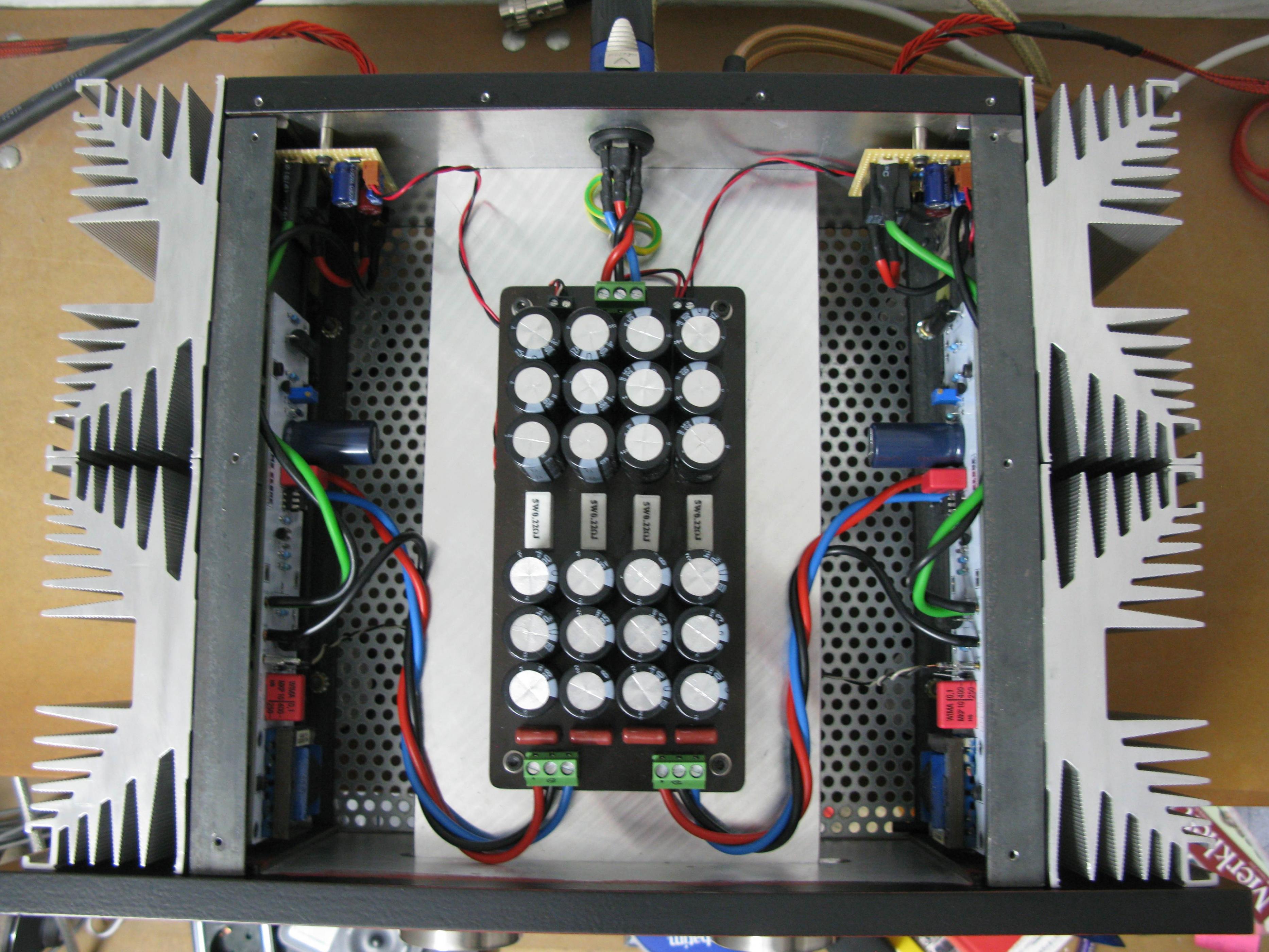

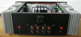

Sooo...finally...
my new M2 (thank you teabag) with external psu and internal selector and (secret-)preamp.
as always with a selfmade housing made from 2.hand heatsinks and alutrash.
doorknobs for volume and input selection.
500VA toroid with 2x22Vac, 2x 35A/400V bridges, 48x 6800µF/35V/105° nichicons
in C-reg-C-C-R-C mode.
matched LSJ74/LSK170 from the store and FQA12P20/19N20.
no hiss, no humm, dead silent at full power.
zero offset and very low ripple.
makes a wonderful soundstage and lively imaging.
much more than i expected.
thanks to everyone at diyaudio, Nelson Pass, and ZenMod for promoting the M2-circuit.
