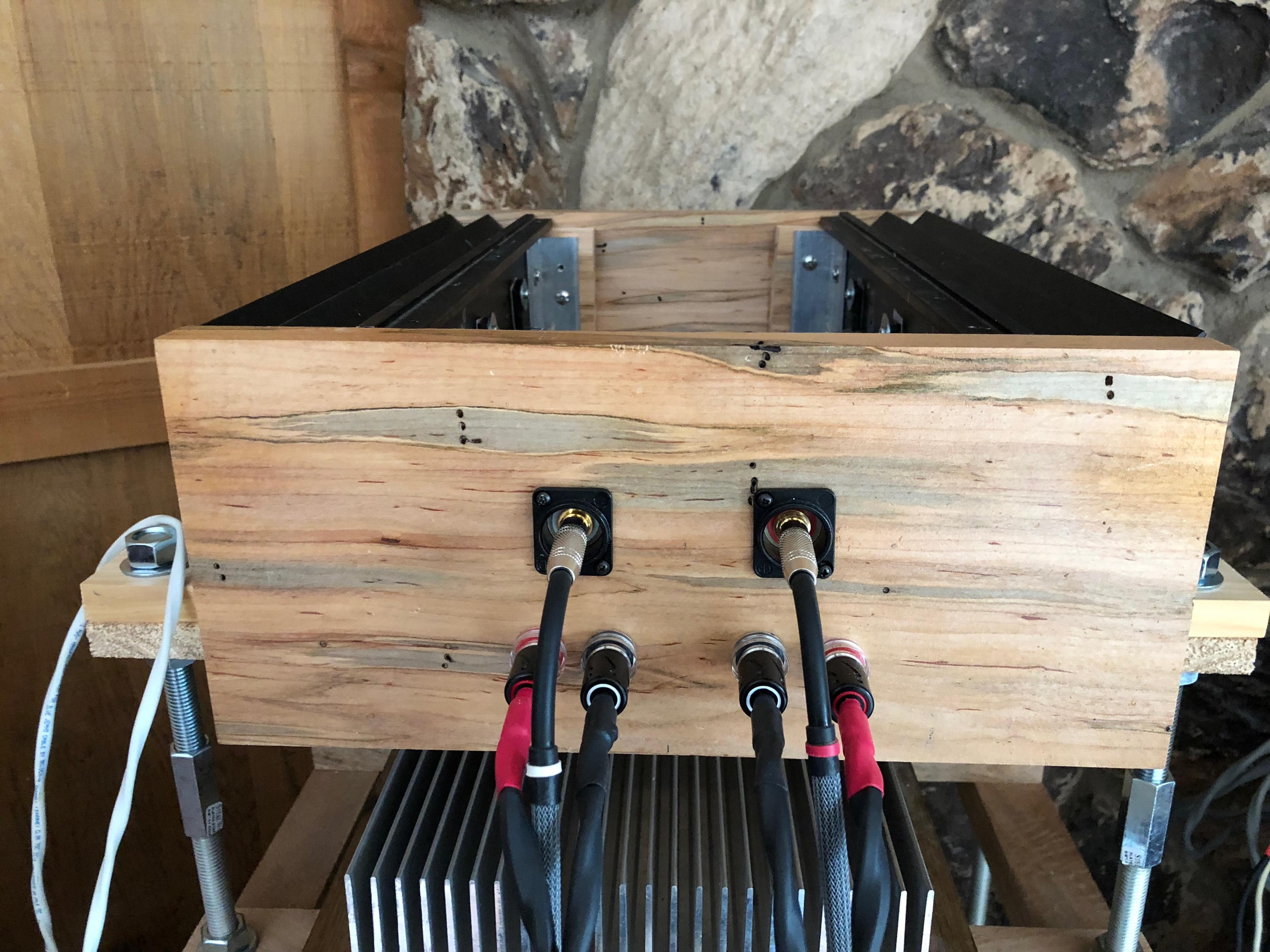

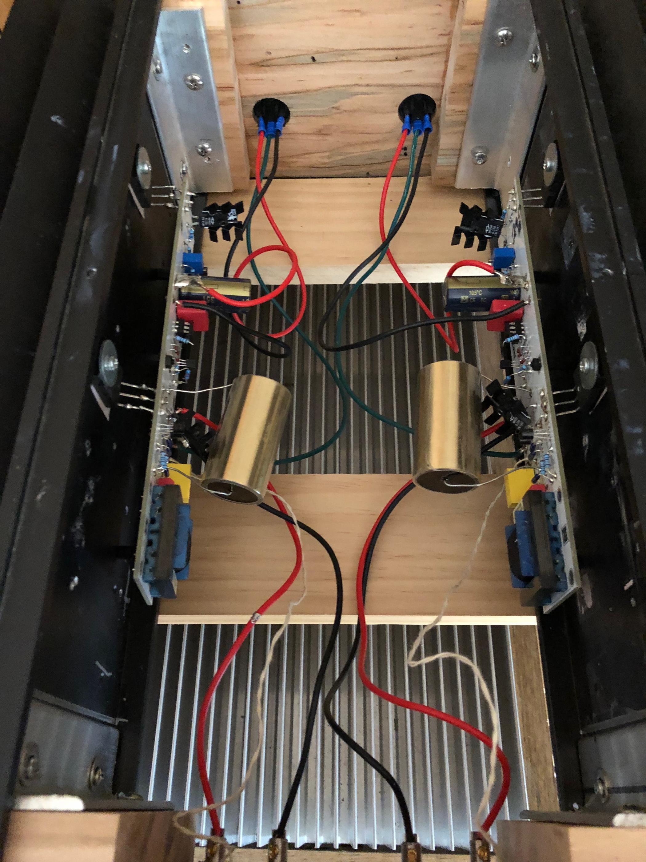

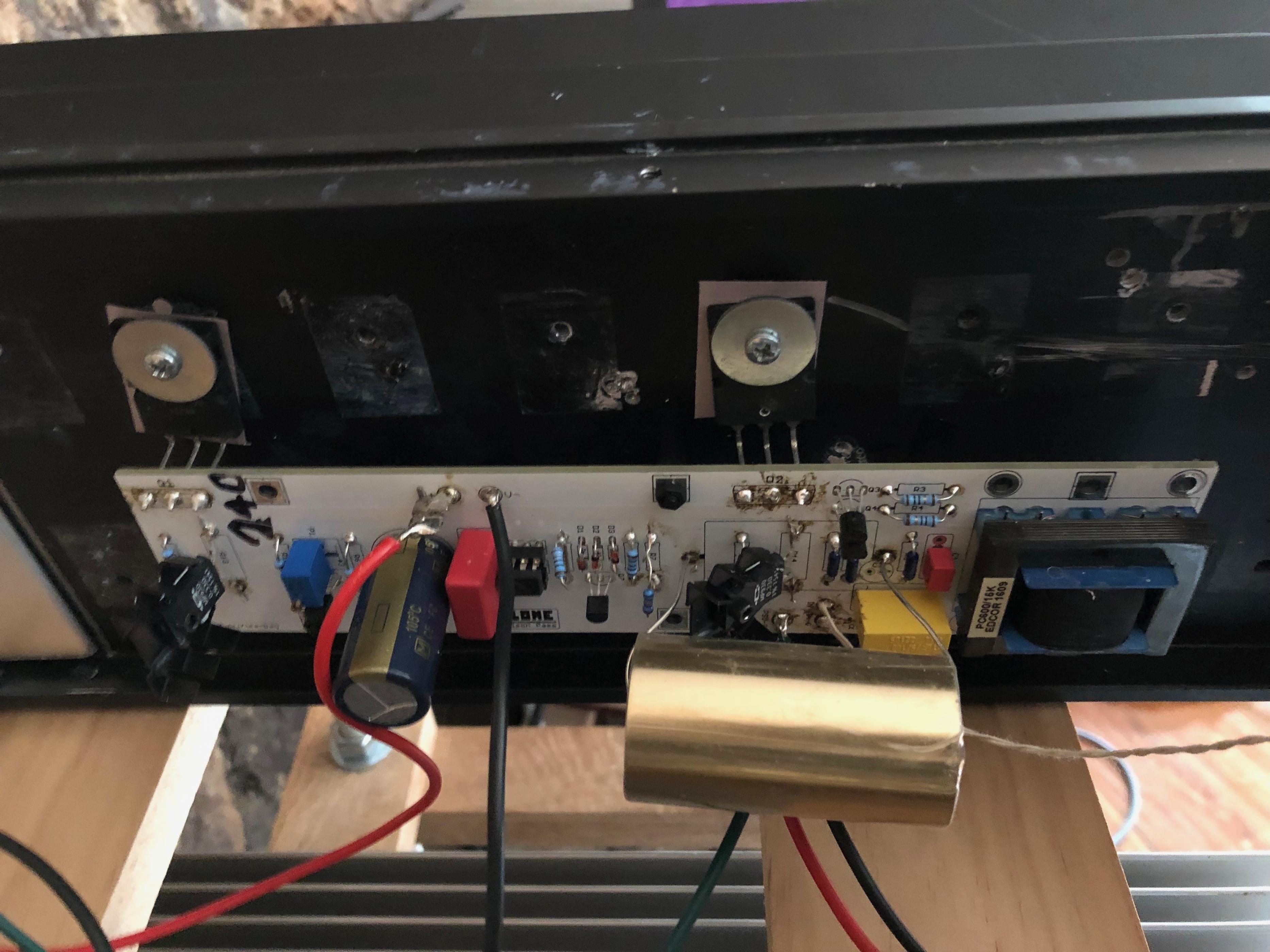

Completed my M2 changeover
Added Toshiba 2SK1530 / 2SJ201, reduced source resistors to .33 ohms and 0 ohms at R11. Using Tea Bag boards
Power by umbilical cord.
Nice involving sound with wide and deep soundstage. Great detail without fatigue
Highly recommended.
Best
Bob
Highly recommended.
Best
Bob
+1 for the same combination. :yes: :D
In my case built on JPS64 boards, with PSU in the same box, and I have a WIMA MKP10 for C2 and Elna Silmic II 3300 µF for C3 (bypassed by 1 µF MKC ERO1860).
My M2 runs with Iq of 1.81 A (Rails at +/- 24V).
Best regards,
Claas
