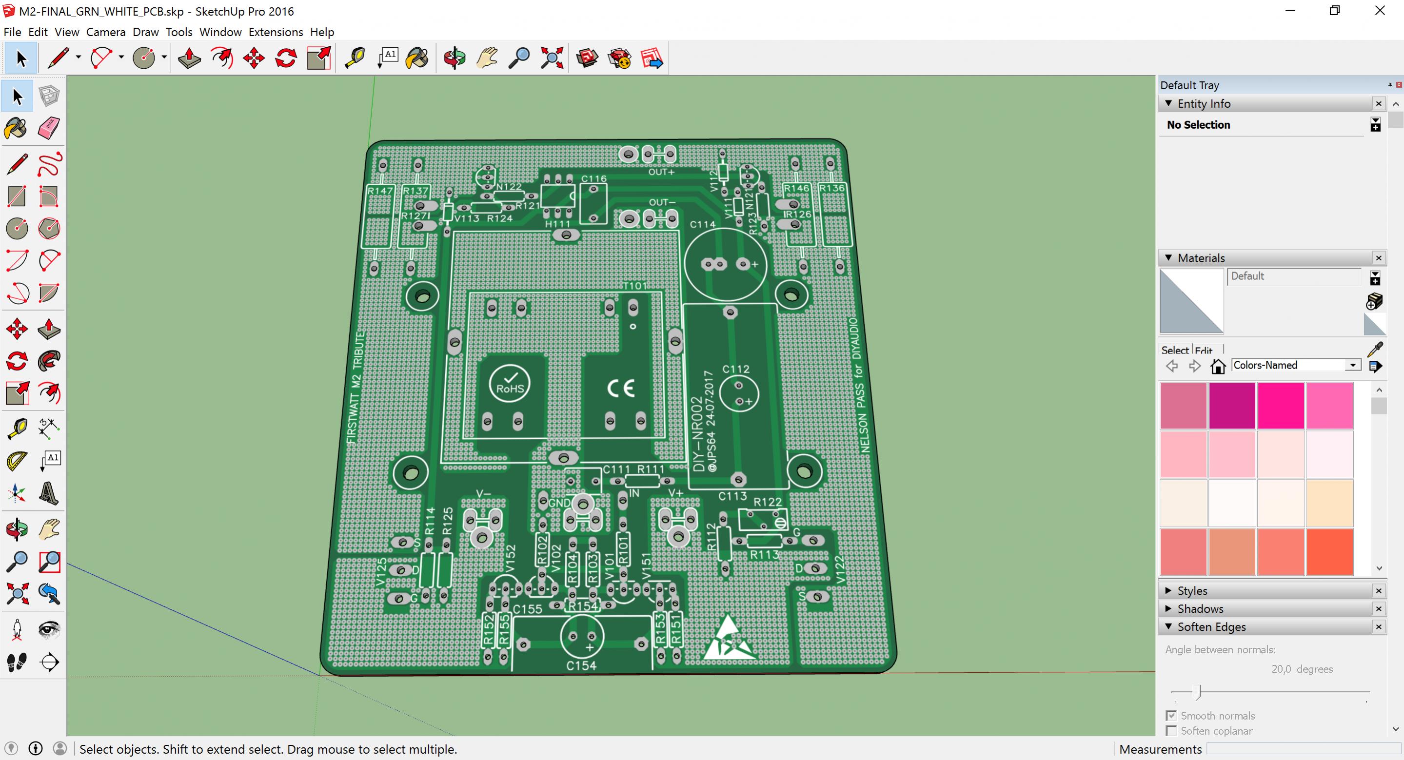

Standard (THT) PASS M2 printed circuit board.
110x120x2mm; 70µm; HAL; top silk; green --> 15 pairs batch = 12€ without postage

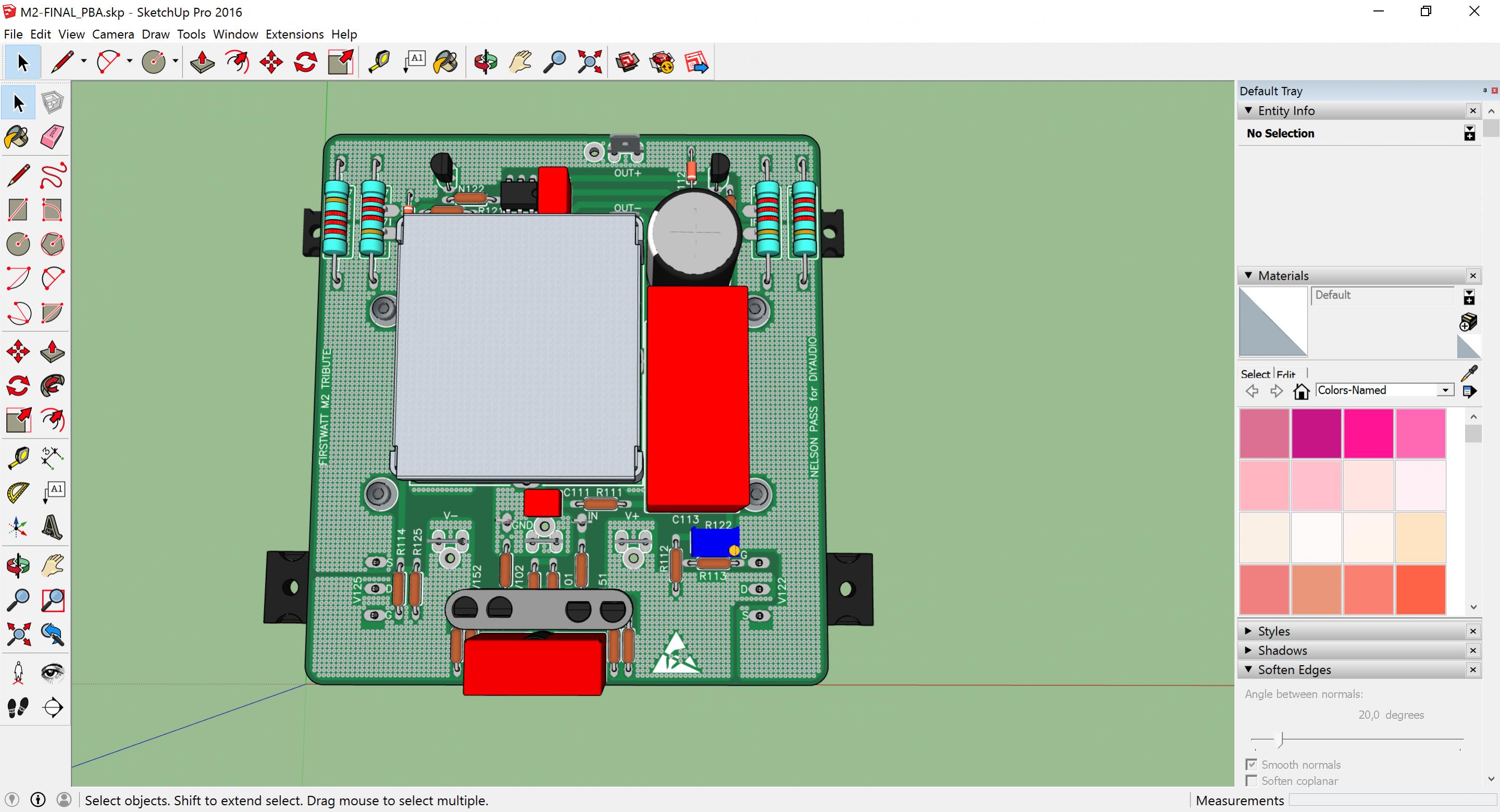

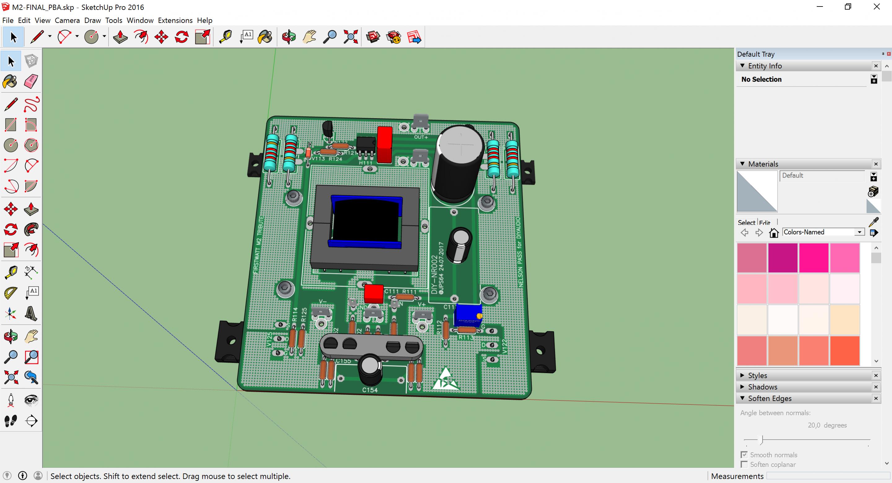

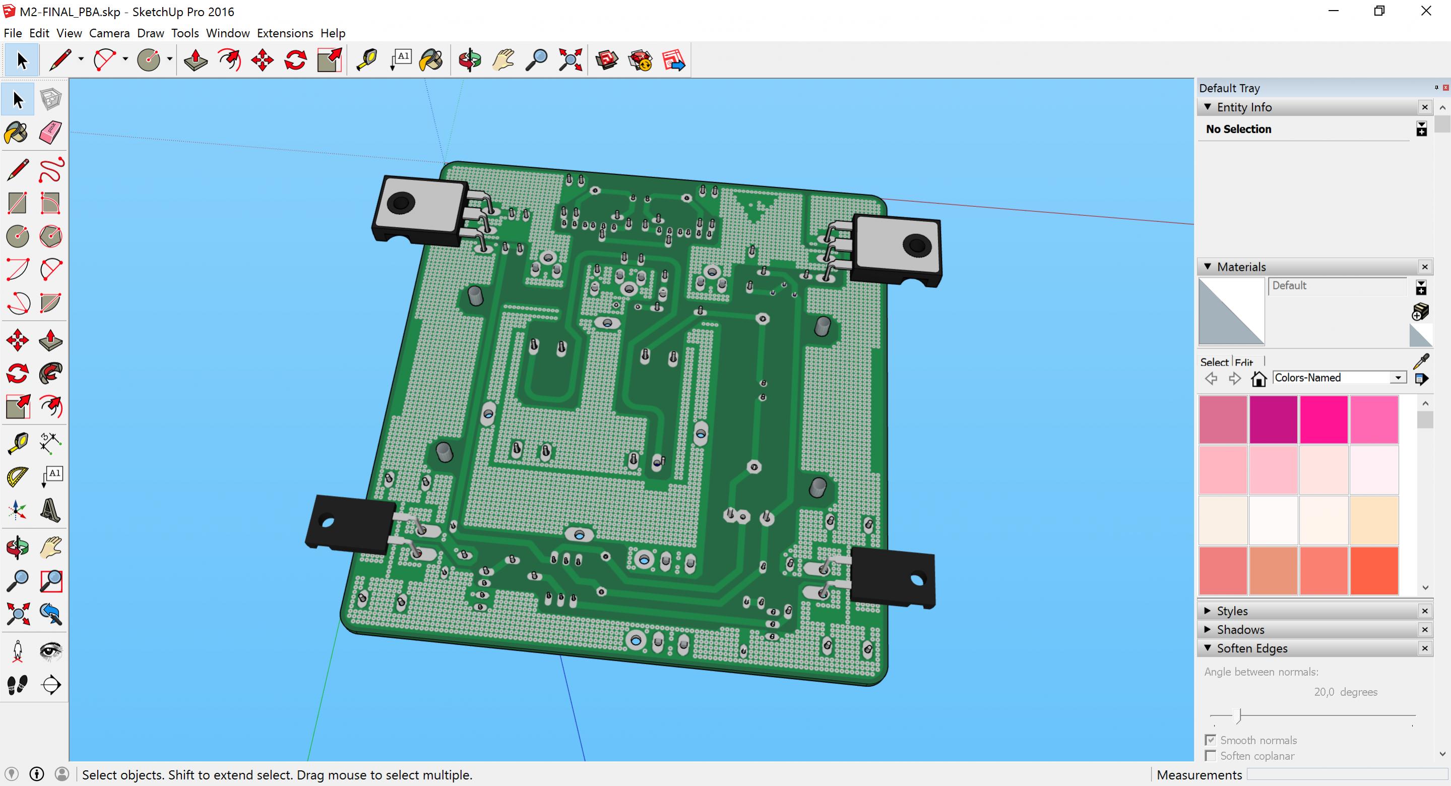

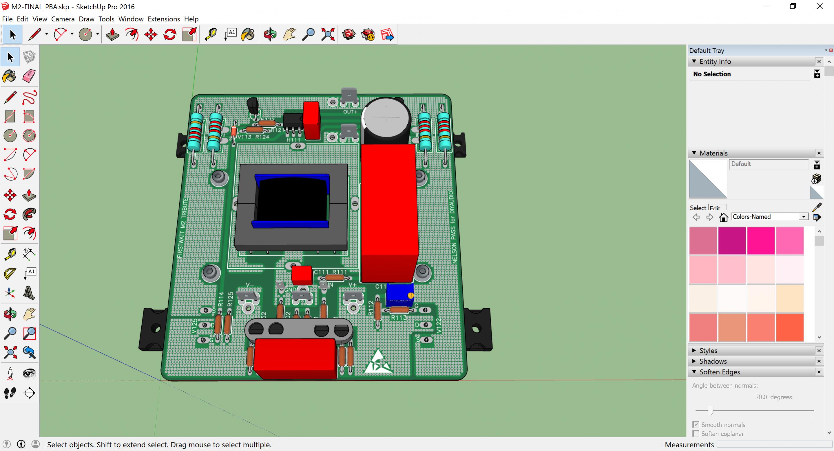

Before starting GB PCB M2 amplifier, here last documents.
