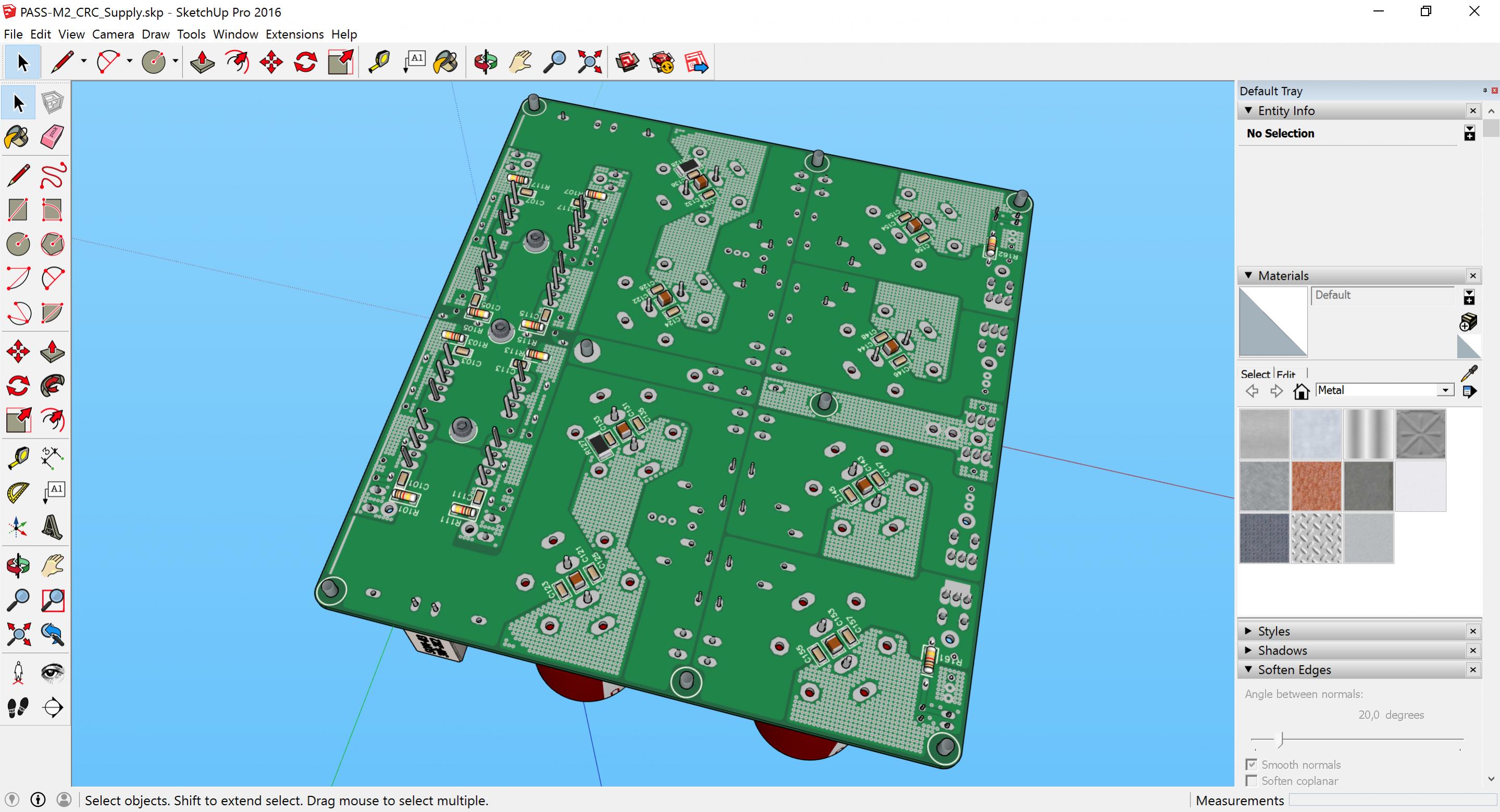

Official M2 schematic
Last modifications.

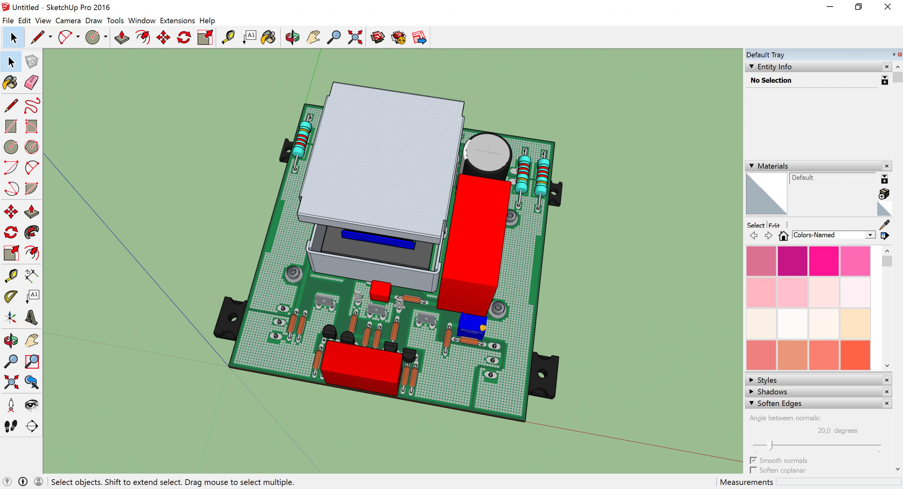

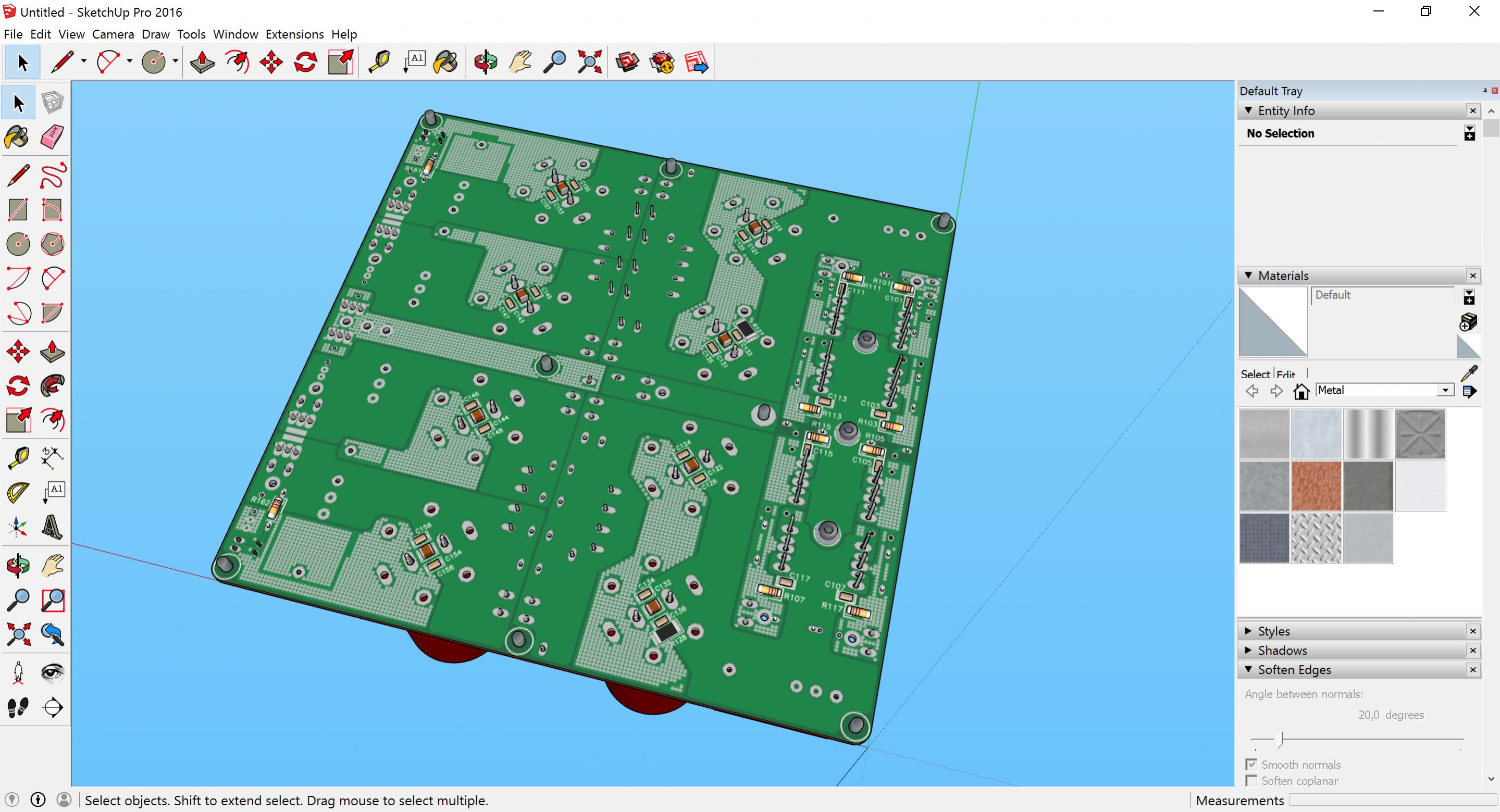

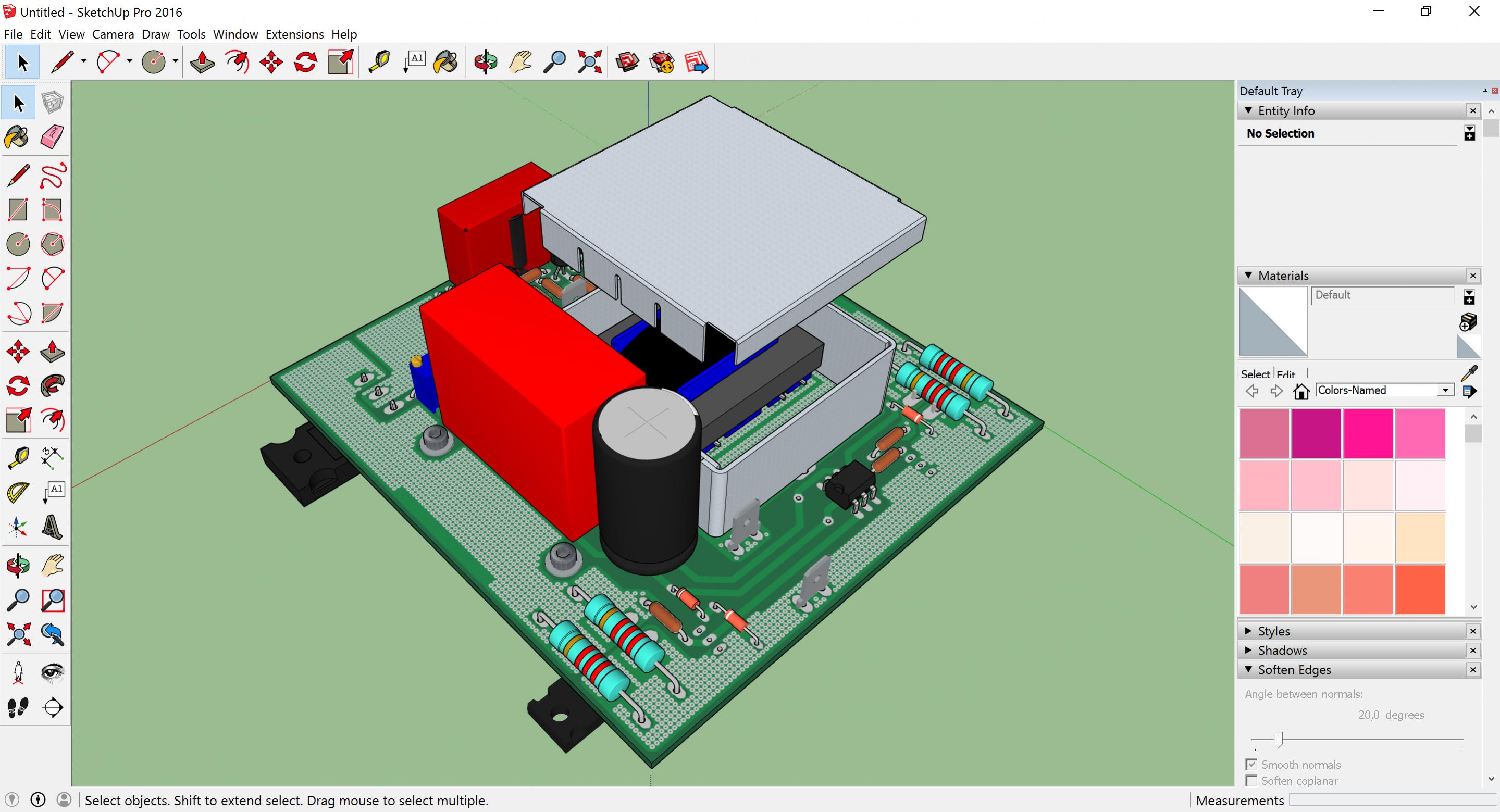

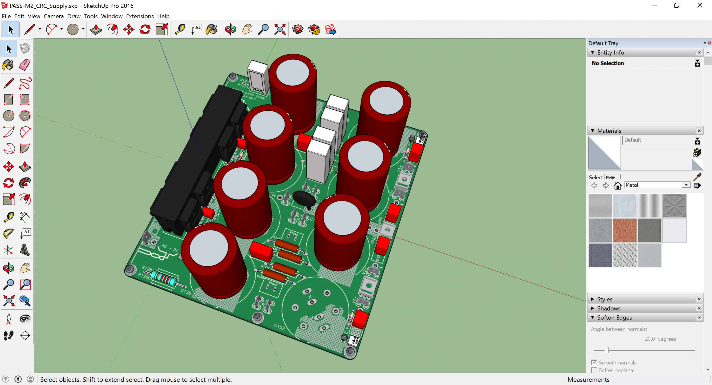

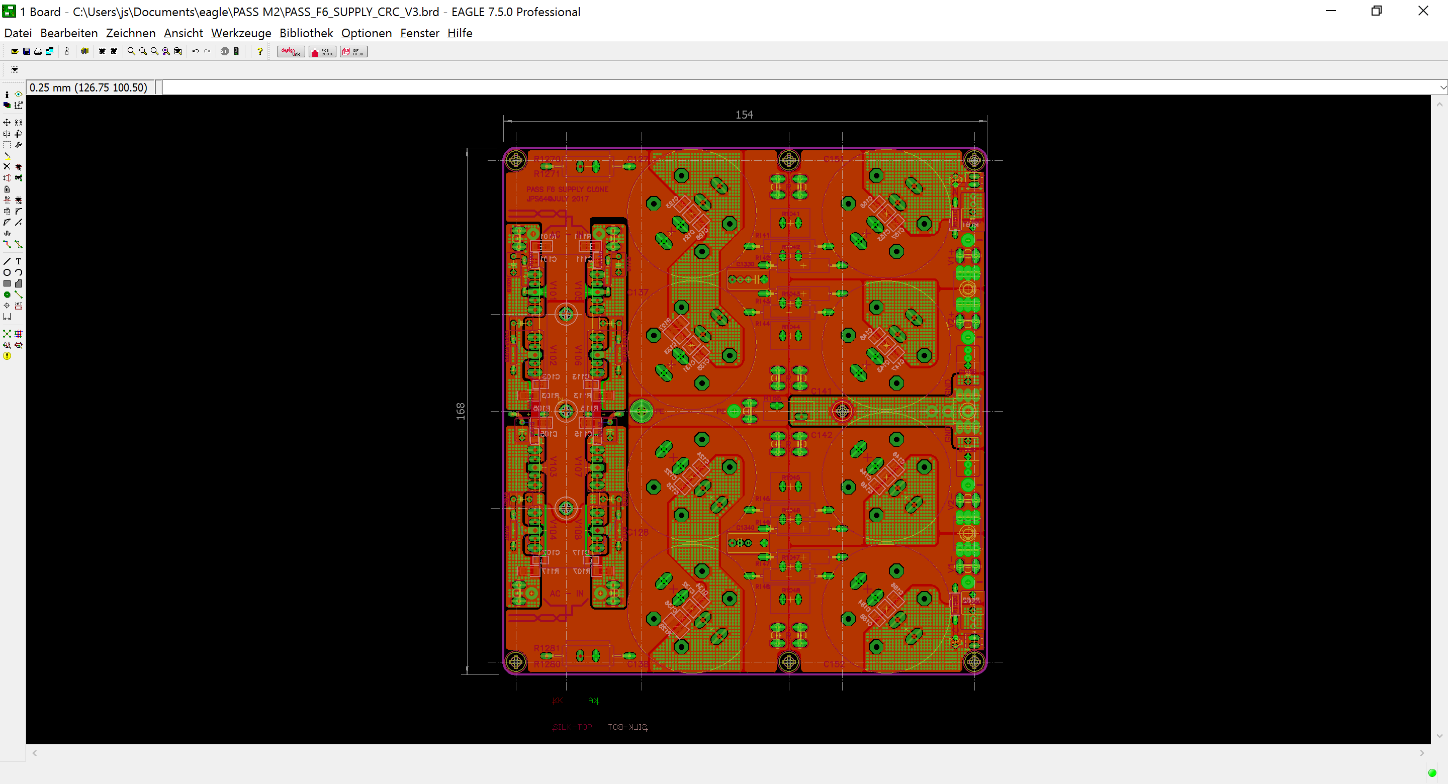

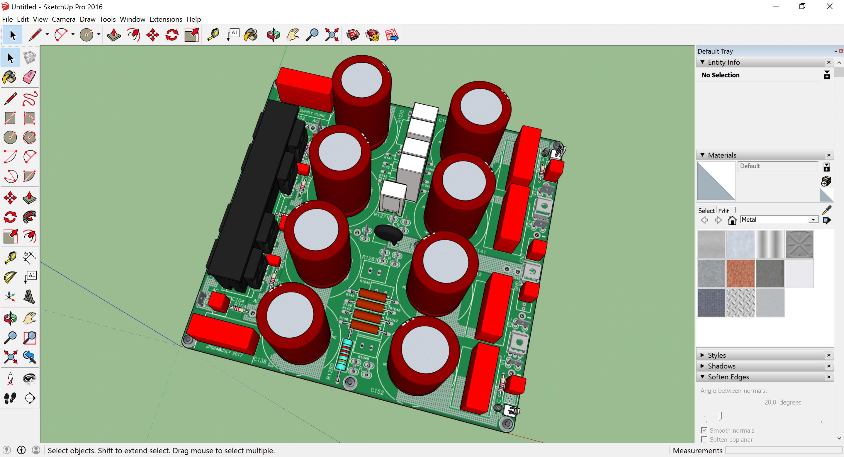

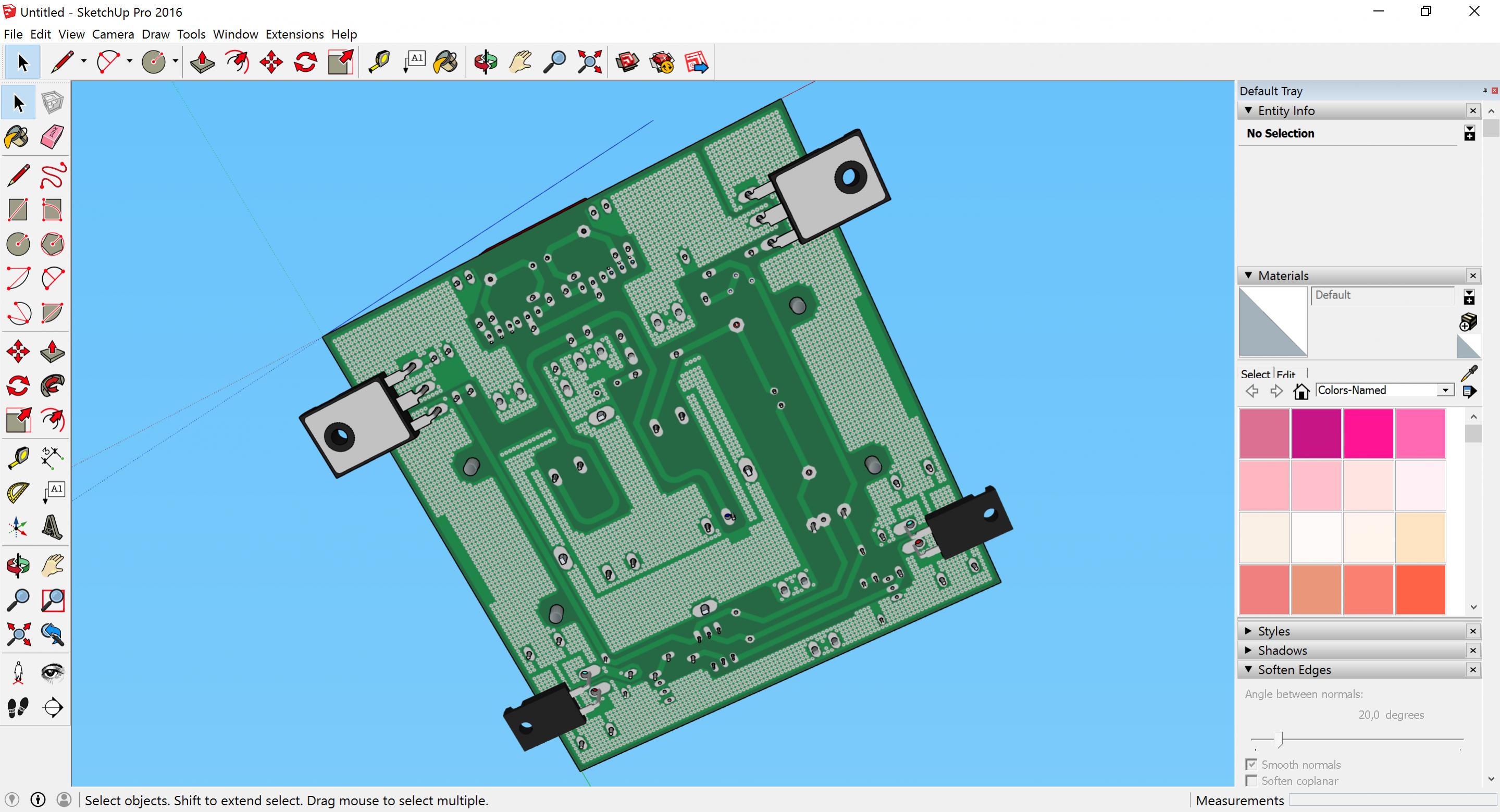

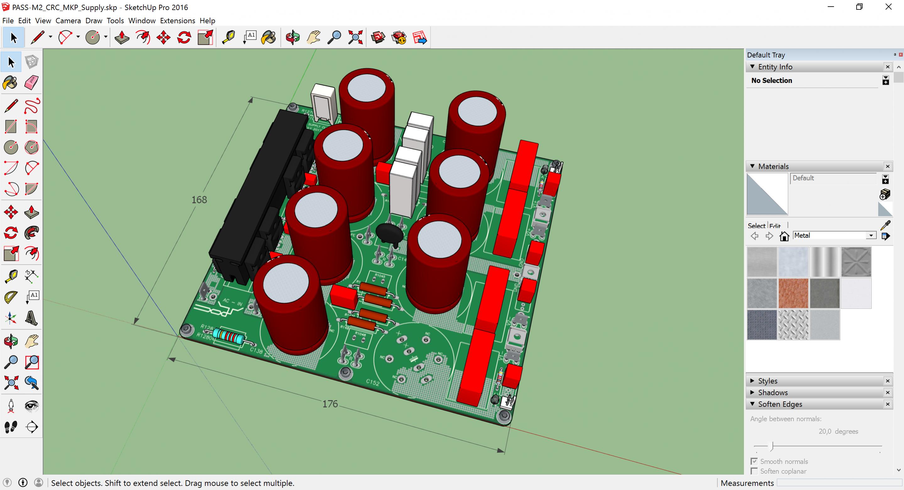

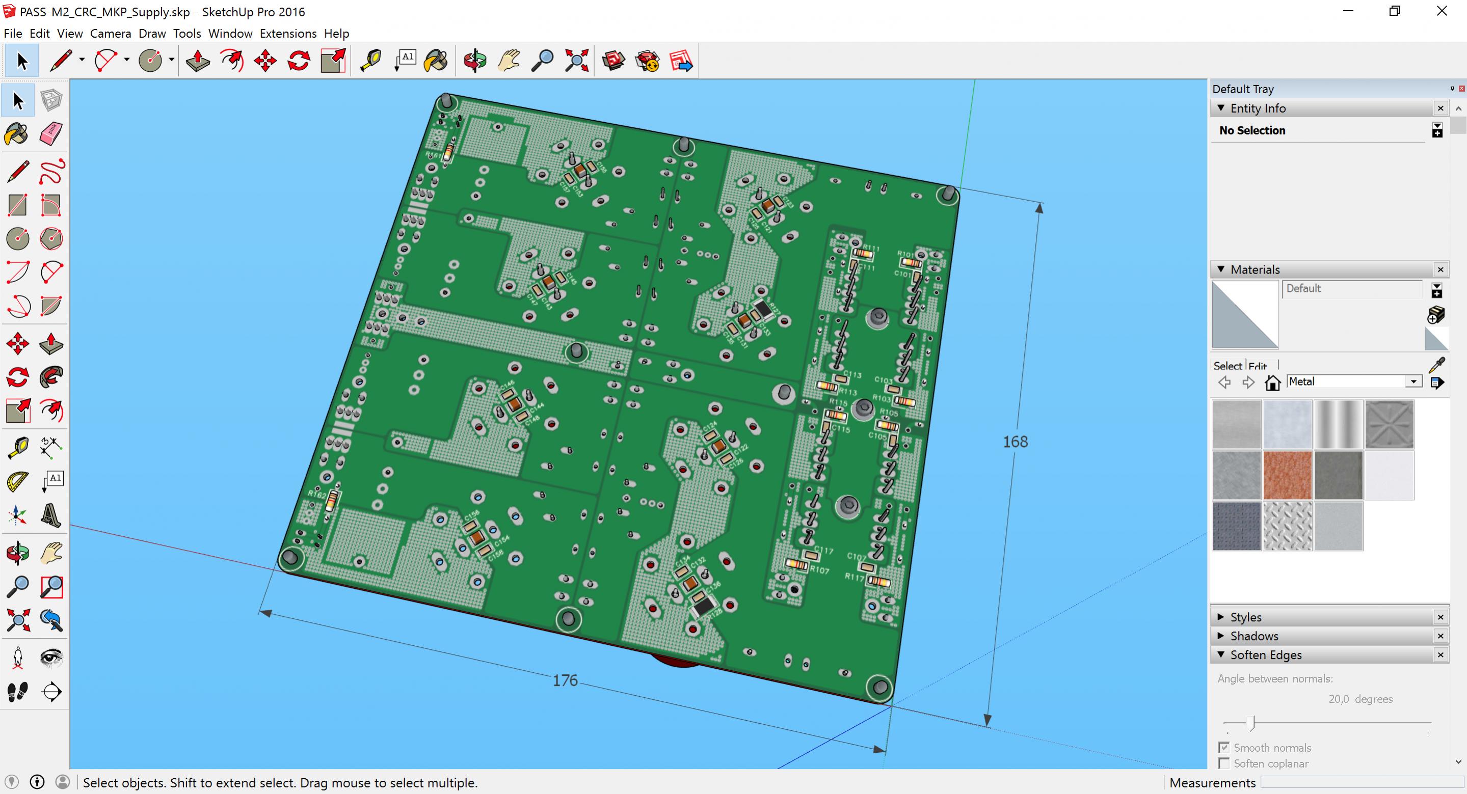

Is there a recommendation for film capacitors in parallel to electrolytic ones?
JP
Hallo JP,
I really like WIMA MKP10. Usually use them as signal path caps or bypass in signal path. When I can fit them, I put them in the PSU as well as bypass (often 2.2 µF - 4.7 µF). Otherwise, I try to use WIMA MKP4.
Both variants are large and need to be mounted directly on the PCB, though ... :scratch2:
Viele Grüße,
Claas
Rectifier snubber is MKP2 PCM 5mm W < 4.5mm and 0207 resistor (22nF/400VDC + 4R7?).
Other ones, PCM 5, 7.5 or 10mm W < 6mm (MKP2).
Using MKP4 or MKP10 will need a 40mm longer board (up to 200mm).
Price differs marginaly,
Standby, waiting for decision.
JP
