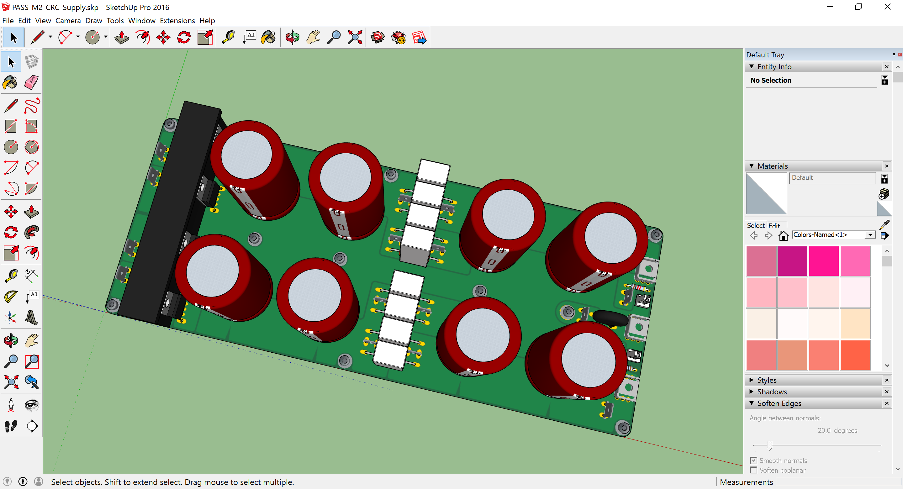

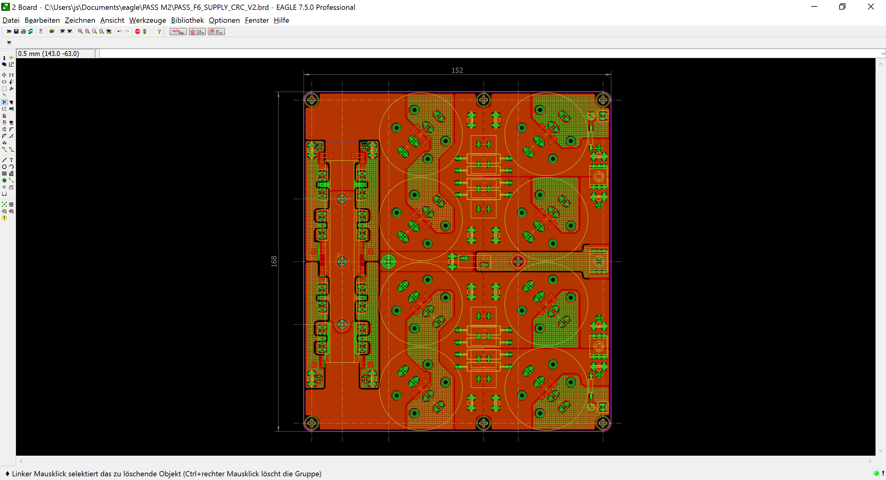

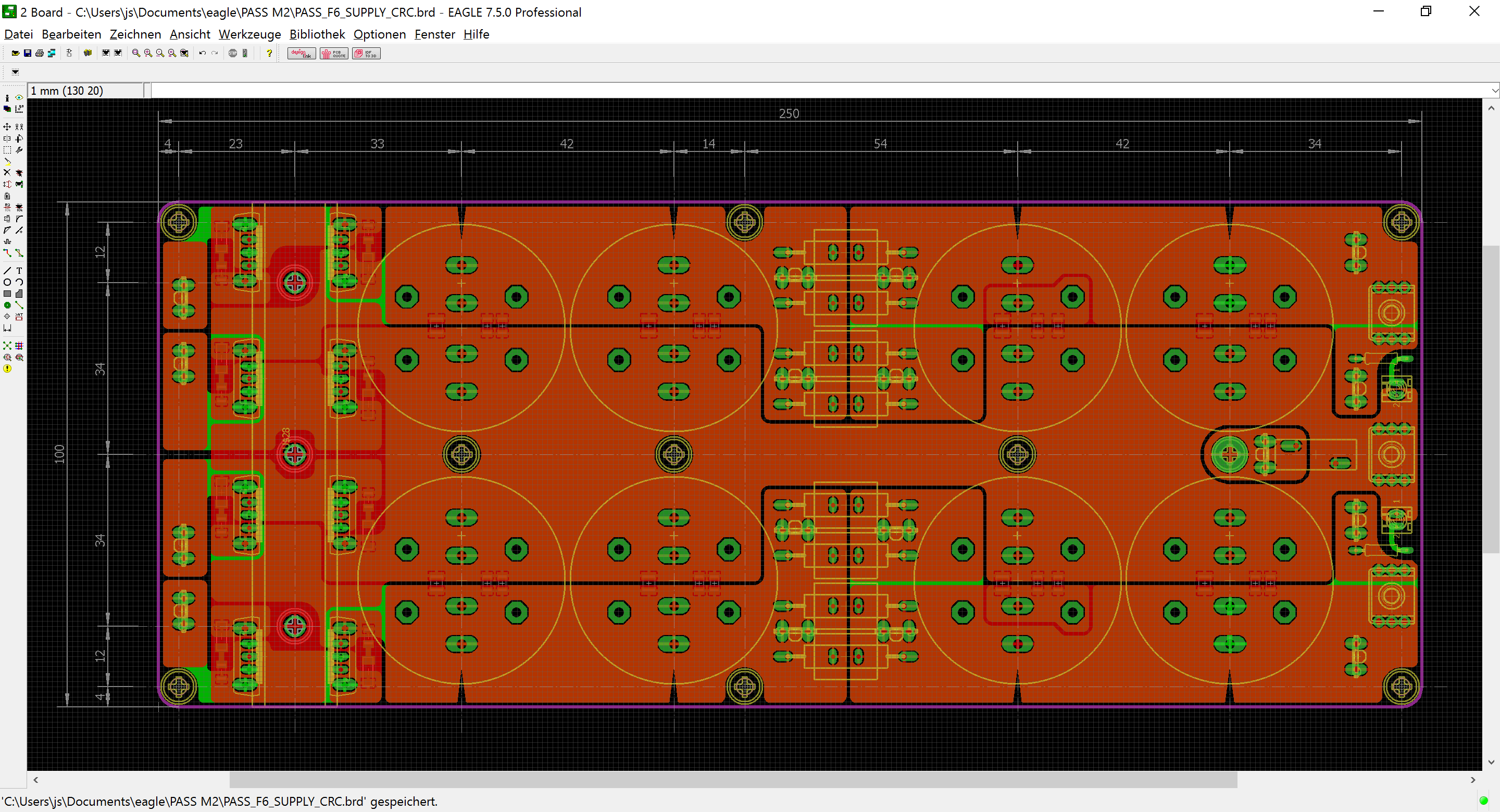

as promised...

Hello ZM
if you´re starting with ECAD to MCAD export, I´ll suggest to use EAGLE IDF export (all ECAD tools export IDF) and FreeCAD with MCAD PCB plugin (you´re using 3D STEP models directly, only X,Y,Z mapping is boring). It´s simply professionally (IDF to SolidWorks) with STEP modelling and not MESH modelling.
Here the Link for SketchUP: https://eagleup.wordpress.com/
For the models: I´m using 3dcontentcentral (or manufacturer) for STEP/IGS models; then FreeCAD to STL conversion; then STL to COLLADA using Blender; finally importing COLLADA into SketchUP.
Don´t forget, you´re working in meter!

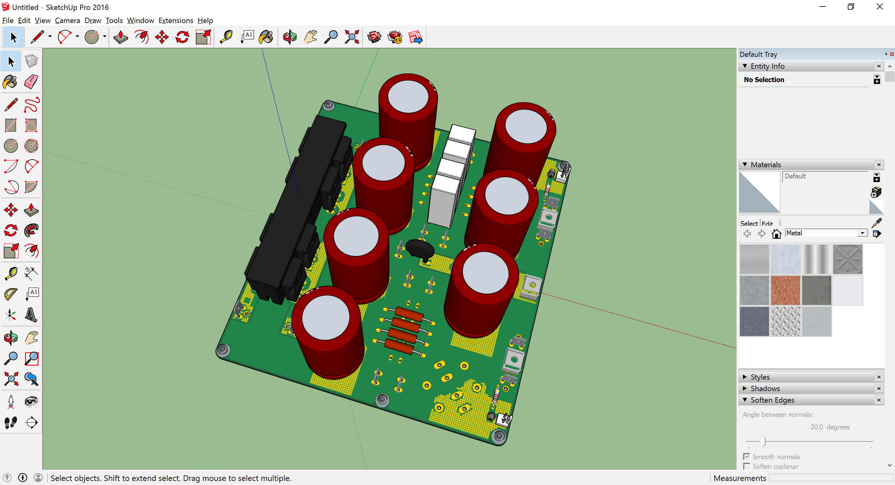

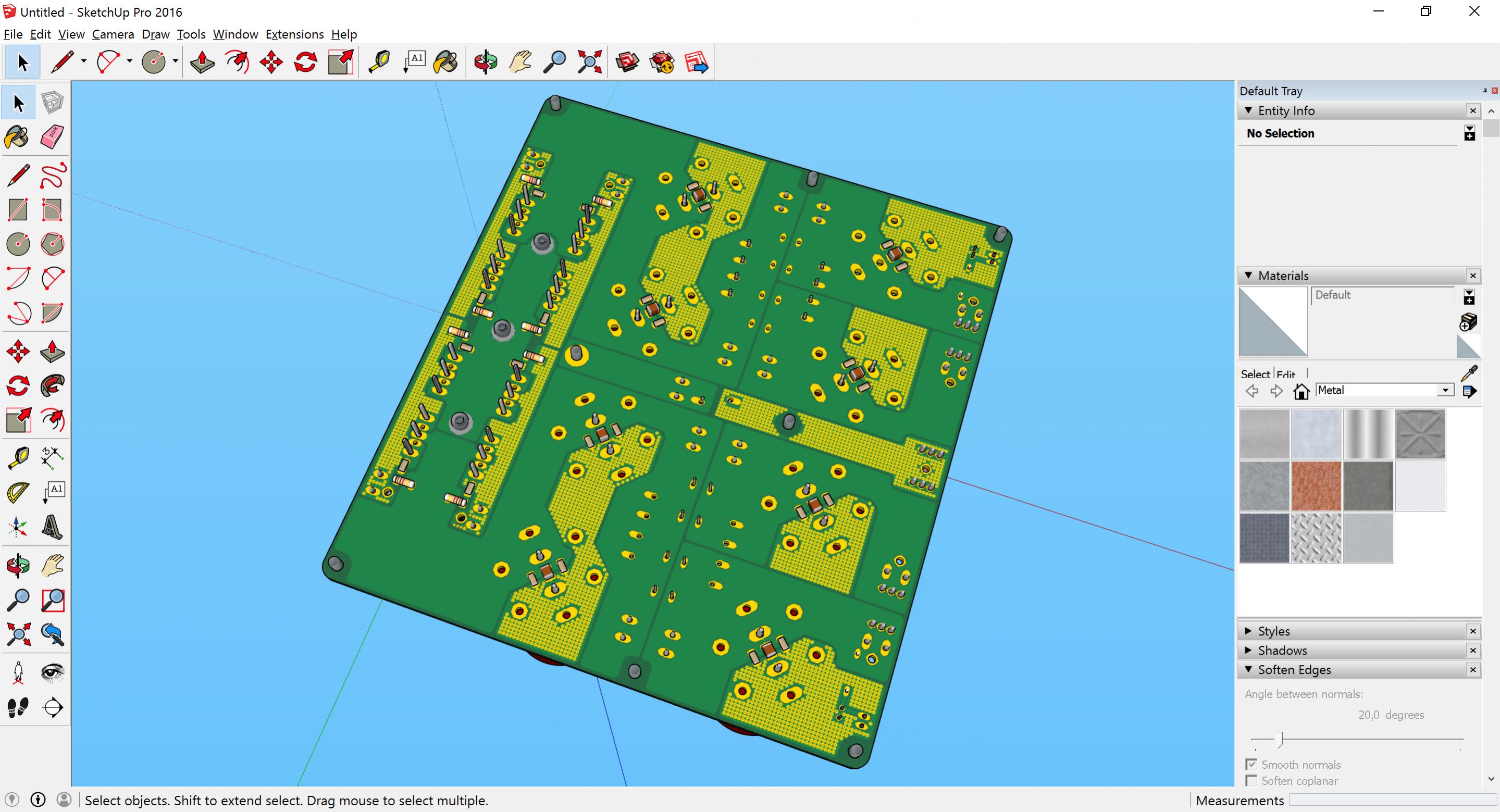

Next attempt.
Dual common cathode TO220 or TO247 diode.
Fischer Elektronik SK492 heatsink with THFU clamp.
Shunt realized with mounting ept 911-32006 power terminals.
Faston or wired cable connection.
JP
