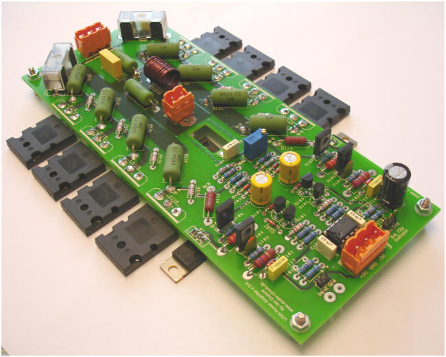

hi jan,what distance(mm) from your PCB and Heatsink?
can i separate the heatsink of driver from output transistor?
because i think the pin(foot) of MJE15030 n 15031 is to short.

crt;
I use 8 mm spacers, but you ca easily use 10 or 12 mm spacers.
??? Please look at the attached picture.can i separate the heatsink of driver from output transistor? because i think the pin(foot) of MJE15030 n 15031 is to short.

I mean, the driver have a small heatsink (like in DX amp) and separated from the BIG heatsink for output transistor.
I have try to measure the pin only have 9mm length
when i use 10mm spacers the pins will not arrive to the top of PCB.

The driver transistors be mounted on the main heatsink and the pins are sufficiently long. What is the problem really? Why do you want them to be on a separate heatsink?crt said:I mean, the driver have a small heatsink (like in DX amp) and separated from the BIG heatsink for output transistor.

Hi Jan
I can´t find C114 and c115 on the component list.
But at the schematic it looks like 100nF 150V.
And Vishay MKP 1837 is 160V 10%, perhaps should go there.
For C104, 107, 108, 112, 113, the Vishay MKT 1817 is within the spec of 60V/100V 5% ?
Am I wrong ?

I will update all the cap info in the component list later today, and upload it. It also seems like some of the original caps (which I have plenty of stock on for my own use) seems to be hard to get now. Maybe they are even obsolete.....
I will notify you all here when uploaded
