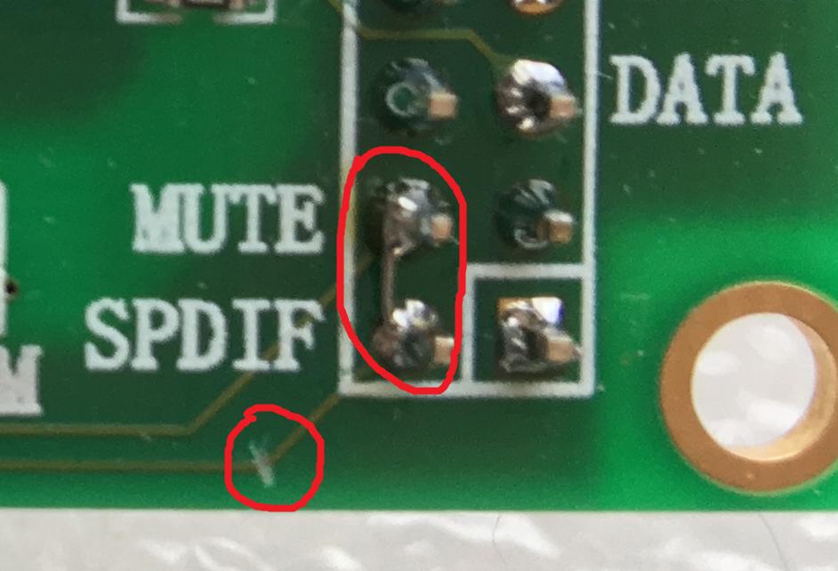

Interested in DSC 2.5.2. Can I use XMOS instead of Amanero? Thanks.

Yes, you can. But if the board does not have a MUTE line, you will hear loud click/pop at the beginning of the track.
There is XMOS with MUTE. Pavel reports that it works stable at DSD512 w/o click/pop.
You must manually wire MUTE pin (see picture).

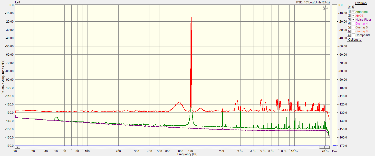

I also attache some Pavel's measurements of this board.

It is curious to see different performance in the analog domain related to an XMOS interface. As there are plenty of DACs which perform (measured) at a very high level (noise floors at -140 dB, no harmonics above -130 dB), it would appear that the XMOS interface Pavel used for these measurements was not optimized.
In any case, it is interesting. Latest news from Dom is that there will soon be Amanero firmware version 2004 "soon", which will (hopefully) once and for all address the Amanero difficulties with Linux and high rates of (native) DSD...
