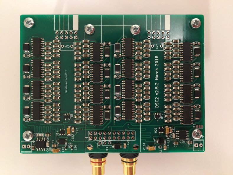

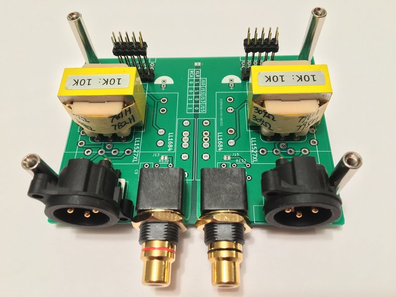

First DSC 2.5.2 photo!
Under testing now.
You can see different options for assembling boards.

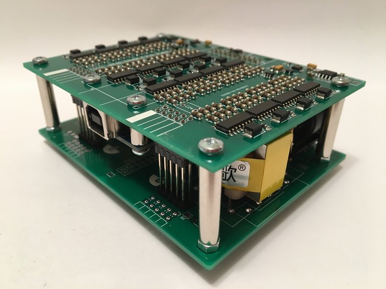

Couple of questions:
Which version of the DSC is displayed in the stacked (3rd) picture?
Also, does it come with the Amanero card or we need to procure Amanero separately?
If separately, will the one purchased from Amanero directly fit the stacked layout.?
What else do we need to purchase to get a completely working DAC (power transformer, etc)?

1. It's 2.5.2. There are several way for assembling.
2. No, it does not. Amanero needs to be bought separately. You can use any USB interface with standart Amanero pinout. If not, wire DSC manually. But remember, that XMOS produce loud pop at start.
3. You need power transformer (6 - 7 V is enough) and rectifier. Two channels should be powered separately. DSC v2 has LDO ADP7118 preinstalled. But you can disable it and use any other voltage regulator. 5V and min 150mA per channel is needed.

Additional photo of DSC 2.5.2. You can see what connectors are needed for stacked configuration

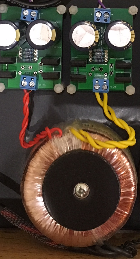

Yes (even 6V AC is enough, like in my case). Don't foget to add some capacitors to stabilise voltage. It may look like in the photo below.[with internal LDO] A transformer 240V to 7V AC with dual secondary and a diode rectifier bridge (Shottky) for each of the lanes
[without internal LDO] ?? . I read here [wiki=http://www.audiodesignguide.com/DSC1/index.html]%[/wiki] that a 3-way power supply is required in order to provide 3.3V, 5V and 7.5VDC but dunno if all voltages are required for the board (no ak4137)
You need only 5V (two lines) to power DSC2.5.2 from good power supply.
No need in 3.3V, Amanero board supply it to DSC 2.5.2.
No need in 7.5V. It's for AK4137 I think.
