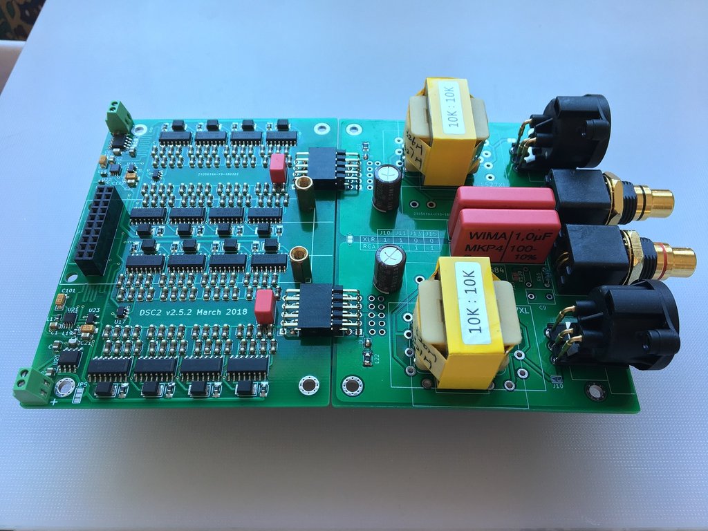

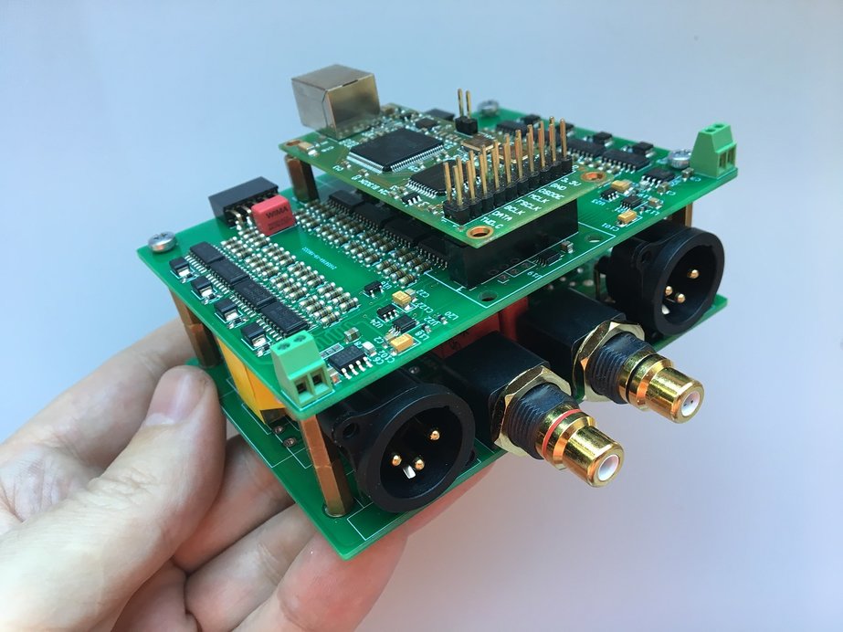

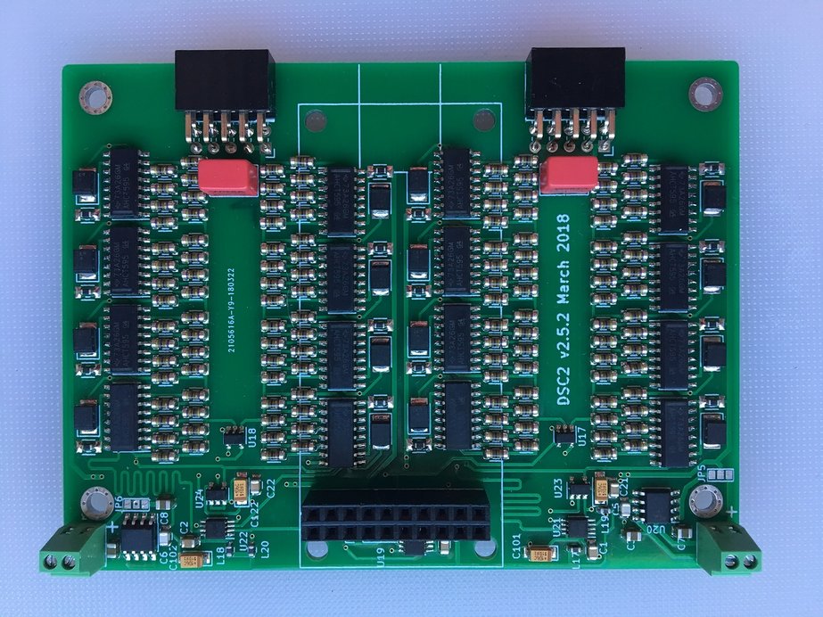

First DSC 2.5.2 photo!
Under testing now.
You can see different options for assembling boards.

2.6.2
The boards look very good! 2.6.2 will be the same, two boards that can be connected? If yes, is soldering necessary or those clips from the images will be included? I really like the second setup with the boards stacked but I don't see how these are connected (the clips look smaller in the first photo)
About the amanero how is it connected? Could you please give me some links of where to buy such connectors?
Thank you.
No, as described in the first post, 2.6.2 is a single board.
Thank you.
The Amanero board plugs into the socket on the DSC2 board. New Amanero boards come with suitable connectors, otherwise 0.1inch headers and sockets are readily available from suppliers such as Mouser, Digikey, Farnell etc.
