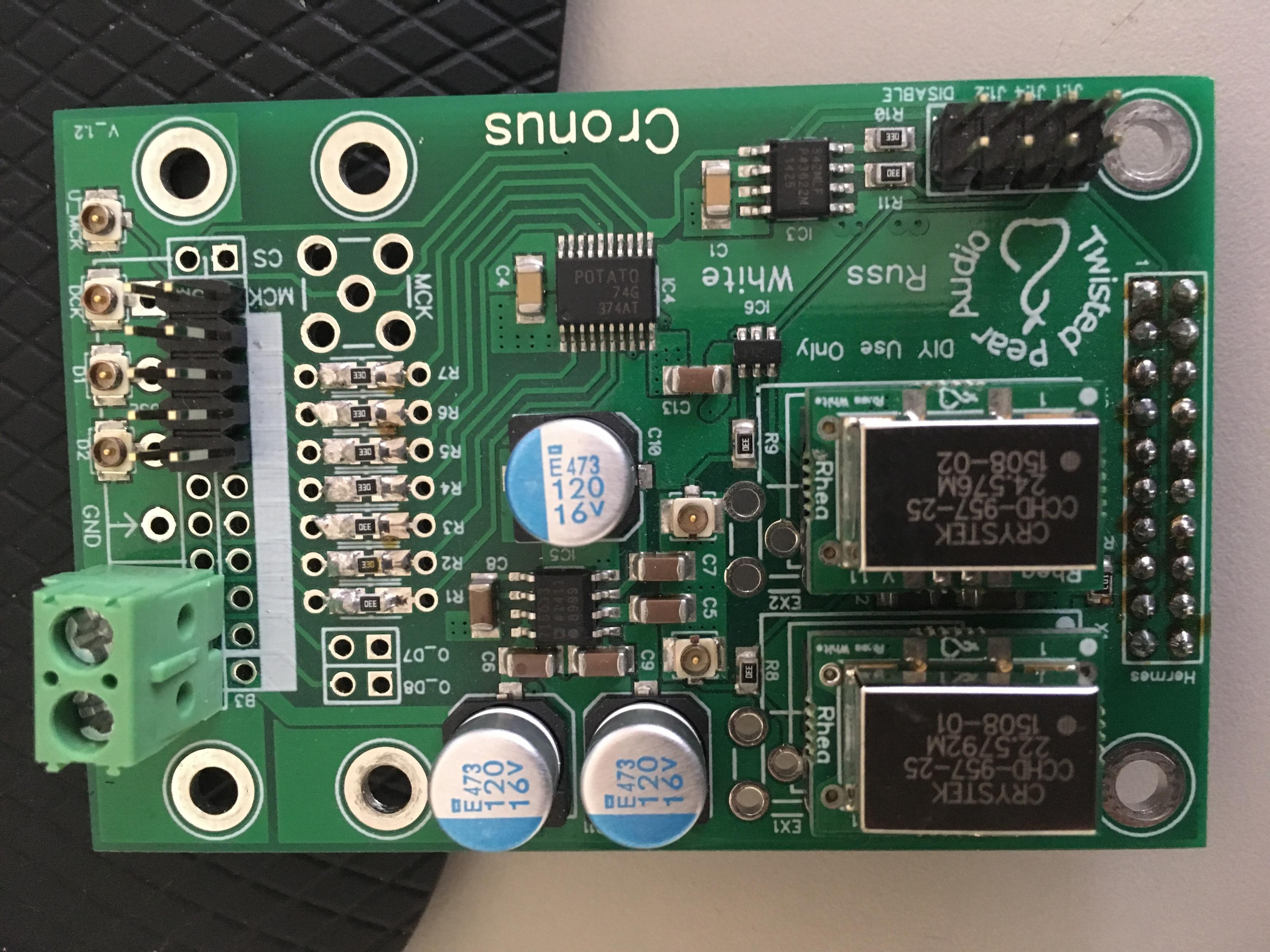

Does anyone have close up pictures on how to connect Cronus and DSC? I cannot seem to find the information needed on the pinout for Cronus. I see the uFL setup but my Cronus also has the jumper pins (not sure about the correct terminology).
If it is not possible to use the jumper pins, I will order the uFL cables. Since, I am new to DIY world I am going to attempt to make it work with DSC 2.5 in case I goof and fry something.

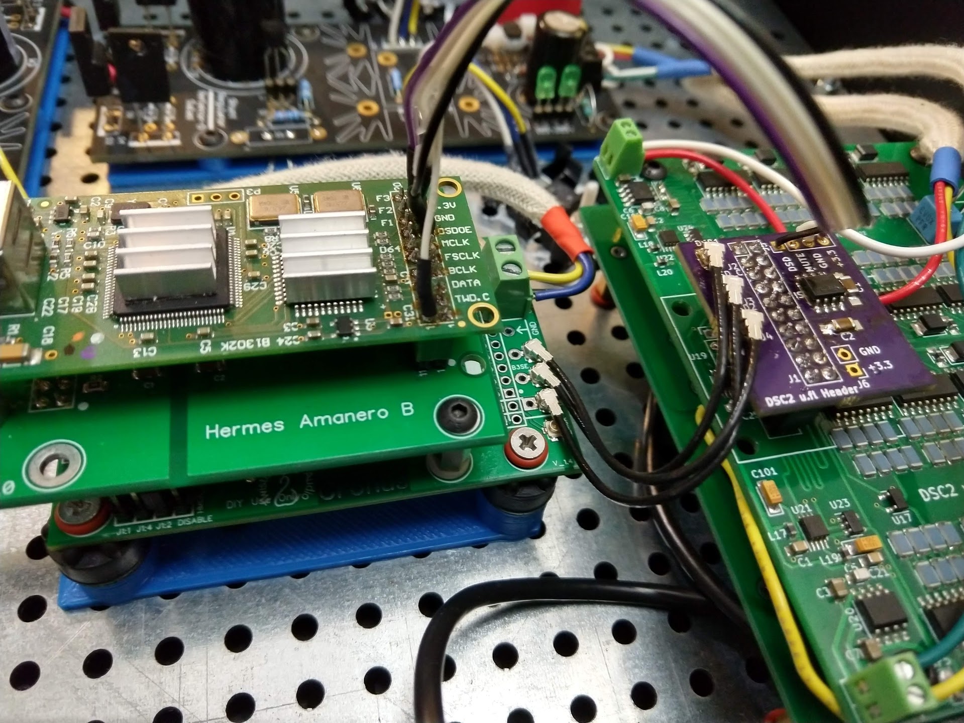

Hi
I think the pic that you are looking for is attached. It is online with the gerbers for the interface board. Apologies that I cannot be more specific as to the location but if you are really stuck then just pm me.
Kind regards

Thx for the pictures. I did see those but they seem to have Amanero board in the mix. I was hoping for pictures with out the Amanero in the mix.
I was hoping someone had setup similar to what @luchoh describes in Signalyst DSC1 where he has the following setup up and running - BBB>Hermes>Cronus>DSC2.5.
I am hoping he would chime in or if any one else has it working in similar fashion, maybe @nautiboy?

I made that little header.
It doesnt matter if you use BBB or Amanerno, as long as you feed i2s via u.fl and DSD_ON, MUTE via headers.
Would you have any spared built headers, that I can purchase from you?
Sorry I dont have any spare parts left to build it.
I had it offered on OSHPark: OSH Park ~
You will need following parts for it:
80-C1206X104J3JAUTO x2
595-ISO7320CQDRQ1 x1
872-920-0133-01 x1
712-CONUFL001-SMD x3
523-A-1PA-137-070B2 x3 (choose length to fit your setup)
Also you will need a 3.3v supply (clean if you will) from DSC side.
If you choose against using isolator on the header, you can get away with only the 20-pin header and 3 u.fl connectors. In this setup, DSC is using 3.3v from amanerno/BBB (not so "clean" as to audiophile standard).
