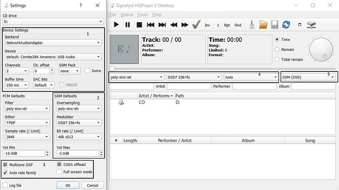

Unfortunately, I could'n find NAA from BBB. It worked for a moment once and then nothing. Tried 3 times steps from guide ...
I've got uname -r correct, all grep commands parameters correct but no botic device detected...🙁
What is a output of aplay -l ?
Start networkaudiod from shell:
service networkaudiod stop
networkaudiod
What do you see as a output? Start playing any file - what output?
When you start HQP at main computer, do you see NAA backend "botic" in HQP Settings?

Yes, used sudo for this but nevertheless, there's nothing to choose from in HQP, and during HQP startup message is Failed to open audio device...How to check if networkaudiod is running? When enter sudo networkaudiod I get no response from terminal any more. I must ctr-c to be able to type in terminal again.
When you start networkaudiod from shell, you see all messages from it directly (not from log file) and can't use this terminal while networkaudiod is working. Just start one more terminal session, if you need, and switch between windows. Ctr-c in this case stops networkaudiod.
Then, after starting HQP, you should see some messages from networkaudiod. Post them.
If no messages at all (nothing changed) - you have no connection between BBB with NAA and computer with HQP. You will need to check network settings.
Do you use DHCP at your router? Are there any limitations (MAC address, number of clients and so on)? Firewall?
Check IP address of BBB by sudo ifconfig or ifconfig eth0 for ethernet connection.

BBB has working network and internet otherwise I couldn't be able to download anything during preparation process and of course Bitvise SSH client works without any problem. For the moment even disabled firewall but to no avail.

There are no any messages during HQPlayer start in networkaudiod terminal...
Yep, I see.
Debian image can be installed from a USB flash drive with using serial port to interact with.
Check HQP settings (see tab 1 in attached picture) and try as a Backend - NetworkAudioAdapter IPv6 too.
Sorry, I have no other clues for now. Tomorrow I'll try to install Debian + Botic exactly as described in HOWTO and give feedback.
As a option you may try to write ready image
BBB_Botic.pmf - Google Drive
This will help to understand what the problem is.
