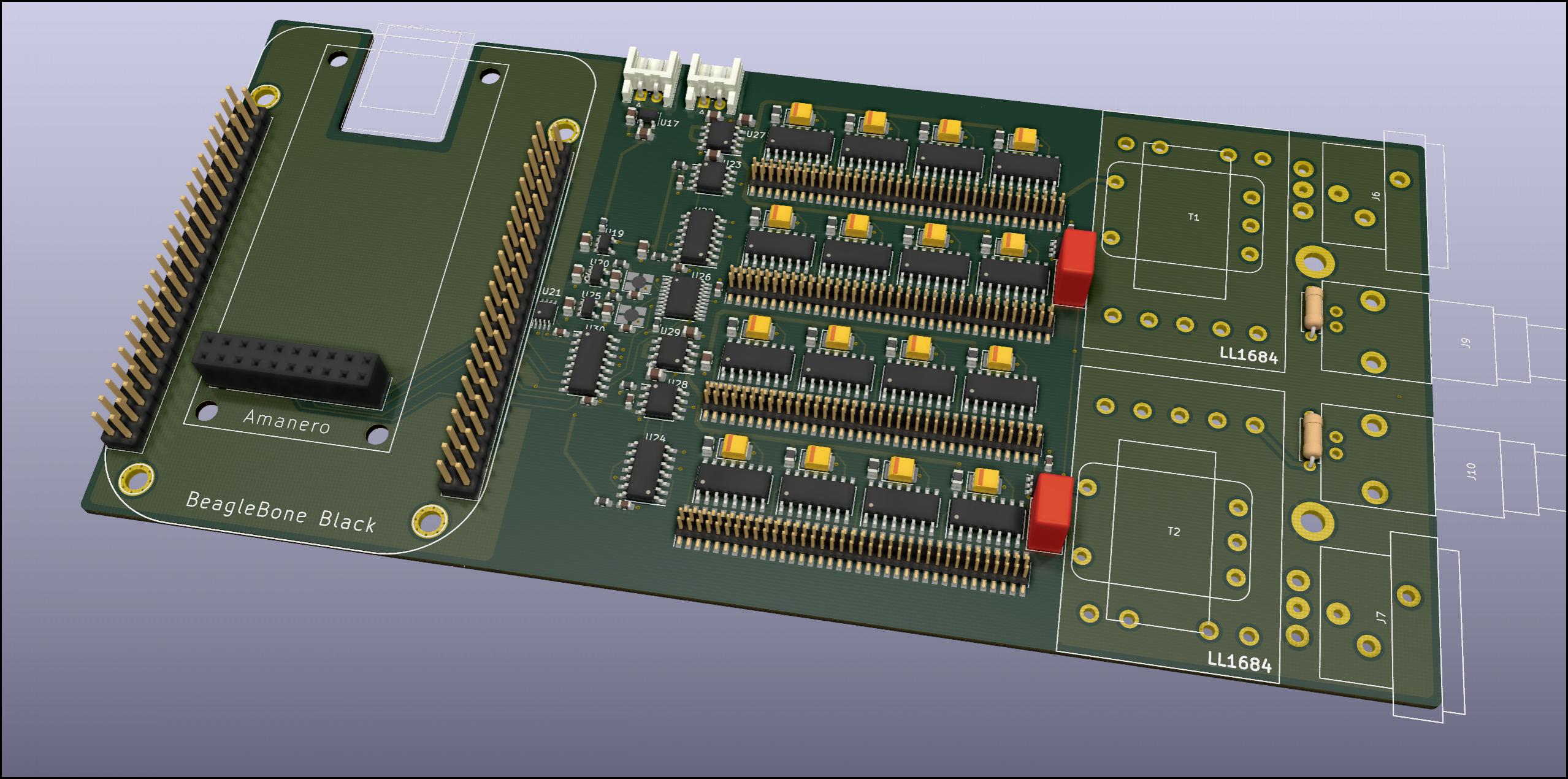

Completed design BBB&Amanero + isolator + reclocker + DSC2
Oscillators NDK NZ2520SD and reclocker made on a fast series Potato.
very nice and neat! transport and dac on one board
possible to give people the option to upgrade the oscillators
to NDK NZ2520SDA?
heard that they have better spec.
NDK NZ2520SDA oscillators group buy
Oscillators
maybe have dip14 socket so we can roll our own oscillators?
can amanero's own oscillators be disabled with firmware and run in slave mode with ndk oscillators from the dsc board providing master clock ?

will the new dsc board address the problem of the shut down of bbb?
i assume we can only run in mode only? i.e either amanero or bbb only?
not possible to stack both together , so amanero connect to bbb, with the
change of software people can choice between bbb usb out to amanero or bbb i2s out.

This PCB is still a prototype. I did not have experience with BBB. Now I'm waiting for the PCB and the details for the assembly. If there is a commercial version, I will take into account your wish.
Introducing the Hermes-Amanero
Yes. In this version, Amanero and BBB only work in slave mode.

Two options: Amanero I2S or BBB I2S
As long as I have some free time, I do a micro firmware with the botic kernel and root filesystem from RAM.

Cool new design Pavel!
I would recommend the better NDK NZ2520SDA series XOs, same footprint as the non "A" versions but lower phase noise. Also, you may be able to mount just a single 27.5792 XO as long as folks are only sending that base frequency DSD files to the DAC. A single XO may have advantages, as it will only modulate the power supply with one frequency. I know single XO works with Amanero.
