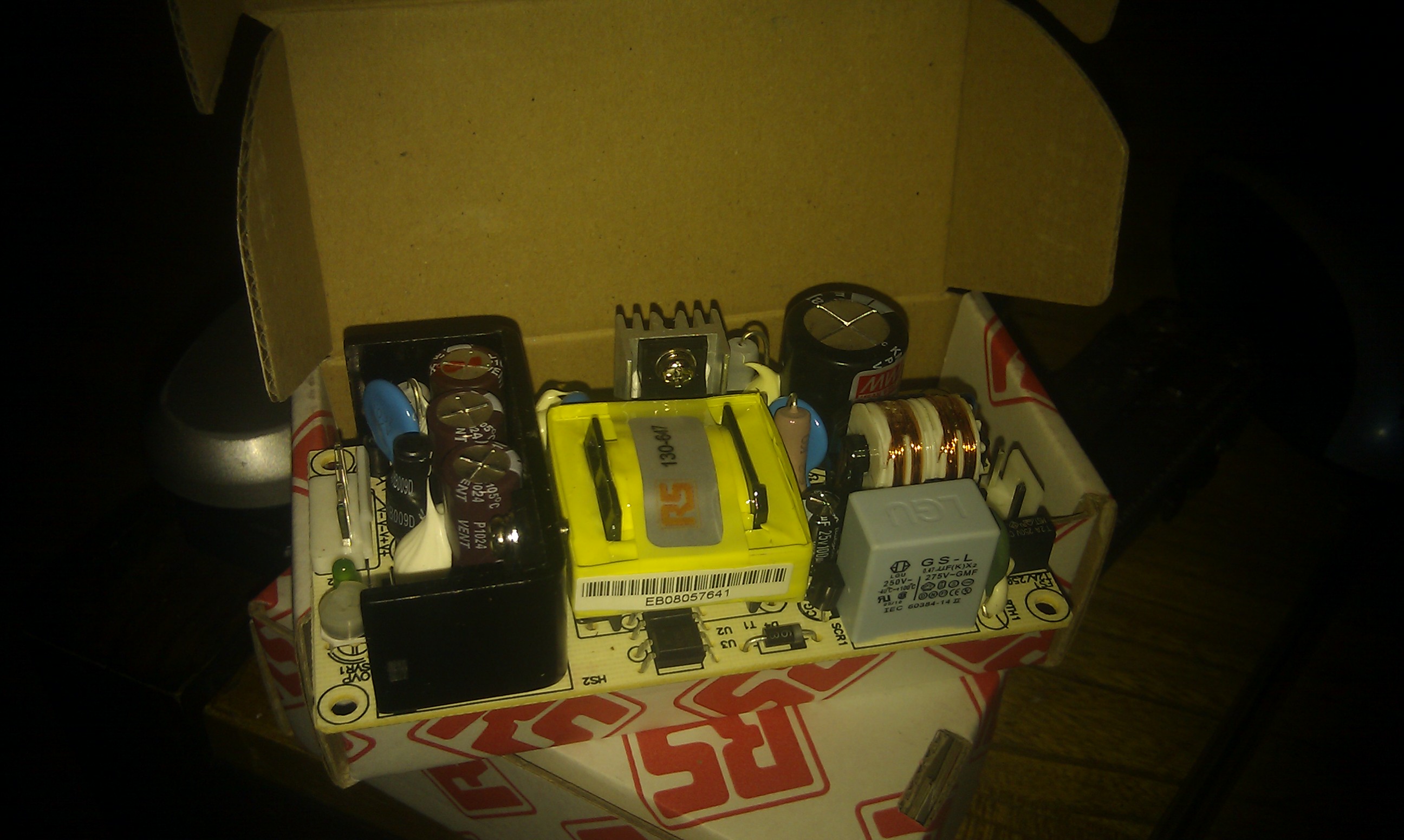

More RS stuff has arrived!
Reckon the parcelforce guy must think i'm nuts. RS keep sending single capacitors that weren't in stock the first time round. This is the fourth day the same guy has dropped off kit 🙂)

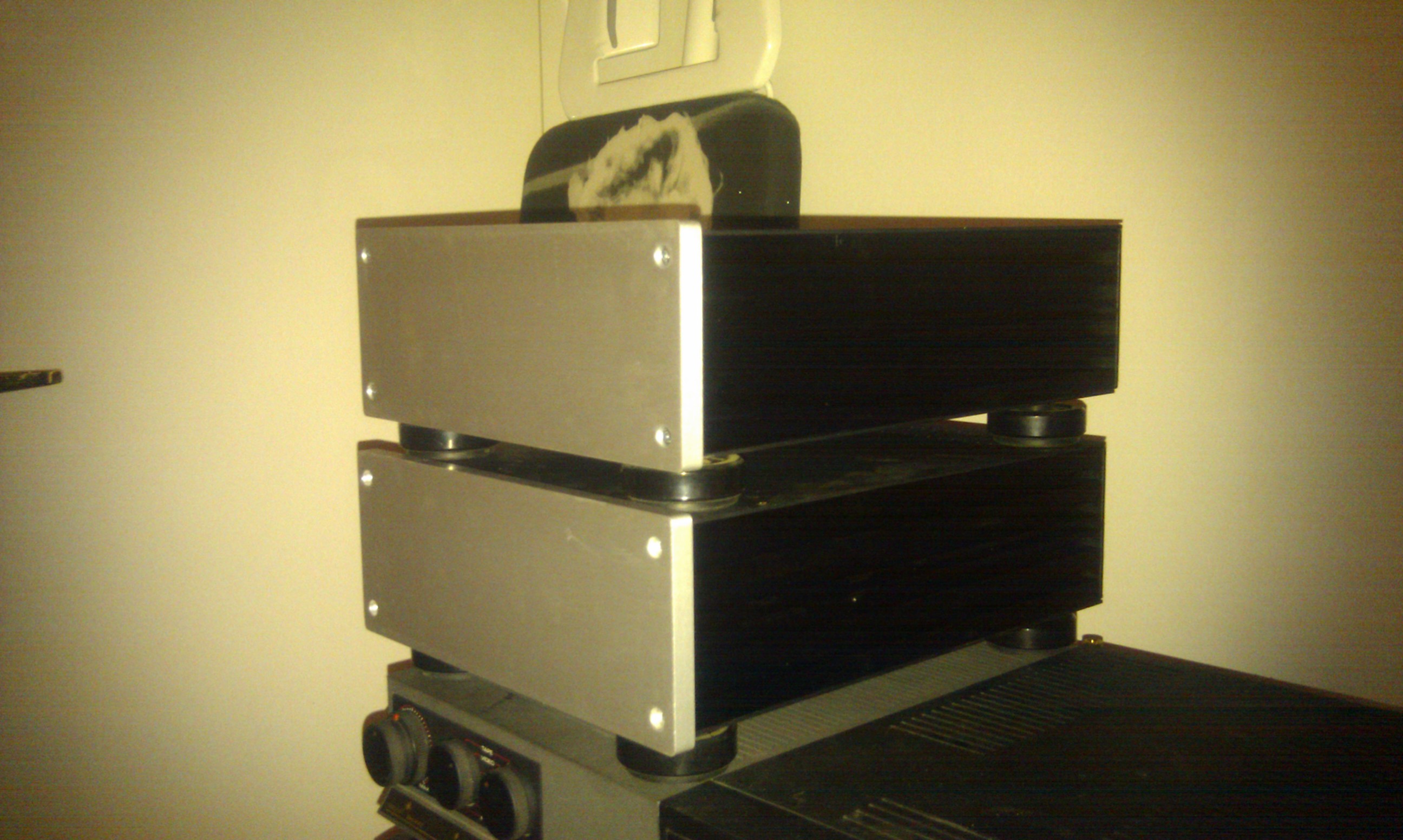

Wow!!!!
Well,
After many long hours of investigation and also some nervous moments performing low voltage then H.V tests on the blocks I am pleased to say that my build is done.
I decided on substituting the thermal valve relay with a classic OP-Amp circuit incorporating a 500V rated relay.
I have attached a link to a picture of the finished units below.
ImageShack® - Online Photo and Video Hosting
I am delighted with them. My father and I thoroughly enjoyed the experience (despite the worries on initial power up!!)
Just wanted to thank everyone on here who helped me in the initial stages.
The Oddblock Mono's are a great design and sound sublime.
Peter.
