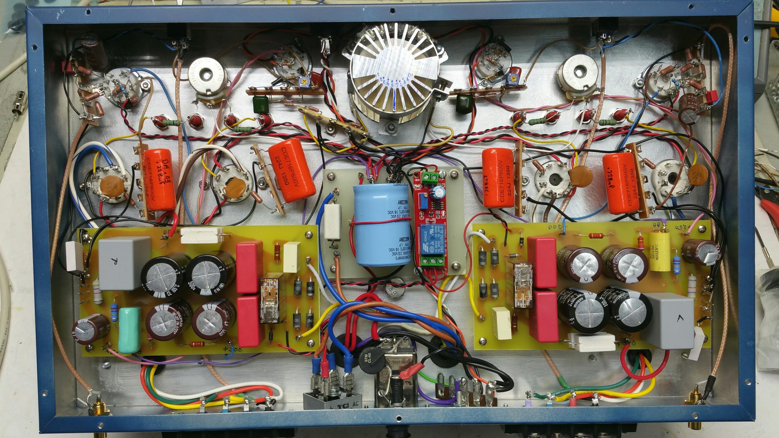

wow I really like the layout!!

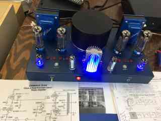

I took my Oddwat to the 2017 BAF and talked to some intresting people. Thanks Bruce for the nice design.
is your amp dual mono? integrated? I ask as it is not a normal looking OddWatt
The power transformer IA a Antek AS-4T360-400VA 360V at $57.00 . This monster weighs in at 9 lbs.I ordered the CA-400 Steel cover $26.00. It is important to insulate the edge of the cover so it does not touch the chassis as it will cause a short circuit. I used a piece of door edge molding from the automotive store. Dual secondary 360V at .55A along with dual 6.3V at 4A.
The amp is dual mono. The power transformer has dual seconday. It does weigh in at about 33 lbs. Mono Blocks would be easier to move, but I like the looks of the stereo version. Note the Eye Tubes on either side of the heatsink.
Hi Eslheadphone, Always nice to hear from a happy diyer. Nice looking build. I personally prefer the mono blocks as they allow for easier placement in my listening room. I am presently working on a variation using 4P1L directly heated pentodes. looking for about 4-5 watts. The tubes are easy to obtain and supposed to be really sweet.
Nice looking amp. Of all the photos from BAF, pictures of your amp were the only ones I saved to disk.
(Thanks for posting the link to the heatsink too. That was a real eye-catcher.)

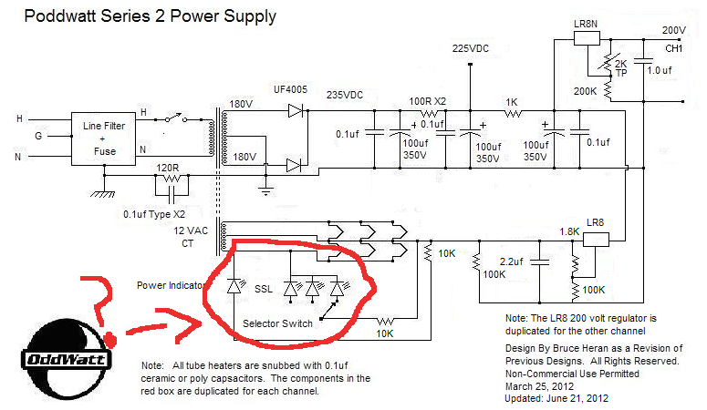

I am *very* new to this, and I am trying to make sense of the circuit for the Poddwatt Series 2 Power Supply. Can someone help me understand the 3 LEDs and selector switch portion of this? It reads to me that the switch is just including 1 LED, and hence would have a switch to light one of 3 LEDs?
http://diyaudioprojects.com/Tubes/E...ush-Pull-Valve-Amp-Power-Supply-Schematic.png
Thanks in advance
