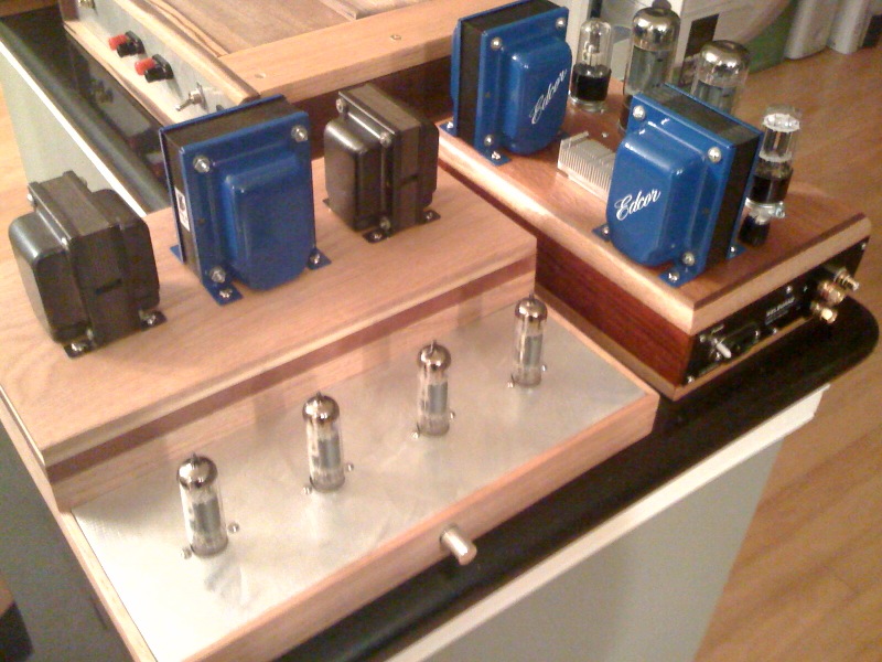

Here is a pic I had on this computer of one of my oddblocks. It is sitting next to a point to point from scratch build of the K-12G. The K-12G was the purpose of the pick but the oddblock just happened to be next to it. I will post several picks soon of the finished products.

Jeff, thank you very much for your response! I am planning on building them as mono blocks with all Edcor Iron. Your mono block looks fantastic!

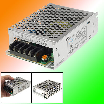

I am not having luck locating the correct SMPS for 12VDC 3A or 5A. I saw some that were $150++ and were huge. Is there a link to the correct type?... Ahh, too bad you don't have two SMPS's that I could buy from you.

That power filter is perfect and cheaper than the ones I have found. Thanks for finding those, I will buy mine from here now! Yes, the laptop SMPS is what you want, you can find them off eBay too by searching on google. I think deepsurplus.com may have some too. Should be able to buy them from 10-15 bucks each.
I bought mine on eBay from a ebay store that sold laptop computers and accesories for about 12 bucks.

I just ordered these versatile 12V 3.5A SMPSs on ebay. The voltage is also adjustable. The dimensions are 4x3x1.5in. It's better than the plastic enclosed types that you have to strip away. They're $15 including shipping.
