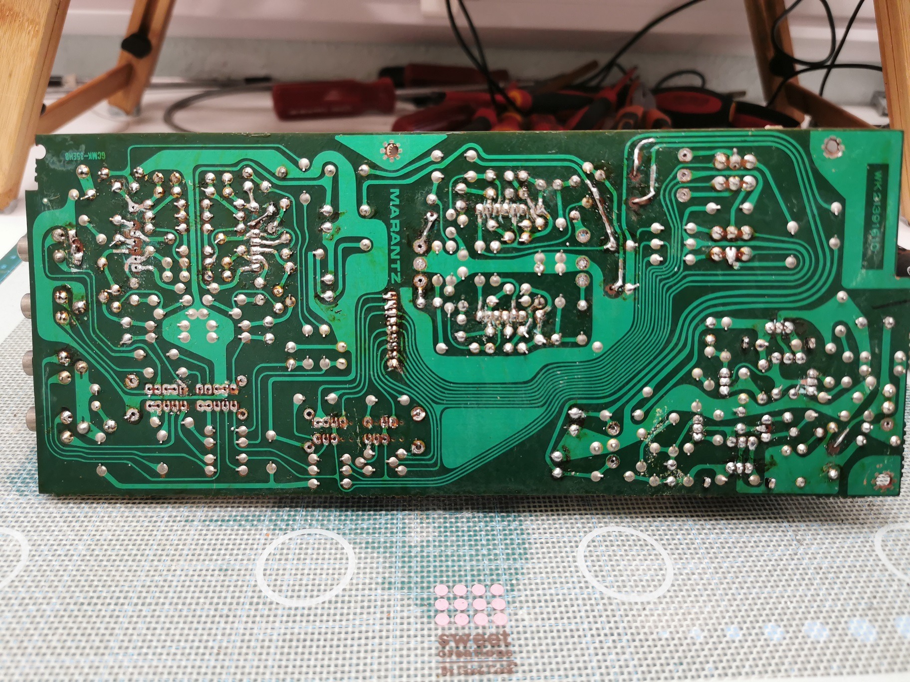

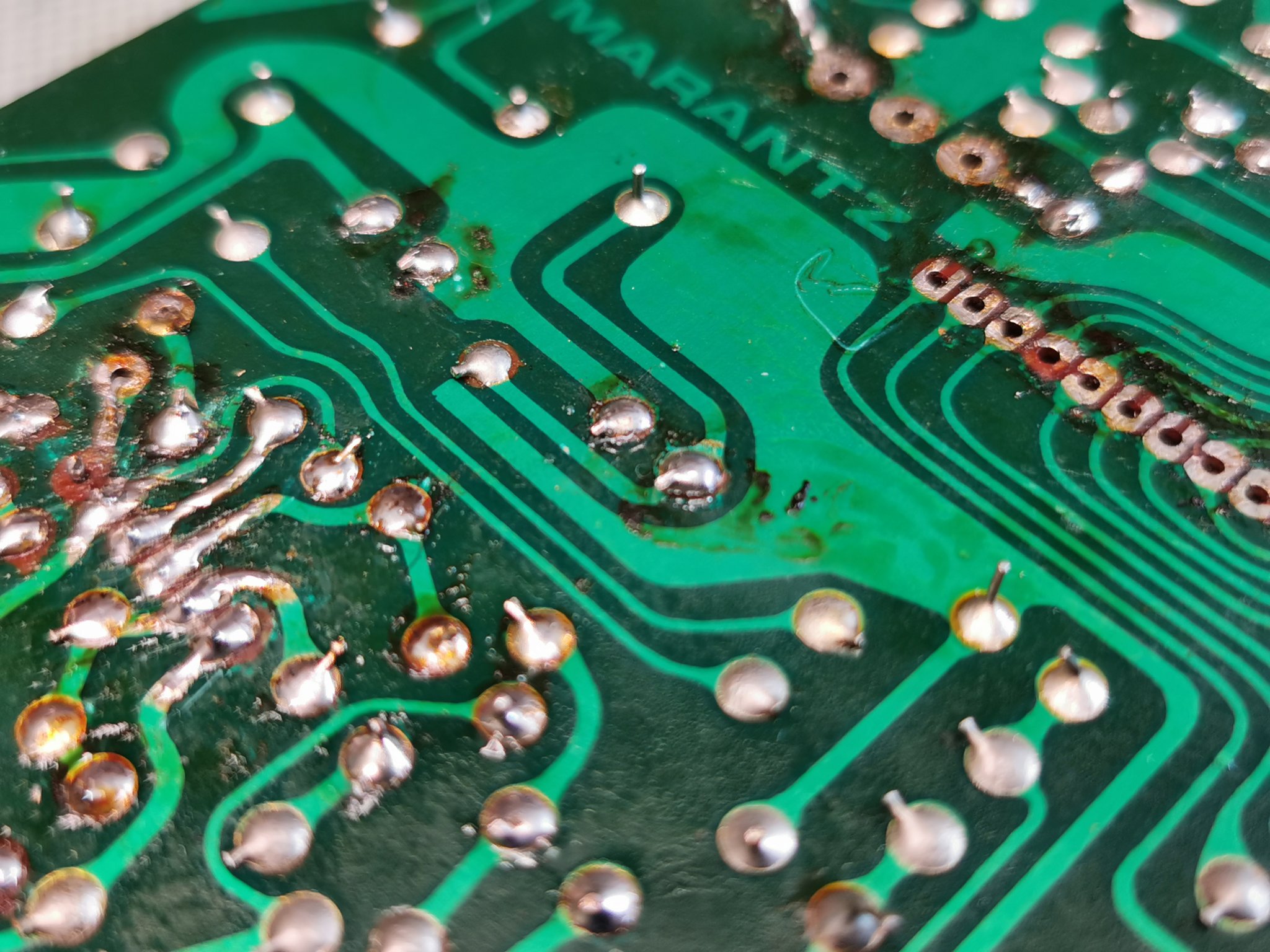

I going to test these op amps on the breadboard tomorrow so I can be sure they are OK. I De soldered half the board and found bits of print falling off, so I'm going to have to check it all. I have partial sound on one channel now so I am making a bit of progress

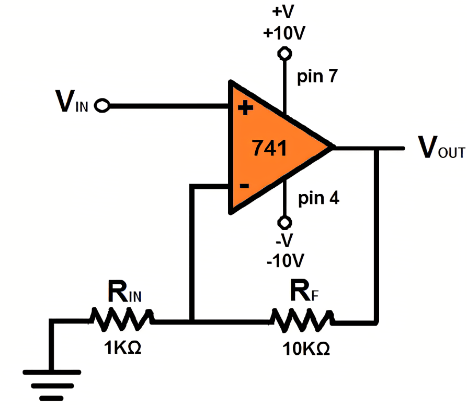

is there a way to test an opamp out of the board?
You can do basic tests by building it up into a simple circuit.
You only need 1 resistor provided the opamp is 'unity gain stable' although you will probably have to shove a small cap between pins 3 and 5 to keep it stable.
What was the type number of them again?
That's one of the old Hitachi opamps, highly regarded back in the day. It should be easy to test on a breadboard. Just make it up into a standard gain block using say 10k and 100k resistors. Add the cap for stability and take it from there.
These are standard configurations.

The board is a mess from who ever worked on it before, print lifted all sorts, so i cant realy trust what im testing, so ive decided to remove the board completely and rebuild it from scratch.Im going to be keeping this amp for myself so the additional work wont go to waste, at least then ill know its all good, and it will be easier to do out of the amp
Sounds like a plan. Opamps are generally super reliable. Connecting supplies with wrong polarity is about the only thing that will damage them in a circuit like this.

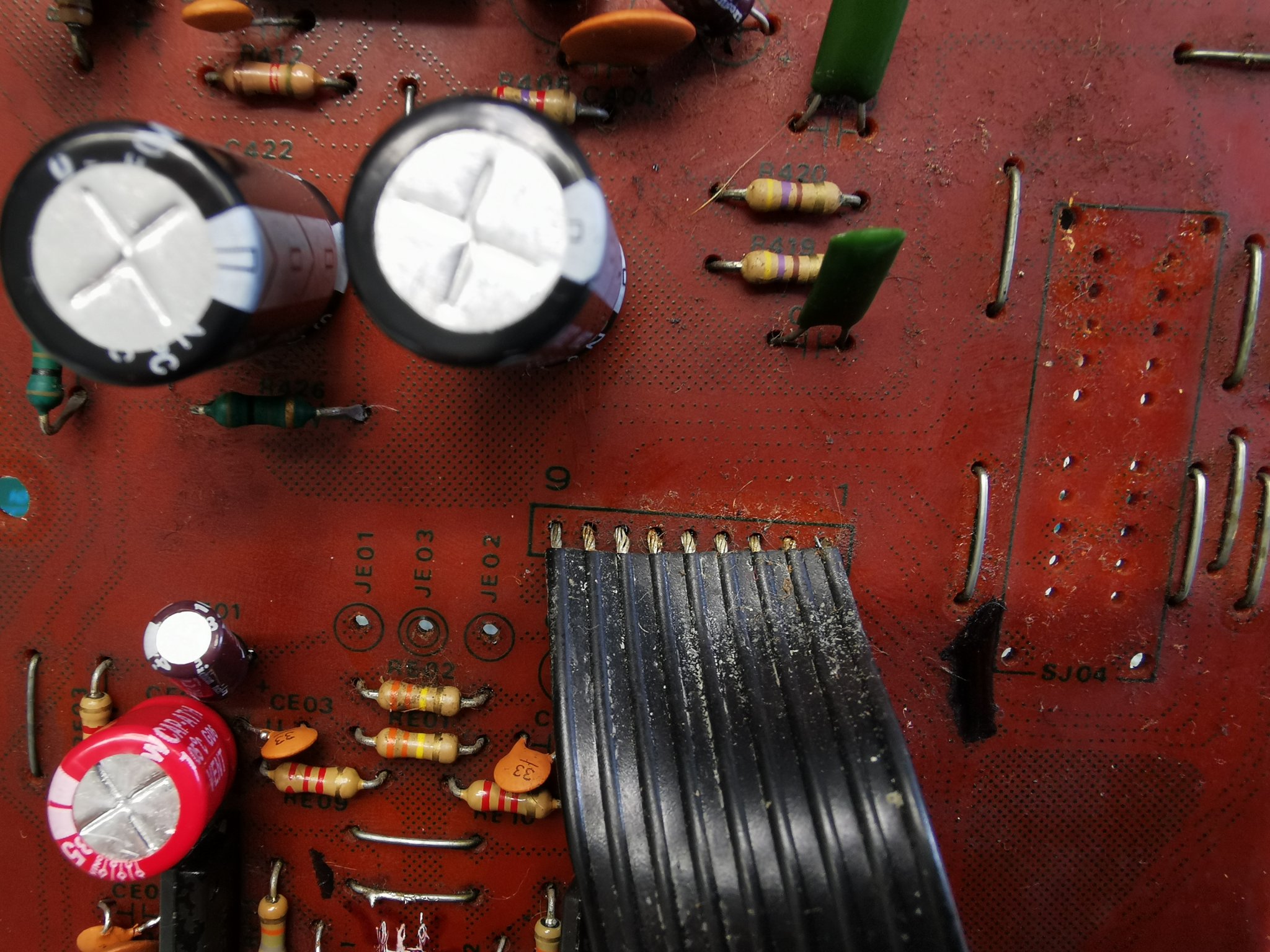

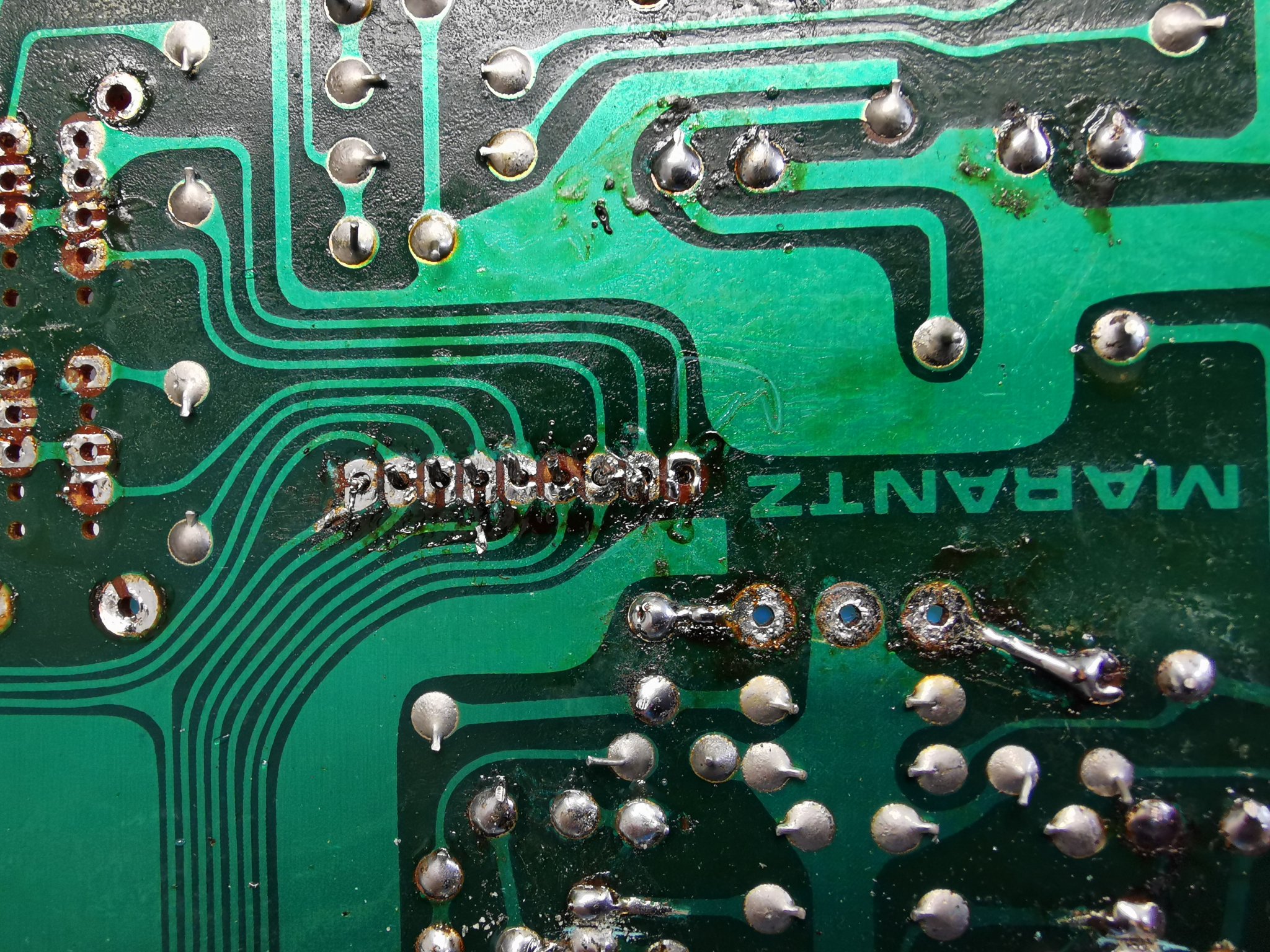

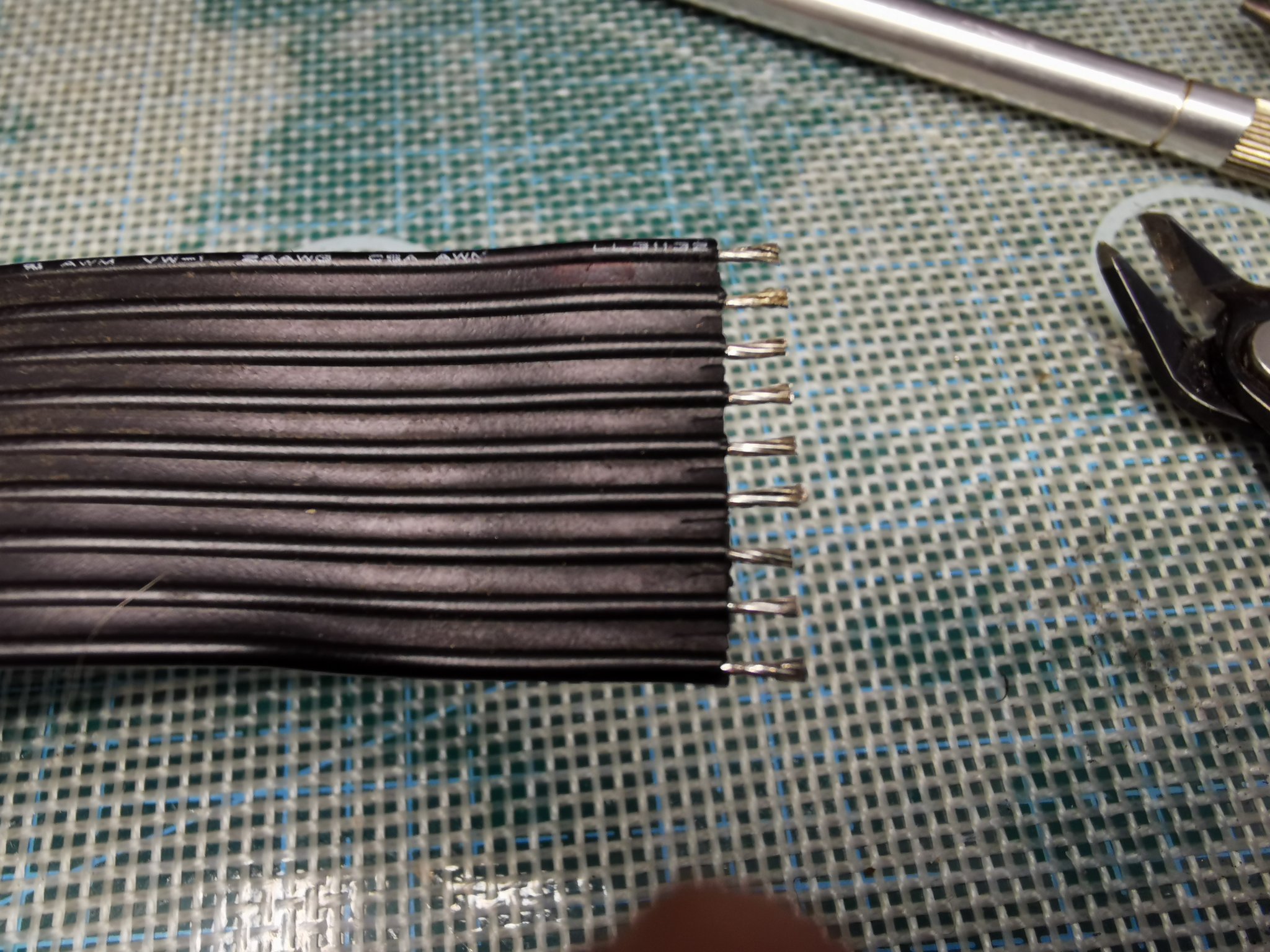

Notice how the tape connections look like they would be connected. Now look at the board, furthest right. So I removed and stripped back ready to connect back. Right in the middle centre, the cap is away from the print
so a bit of progress-board back in
not perfect but better than it was with Q401 and 2
