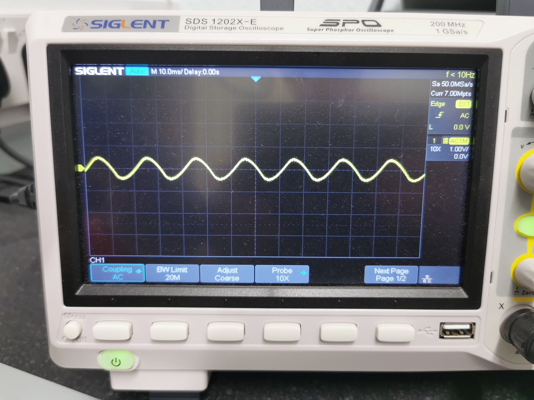

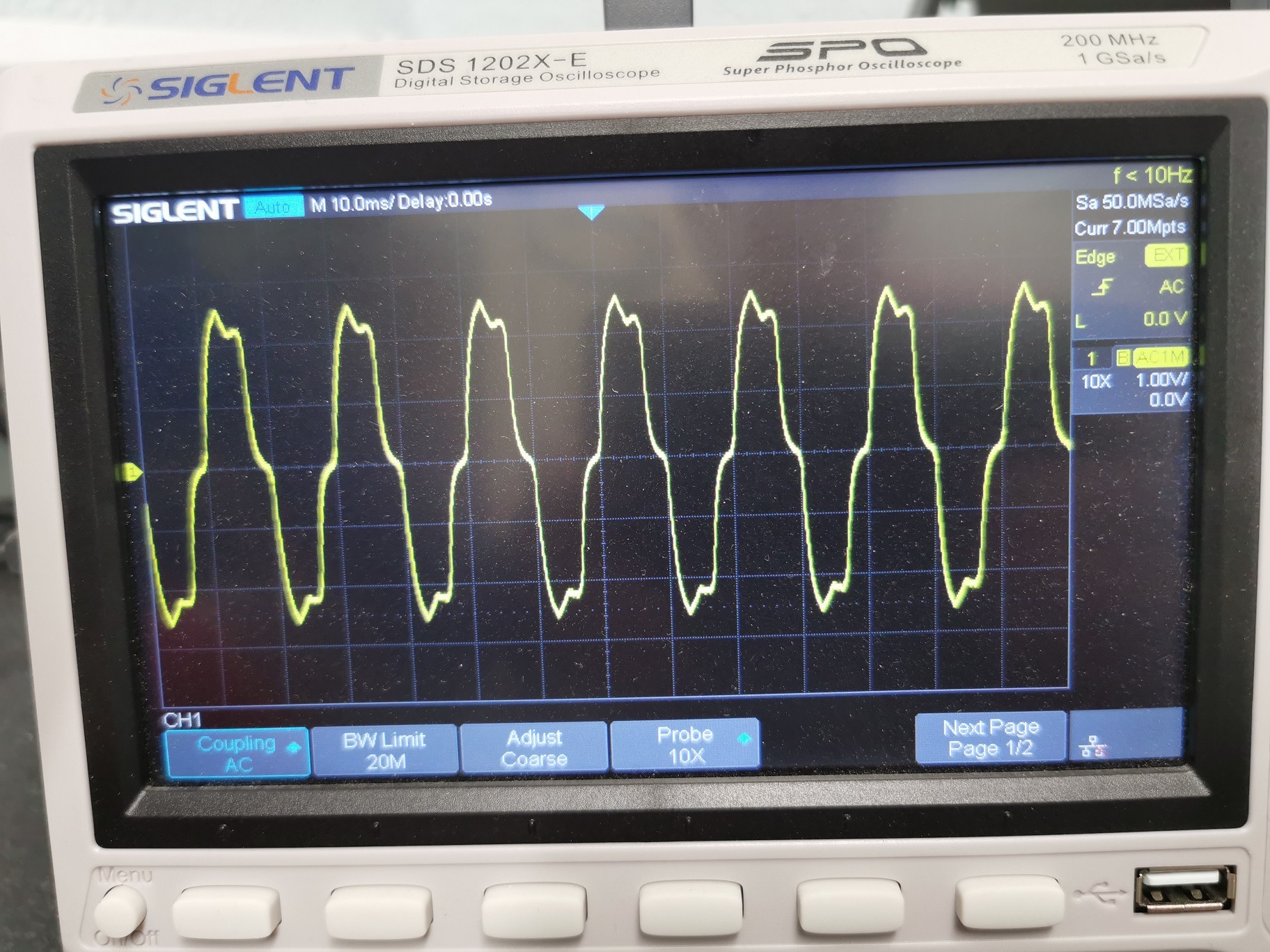

I had an issue with the second one, and although it was working , i only had 6v on pin 8, so i had lost one of the rails
so i assumed, as it was working but distorted, it was working as a half rail, and this was causing crossover distortion?
i found the issue anyway it was broken print
