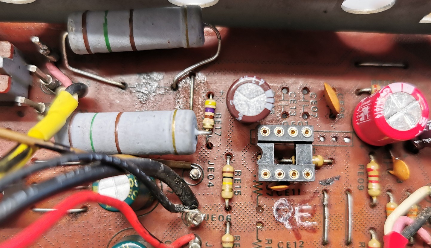

ok so there you go, it works with that opamp, so the ones i brought were,well 'no good' to be polite
rail was just a broken connection on RE19
This has been a realy worthwhile excercise for me this as it realy has got me learning and understanding better op amp operations, realy appreaciate it, thanks 👍

Well that's something 🙂 All these old parts are long obsolete and fakes are rife. The theory didn't fail... everything pointed to a problem with the chip.

why did you connect pins 6 and 7 together
what was the purpose of disconnecting CE07 and CE13 and RE07

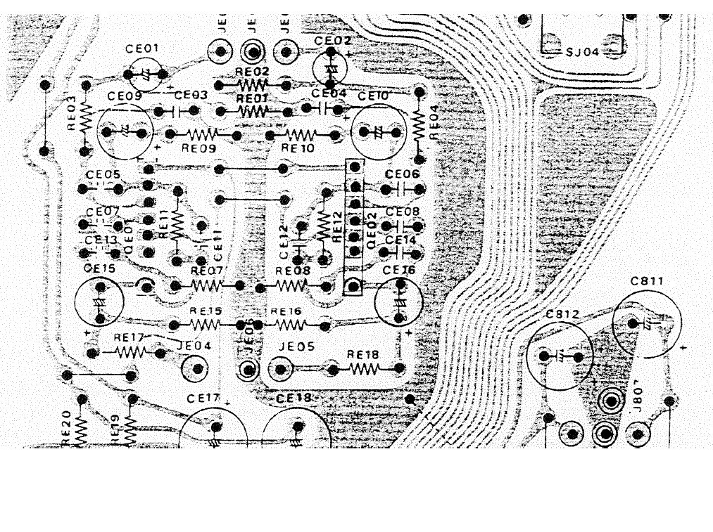

Pin 7 to pin 6 connects the other opamp in the package as a buffer (100% feedback) and tying pin 5 to pin 1 (look at the image I drew earlier) means the second opamp simply buffers the output of the first.
It is not good to leave the unused opamp not connected as it might do weird things such as draw to much current, get hot, generate noise and so on. So we tie it harmlessly out of the way. You could connect pin 5 to ground if it is nearer of more convenient.

If you keep the 5532 then just do a quick check that the voltage across the input coupling cap CE01, the output cap CE15 and the feedback return cap (which doesn't seem to have a number) all agree with the cap polarity markings. These are just small offset voltages but a different chip may give different offset polarities. The output offset on pin 1 might be a bit higher than you imagine with a 5532 but its normal when the input resistances are very unequal.

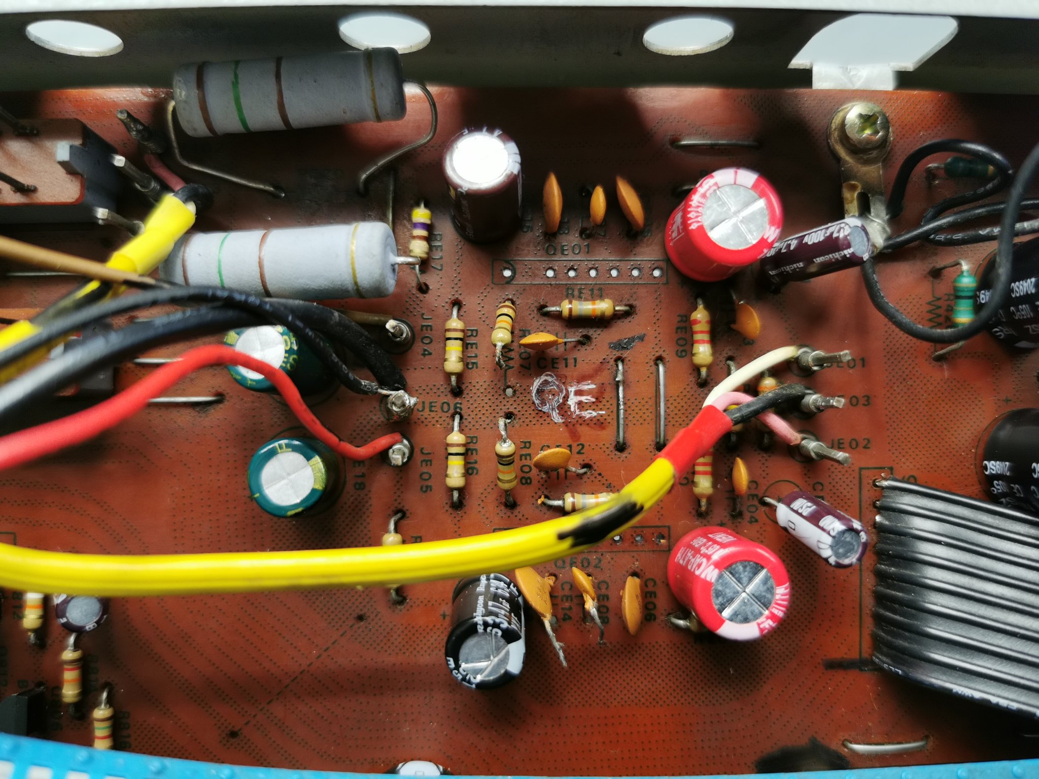

so ive decided to modify using 2 no 5532, and ill post the progress on here as I go as there isn't a lot of room to locate the bases , so it may be with or without, but it will be an interesting one
I'm sure the 5532 will perform every bit as well as the original, so yes, sounds like a plan. One thing to bear in mind if you replace several IC's is to be aware of total power consumption. The 5532 draws around 15ma from memory which should be OK for a couple of them. It may not sound much but it adds up if you replace a few. Check the regulators have enough headroom and still run cool enough.
so this is what i have to work with
I could find another new position, but i would prefer, at least to start with explore utilising the existing area if i can
I think it is possible, i just need to ensure it doesn't look a real mess by doing it.

It is really important to keep the inputs as close as possible to the original positions to prevent stray noise pickup. The 5532 should look neat enough.
