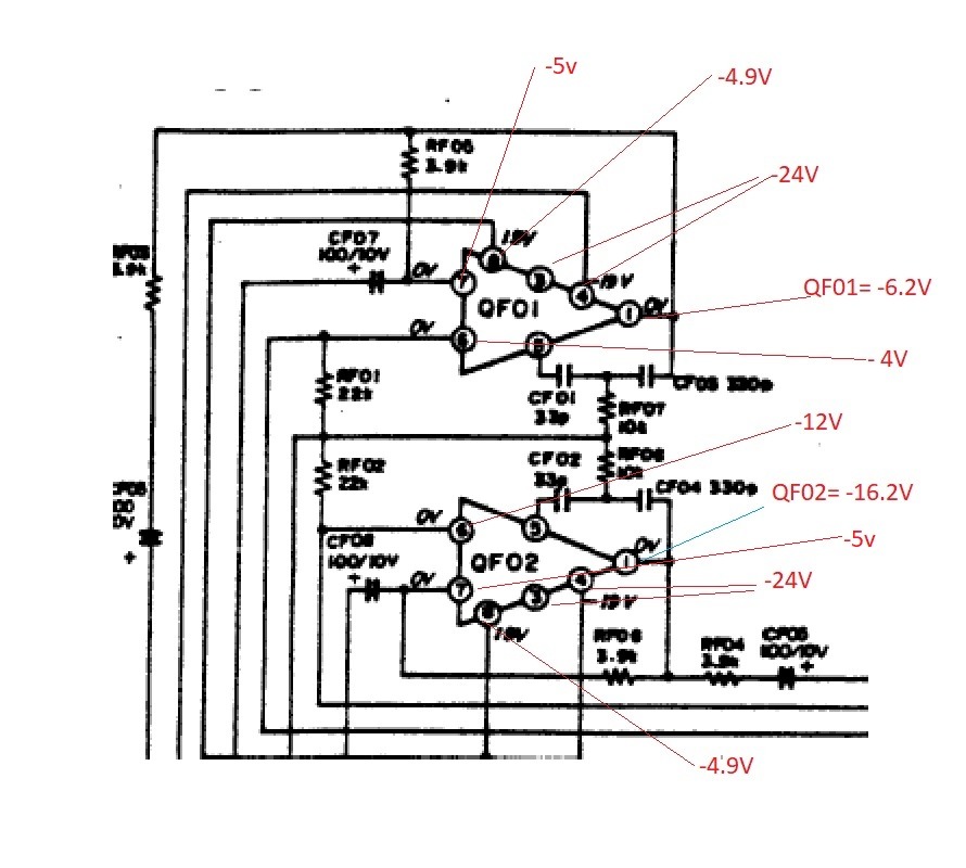

Did you measure the DC voltage at the four points I arrowed. Do it with the switch in each position. That is eight readings. Are they all zero?

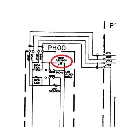

So if you engage the low noise filter, then depress the EQ defeat switch, it doesnt trip
Actually that capacitor is preventing the noise, not causing it, when the low filter is on.
The are all neglegeble MvDid you measure the DC voltage at the four points I arrowed. Do it with the switch in each position. That is eight readings. Are they all zero?

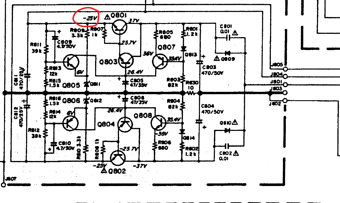

something odd i have noticed
when the EQ defeat switch is depressed all of the output transistors Q725,727,and 728 remain on, but 726 turns off untill the switch is released out again, but it turns back on before the breaker has come back in
yep there is def an issue here as im pnly getting -6v to the base of Q801 and nothing on the collector so ill have a look at that tomorrow now
i should be able to find out whats going on here.
Should be an easy to find. The diagram I have is wrong as it shows -25 volts on Q801 emitter. Quite unusual to see a half wave rectifier set up in an amp.
