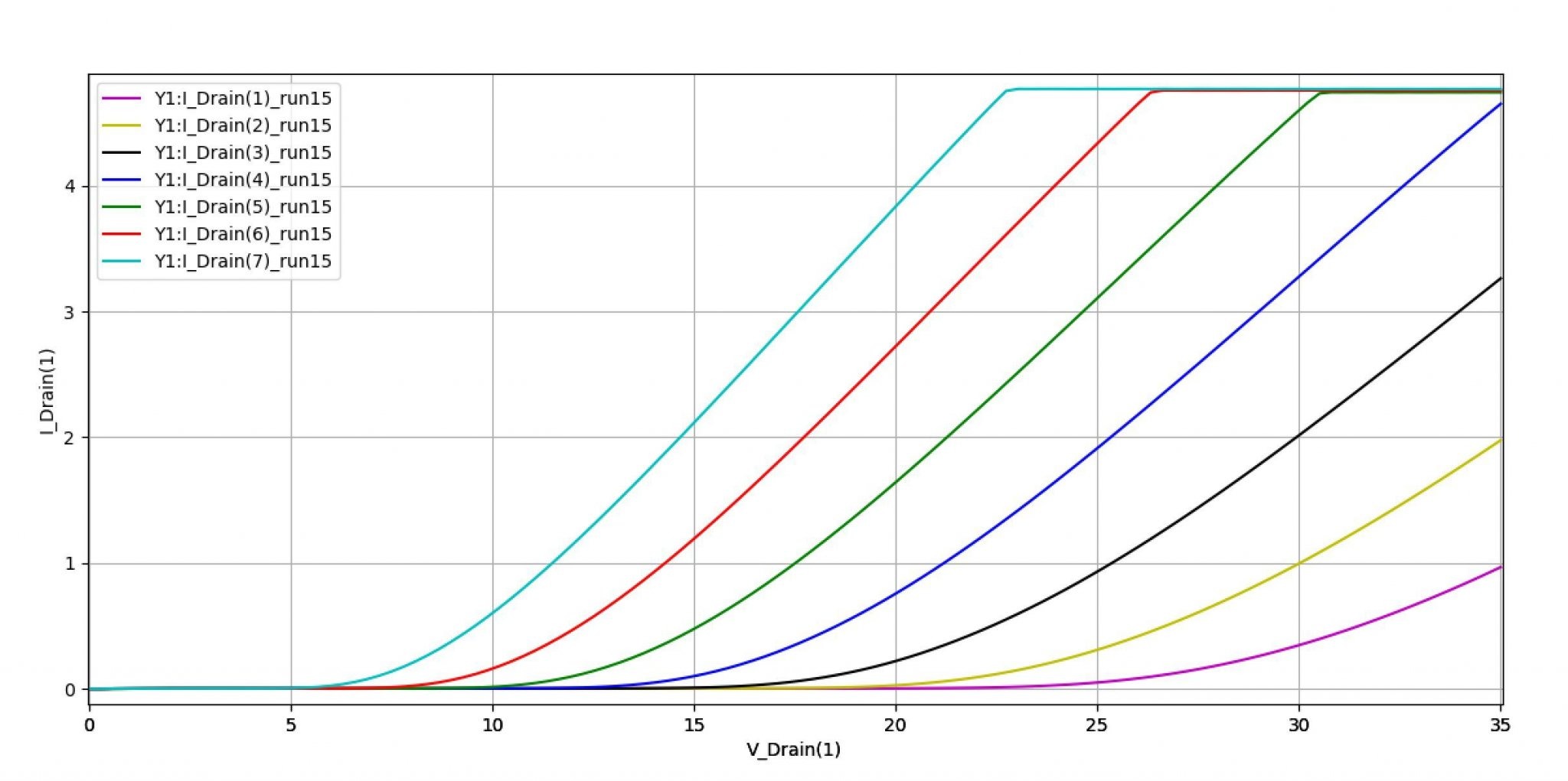

Maybe this could be a good choice for a DEF amp with irfp9240? Might be fun to try.I landed some new (to me) hardware and new software. It allows 35v at 5A.
The attached family of curves spans Vgs from -5v to -3v.

If you can define the operating point (Vds and Ids) of a potential design, I can try to match a pair and send them to you.So AliExpress cancelled my order and sent me a refund....
Just so I’m clear, is that “you bet!” (Go for it) or “ya bet?” (As in, wanna bet dummy?)
both
put it in SissySIT, and inform us

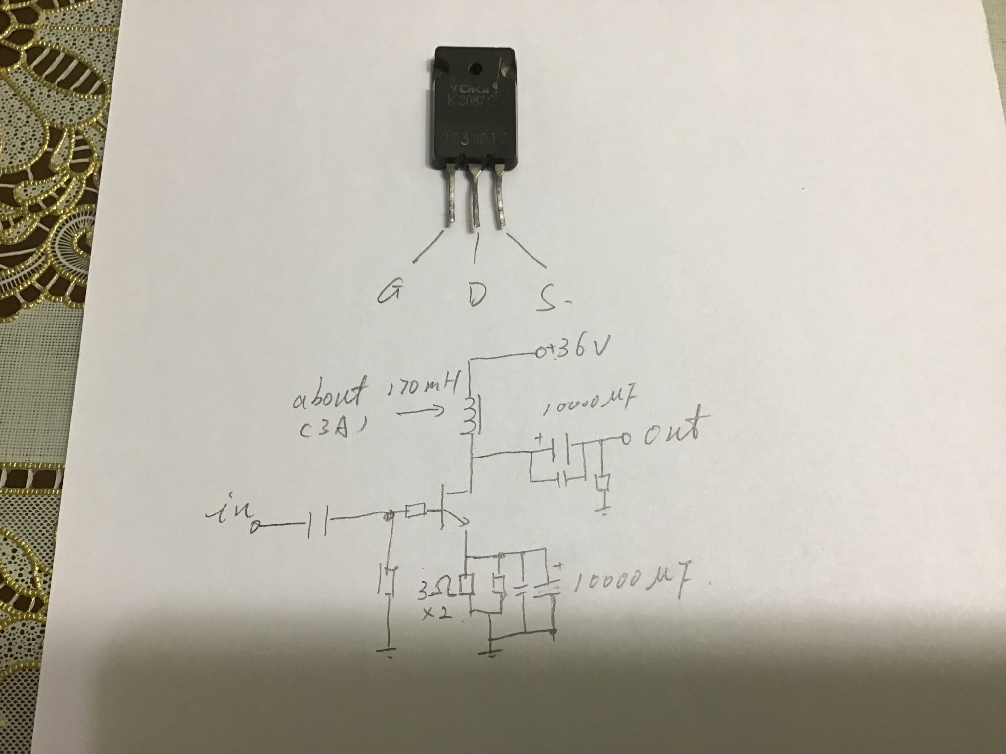

safest bet is to measure Ugs for 20V(ish)@1A8, re-calc/recheck value for level shifter resistor and that's it
show time
Thanks ZM, sounds like a plan!
can those who’ve played with these parts confirm the pinout? Logo up, pins down, G, D, S. Sound right?
my test sch:Sounds okThanks ZM, sounds like a plan!
