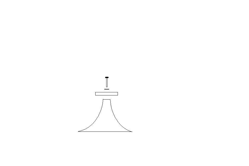

One more idea for a mold made of metal that can be used to produce a glass-reinforced plastic waveguide:
There are basically two parts that are screwed together. Then resin and fiberglass is applied in layers by hand. After curing the two parts are simply screwed apart.
The drawing shows how screw nuts can be included so the final waveguide can be mounted with tight tolerances.
Best, Markus

This doesn't solve the shrinkage problem and in fact may make it worse.
Things like this are never as simple as they appear until you try it.
We tried embedded molies in the fiberglass, but gave up as the shrinkage moved the locations and then the molies were in the wrong places and useless.
Of all the processes that I have tried the one that I am using now appears to work the best. Thats because I CAN get (and have) perfect parts this way, although they don't always come out perfect. But the fact that it can be done means that with time and further refinement I can get the process to one that is repeatable and accurate. This is why I simply don't understand all this talk about changing it. I have no desire to change it only to improve the existing one.
I learned recently that the activator settles and can do so in days. Thus it has to be agitated before each mix. And that the material cures too fast and that I need a different activator which will allow a slower cure, resulting in less heat and a better repeatabilty (less dependence on ambient temperature and humidity). Each time I make a baffle it is better in most ways than the previous one, but often with a new problem to fix.

metal mandrel
Best, Markus
This is pretty much what the shape of the bottle top section I'm working on as a proof-of-concept for all doubting Thomas's...
Stay tuned... first will be in copper, maybe with a nickel backup... then who knows
metal will solve many of the dimensional stability issues... since the technique is mature and widely used for ultrahigh precision fabrication of complex shapes
Best, Markus
A more "commonly" use method is to simply glue the parts together
But its not very hard to make a 2-part mold consisting of the waveguide mold and on top the mold fore mounting plate part
Before laminating the 2 molds are screwed together with a little clay in between
Another advantage from this is the maintained precision of throat
Picture shows the 2-part mold
