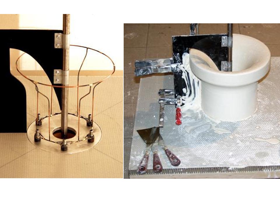

gedlee said:
John
I have had a lot of trouble with molds like that. Mine never lasted more than a couple of pulls. I've had them fail first time. How did you get 20-30 from something with Bondo at the surface? And what did you do with 20-30 waveguides?
I've built 20-30 horns and waveguides. I've only used molds for the past few years. Until five years ago I'd build horns out of paper, using the same method described on htguide to build molds. Basically make the horn out of paper, then glass it. The inside of the horn is smooth (because it's paper), which is where it counts. The outside of the horn is a mess, because it's fiberglass.
When I say "paper", I mean cardboard comic book backing boards, which are a smooth sturdy paper stock, a bit heavier than the cardboard you would find in a cereal box. It's flimsy enough to cut with scissors, but strong enough not to collapse.
The way that I keep my molds from getting trashed is that I cover the mold in tin foil, then pull the tin foil away from the mold. The tin foil then becomes part of the waveguide.
Of course you have to use a lot of bondo on the waveguide then, because foil is too rough.
This method is good if you're making two waveguides, but too labor intensive for anything more, since you spend a lot of time applying bondo and sanding.
I missed the tin-foil trick. I have found that the heat from the curing resin trashes the bondo very quickly.
I've use the glassed-cardboard myself - almost 30 years ago! My first loudspeaker enclosure for a car was done that way. Cobble up a box that fits and glass it. As a newby at Ford my boss was quite impressed with my resourcefulness.
If I trashed a mold, I'd kill myself. I don't think these people understand how much work it is to make a mold. I spent about 40 hours making a mold that's one-eighth the size of the summa waveguide. I literally WON'T allow my molds to get trashed.
So tinfoil isn't easy to work with, but it keeps the mold from getting ruined, for sure. Of course you then have to waste HOURS applying bondo to the waveguide.
Just not acceptable unless you're doing one or two.

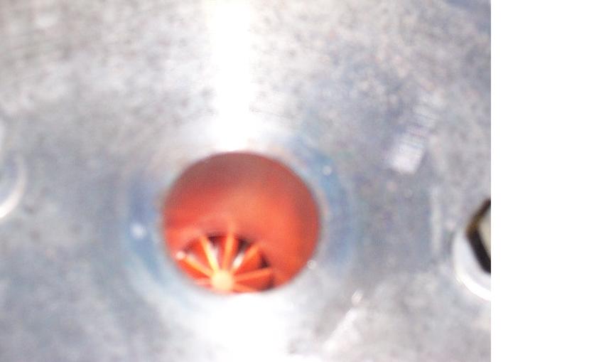

Altec 902-8B physical properties
Although I lack precision instruments, I took a look at the Altec 902-8B.
The 'exit angle' is 6 degrees measured with a protractor.
The final exit diameter is .88 inches (probably called 3/4") measured with calipers. This is with paper and screen removed.
It seems that with this driver, the only way to truly match this exit to a throat is to remove the paper and screen, as the actual exit point is inaccurately depicted by all that mumbo jumbo.....

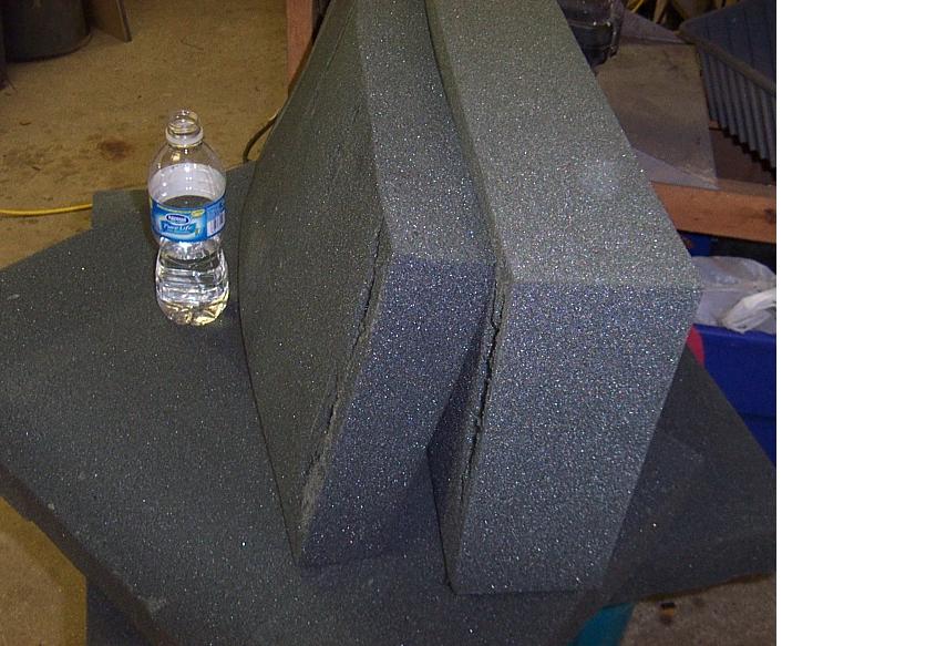

MartinQ said:
Blow air through it. Closed cell foam would be air tight.
on the thinner pieces I can feel a breeze thru it using compressed air. On the thicker stuff, it takes the air in and feels cooler all over....
inertial said:
Hi
Water. If it is open cell it absorb water like a sponge :)
cheers,
Paolo
dunk it in the pool and it comes out 100X heavier...
A recent pic posted on the Nathan thread of the exit of the B&C driver prompted me to post this. It is The Altec 902 and is a totally different animal than the B&C. Actually it seems that the Altec will be much easier to accurately match up......
Just read the last few posts. Reticulated foam does not hold water - it runs right through - that's why it's used for outdoor furniture upholstery and filters.
That picture posted a few entries above has foam with too many 'shiners' and those are cell walls which have not been blown out. All that's left in reticulated foam is the edges of the cells.
That foam above looks like the sort of stuff used for camera cases and it would probably be great to put on the sharp edges of enclosures to kill diffraction effects.
