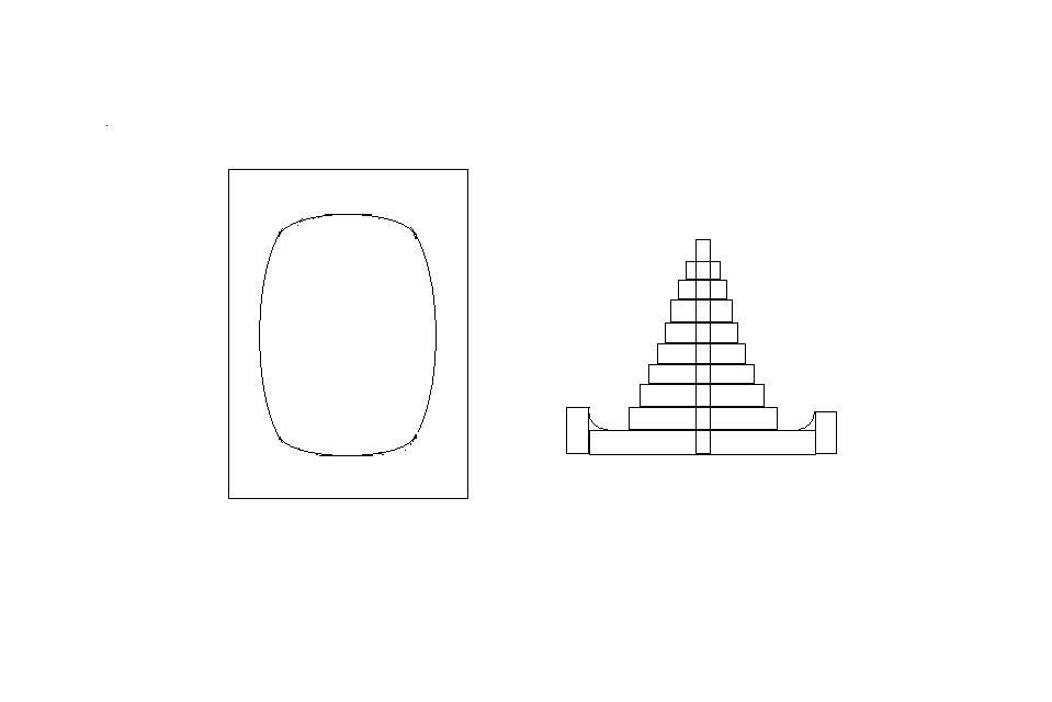

Thinking about this way to make a "mold"
Its kind of chinese
A long stick is mounted in the centre of the baseplate(mouth) and the other end of the stick is throath
All the other "plates" have a hole in the centre to match over the stick
In this way its possible to dissmantle to work on the "plates" individually
Eventually its all glued together and finished with filling plaster
Its kind of chinese
