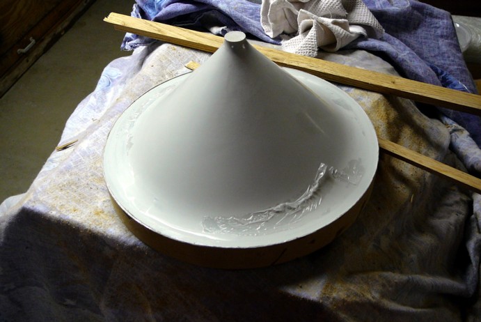

PVA is indeed just a mold release.
first you wax, then you spray a fine mist of PVA onto the mold. the pictures above are showing the gel coat, not the PVA (which is under the gel coat already if I infer correctly).
the PVA is thin stuff and shouldn't print onto the part surface.

Kim Schultz said:Here´s a picture of the wg, I think it´s a beauty
It sure is Kim. Very nice.

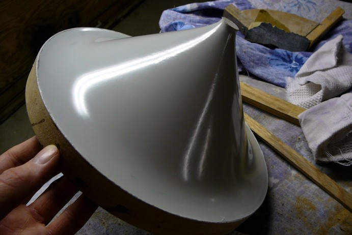

I decided to make a new mold as the first one was too unreliable to use for making more wg´s.
It turned out extremely nice.
I wet-sanded the wg with 400 then 800 sandpaper and applied 5 coats of wax, and one coat of pva.
Then one coat of gelcoat and some layers of fibreglass.
The mold popped right out of the wg.
This is a picture to show the film the pva makes.

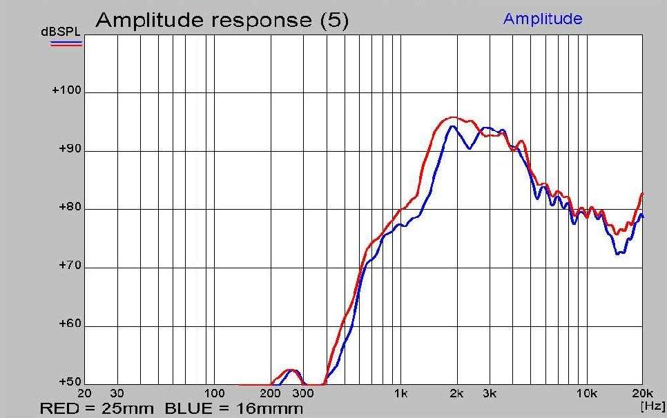

Now I´m finally back to the WG´s, I got a bit sidetracked with my new hobby slotracing
I´ve changed the first mold to 25mm / 10 degrees throat, to see if it really helped anything modifying the BMS driver.
And guess what, it measures better with the unmodified driver so this is what I´ll use.
The RED curve is the standard BMS driver with 25mm throat, and the BLUE curve is the cut down version having a 16mm throat.
