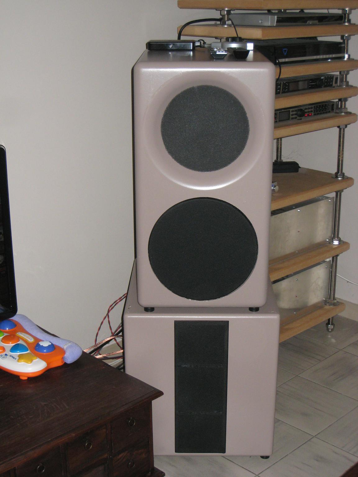

I also did something like this a while ago when I bought a pair of geddes 12" waveguides and was building the speakers attached in this picture. I have attached the document as a zip file. I copied information from severall threads, and made sort of a FAQ-document. I hope the original posters do not have a problem with this document. I tried to add their name as much as possible, but sometimes I forgot.
Have fun reading (it is still 34 pages long).
Wim, that's quite an effort! Thanks for sharing. Is that all taken from "Geddes on waveguides?"
Data was taken from severall threads:
Geddes on Waveguides
DIY Waveguide loudspeaker kit
Jean Michel on LeCleac'h horns
Horn vs. Waveguide (I think, not sure anymore)It was made about a half year ago. I have followed these threads since, but did not update the document anymore (to busy building the speakers).
