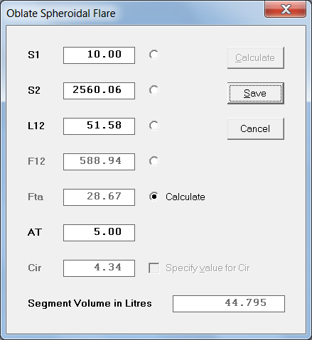

So anyway, does anyone have the explicit equation for the axisymmetric OS profile that provides a tangent opening to a variable driver exit angle? I remember Mr. LaFontaine posted it somewhere but I am having the darnest time trying to find it... All the other equations I have start with a 0 degree exit angle.
The Horn Segment Wizard in Hornresp will do all the work for you. Simply specify the required tangent angle along with other selected input parameter values (there are a number of options to choose from), and then export the schematic diagram horn data. This will give you the profile information you are seeking.

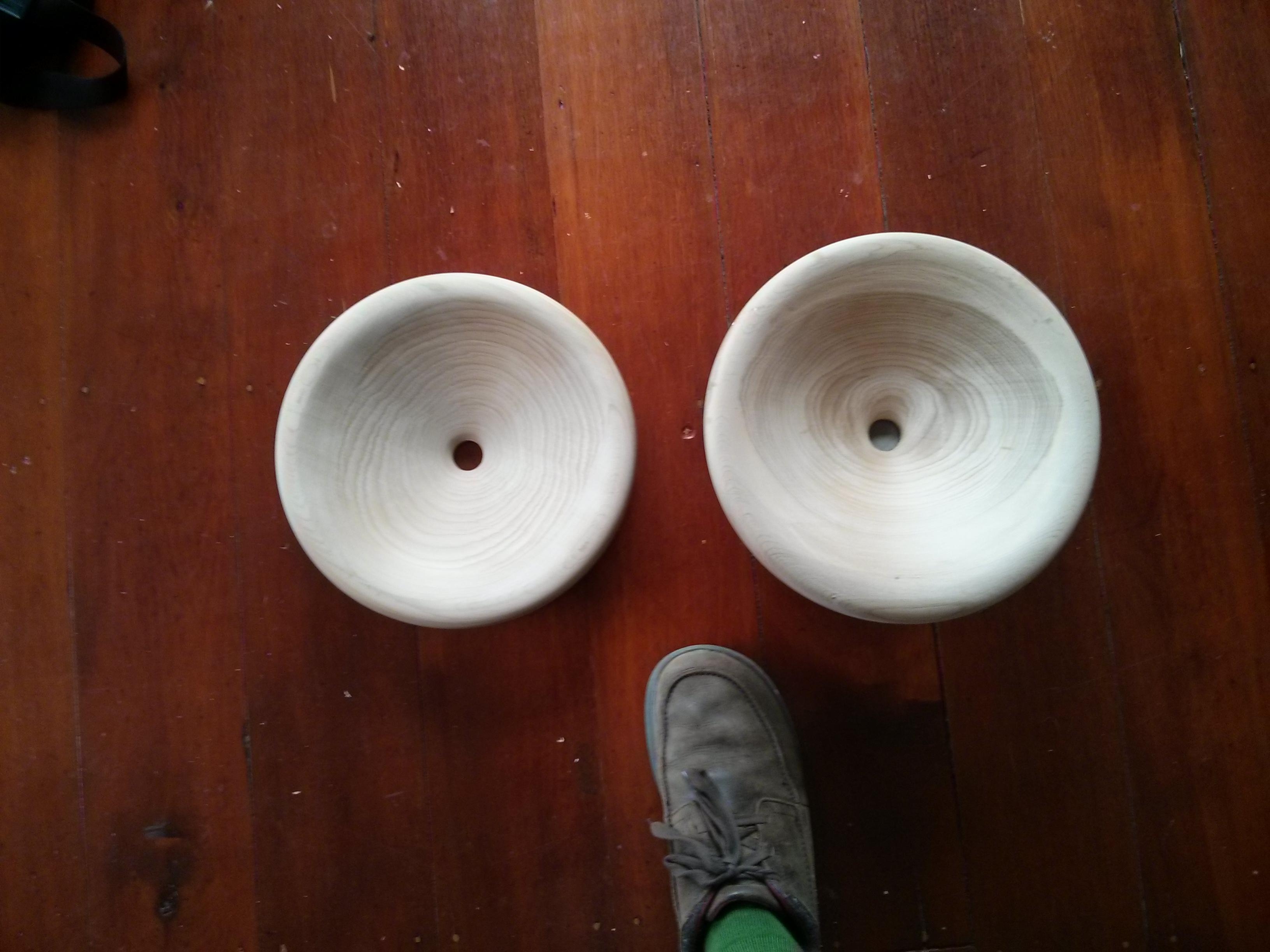

Just thought that some of you might like to see what I've been up to with a lathe, a couple of big blocks of wood, and a pair of Beyma cp-380 1" compression drivers. Since the photos, I've applied a couple of coats of Danish oil.
They were turned to an oblate spheroid profile. I use them from 10kHz and they are run off of a single-ended 45 amp. They don't have any fancy foam on the rims to cut out the higher-order overtones. The critical throat area is cut by hand and doesn't fit my template exactly, but it is pretty close.
Without a doubt they aren't on the same hifi audio level as some of the waveguides others of you are producing, but the sound of them certainly floats my boat. They take over from Fostex 206en tractrix mid horns that I was previously running from 250 Hz upward. The new tweeters provide tons more well-behaved sparkle.
Sorry about the terrible photos.
