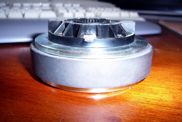

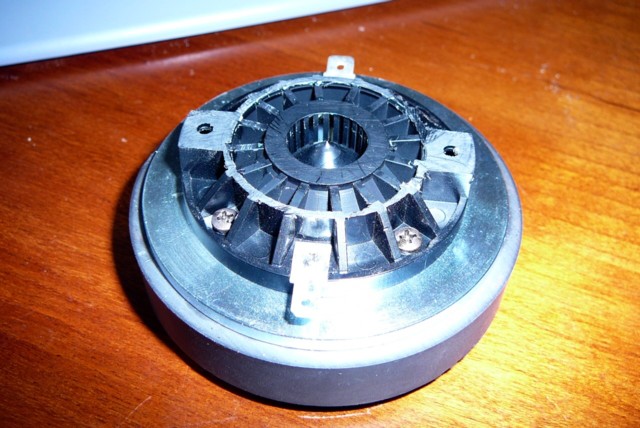

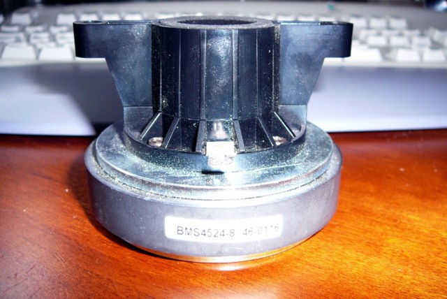

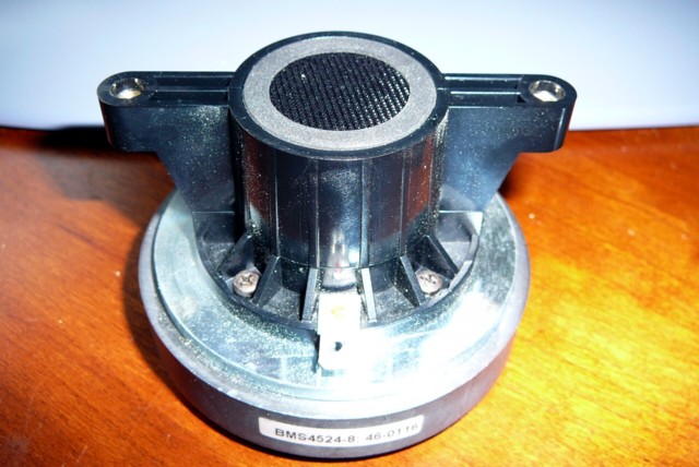

Hi.
Yesterday I decided to chop up one of my BMS 4524 drivers to get rid of the 10 degrees "tube" in front of the driver.
I think I read somewhere Earl Geddes think this would improve performance when used with a wg.
But what throat angle should I make the wg ?
My gut feeling says to make it 0 degrees, but I want to be 100% sure before I make the mold.
Here are some pics of the modified driver and an unmodified one.

The waveguide should start right where you have cut it. There shouldn't be any extension at all.

No, I think that you misunderstand. The walls are not straight at all, anywhere. There should be an immediate waveguide with an OS contour, which asymptotically approaches the design angle, but never quite gets there. The initial angle in the equations would be 0 degrees, but this instantly changes, so I was not sure what you meant.
Thanks for clearing that up 🙂
It didn´t make sense to make the throat angle 45 degrees, because then it would just be a conical horn.

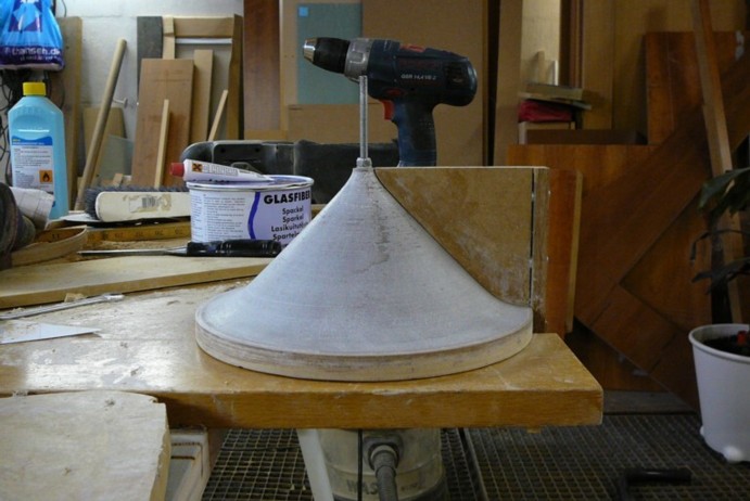

Here is pic. of the progress I made yesterday.
I started by making a printout using a corrected John K WG OS 2 spreadsheet.
When opened in Openoffice it´s pretty easy to scale it to exact dimensions and when printing on my Canon printer it´s dead on.
Then I cut a large mdf disc the same size as the wg mouth, and some smaller ones ending up with the throat piece.
I then made a template after the printout and started plastering with polyester filler.
Today I´ll get some filler that hasn´t fibers in it, that is better for a smooth finish.

gedlee said:Looks good - that is the way its done. Thats a big waveguide
This is actually only 4" deep, remember it´s for a 16.5mm throat driver and not a 1" driver.
If this goes well, I´ll try some bigger molds next.
I thought about making a steel copy of the driver mouth and using that to correct the waveguide throat to an exact fit, that way I don´t have to use the driver and risk damaging it.

I made some progress yesterday with the filler and painted it a couple of times with primer. Today I should have the final coats of paint on it.
Now I need to find some wax and a release agent.
Do you know if silicone oil could be used for this ?
