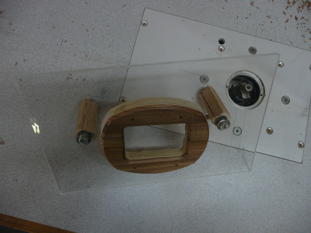

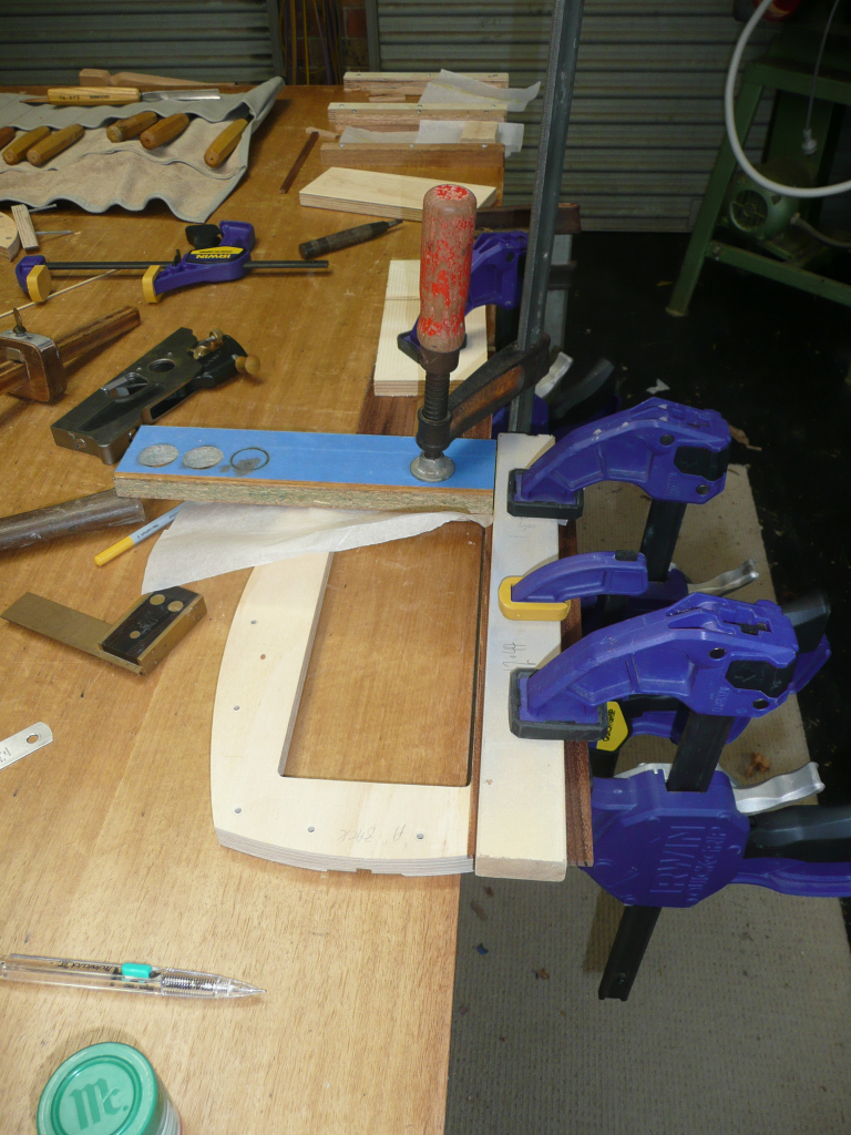

What a guy could try is reversing the feed of the work in those areas. Get a good hold on the work as the bit will want to climb out of the cut. Last, light clean-up pass should be the regular feed direction for the whole piece. Try to cut your end grain sections first. The pass on the long edges will clean up minor break outs this way. ... and you're moving too slow. Scorching will result if you dwell in spots. Keep the piece moving or get it out of the cutter. Takes practice. Use some candle wax on the bed if that is adding additional drag to the piece you're machining. The work piece should just glide along without any effort.I have cut Tasmanian Blackwood to about 5mm thick & laminated it on the front face. Unfortunately when I route the curve on the edges the grain gets raised in the sections that the router bit is running against the grain. There is no way of avoiding going against the grain. I am using a brand new bit but still the grain gets raised & dug out.
I will try modifying an old bit tomorrow to see if I can improve things. As yet I have not cut the full curve. I was hoping to avoid using too much sandpaper as it will take the crispness off the curve, but I don't think I will have much chose.
The plywood edges will be black at the end of the day.
What I REALLY hate is having my fingers so close to the router bit when I'm curving the head section, scary stuff
Don't fear the bit ... respect it.
Puppet
All very good advice especially the "Don't fear the bit ... respect it" I have tried what you recommended, as I have been doing this sort of thing for a long time. Unfortunately it's the nature of this timber. this morning I am going to try & sharpen a bit with a shallower cutting angle to try & reduce the tearout.
Thanks for the advice, I will try & "respect the bit", it seems the older I get the more nervous I'm getting with this sort of thing, 37 years of doing this sort of thing & only bumps & scratches to show for it, I don,t want to ruin my good record, I like my fingers as they are 🙂

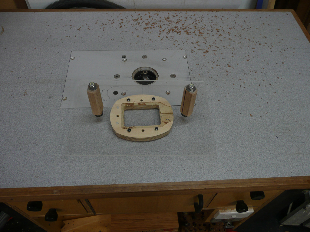

I decided discretion was the better part of valuer, so I made a holder to protect my fingers while rounding the head pieces
Good thinking. Small effort if you save your fingers this way.
The accidents happen with small pieces of wood than you have to be smart not cut your self for such a worthless small piece.

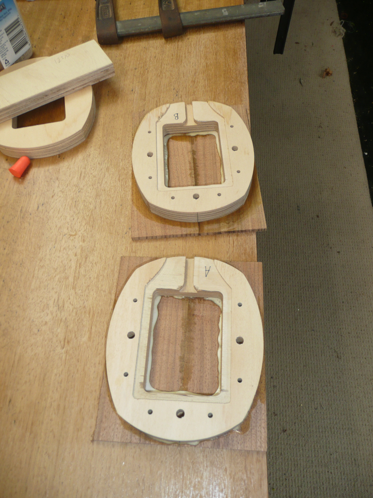

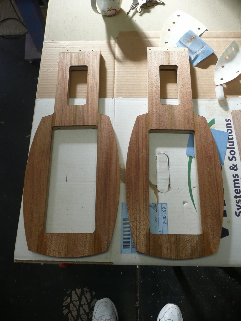

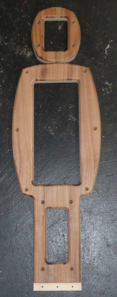

All routed, drilled & ready for sanding.
I tried to think of a way to invisibly join the two half's, but in the end had to surrender & go with screws that will show in the back half. I did come up with one method, which was using the rare earth magnets fixed into both halves & dowels for fine alignment but figured all those stray magnetic fields would probably be detrimental to the speaker performance & you would probably never get them apart again
