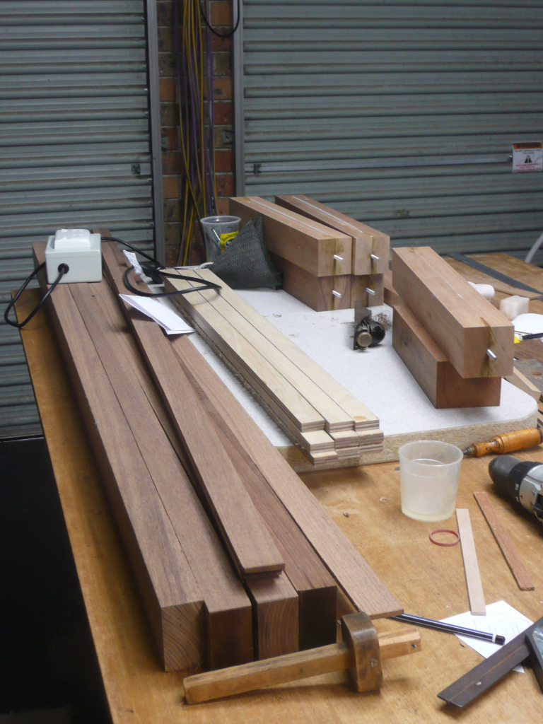

I'm thinking maybe the leg is a little too fat.
Nice craftsmanship David that leg respect.
For the looks a simple square one looks better I think, that is my taste clean simple. Spikes in the foot of the leg will make a cool impression.
I'm a curvy sort of guy 🙂
No way. Any thinner and it would look insignificant. You don't want it to look like a skinny dining table chair leg do ya?
I only mean a little bit, but I take you point. There is a slight flat spot near the top you can't see, I'll make one more test piece & make my mind up from there.

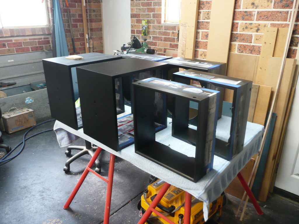

I have sprayed the base boxes with 2k primer, the next step for them is to spray them with K&H Bumper Texture coat & then with automotive acrylic enamel. The color is from an Alfa and is called Bronze Metallic.

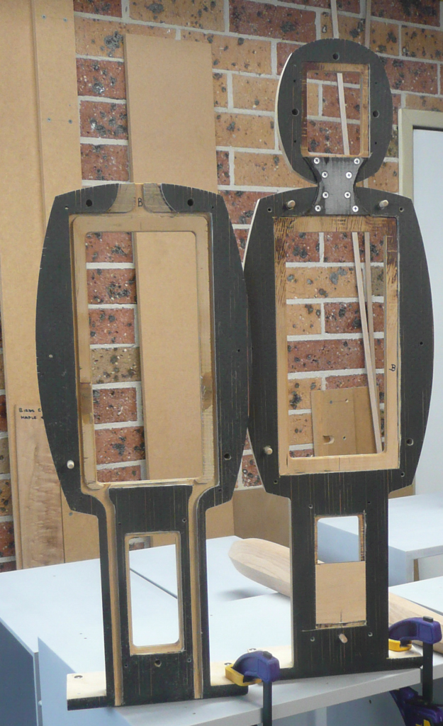

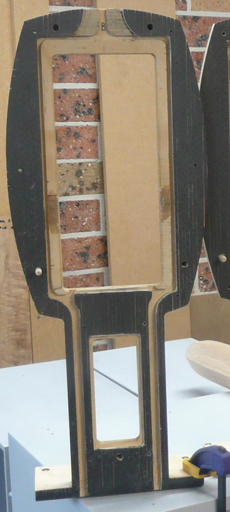

I have spent the last day & a half joining the Mid driver section to the tweeter driver section, it turns out the CNC router didn't cut the recesses as I expected, it was surprisingly difficult to get everything to line up properly.

I still haven't decided what to do for feet, the speakers have to be about 35mm off the floor to accommodate the speaker connections which will be under the bass box, spikes are out, I'm not a fan.

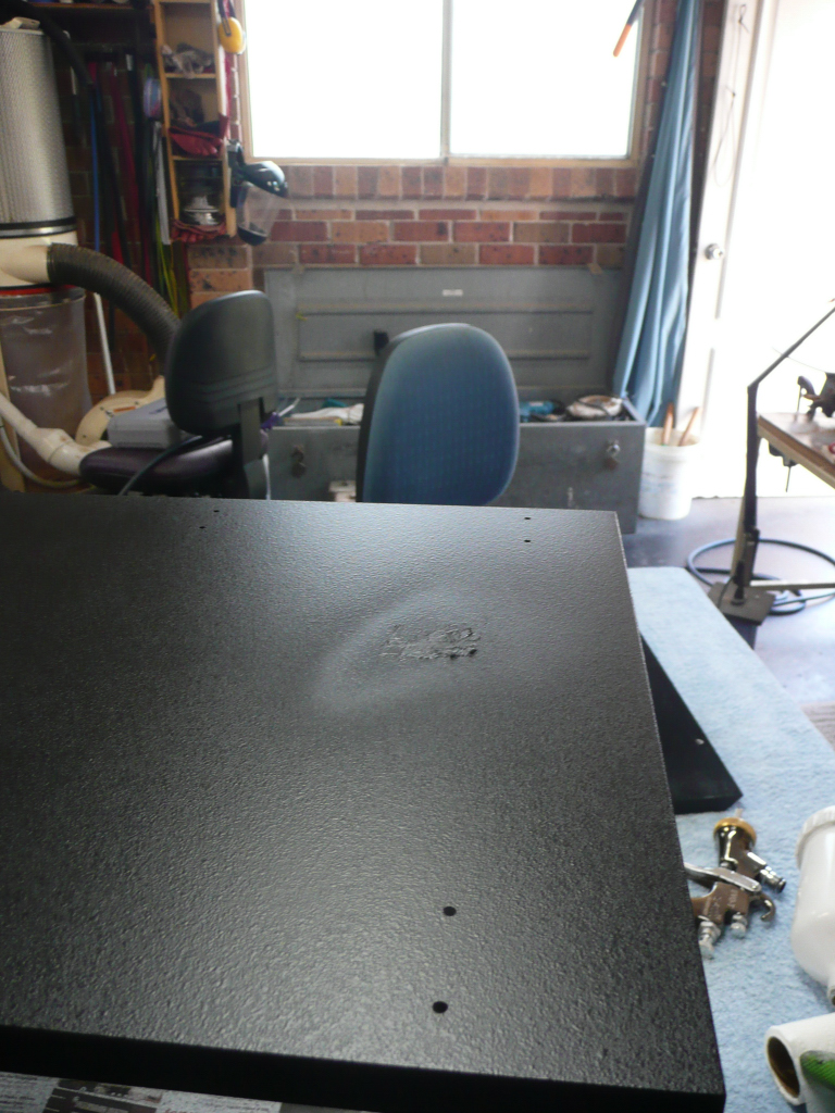

I had just finished spraying the texture coat on the base boxes when I found a blob of something on one of the sides that was still wet, and of course it wasn't on the bottom. Initially I managed to get get most of it off, but when I tried to get that last little bit off, it turned into the disaster you see in the photo. There's always tomorrow I guess, I was hoping to spray the topcoat tomorrow.
Its a prick when something like that happens .What was it a peice of unmixed product in the paint .
What you really need to do is strain it through a filter into another container then pour it back into the can to remove contaminants .
I roll masking tape back on itself to make it double sided and press lightly on the foreign particle to remove it . But you need to do this while the paints wet .
Looking really nice David .
Cheers
Mal
Cheers
Mal
Cheers
Mal
I'm not sure what it was, it was too large to have come out of the gun & it wasn't wriggling so it wasn't a bug, it was just a piece of bad luck 🙂

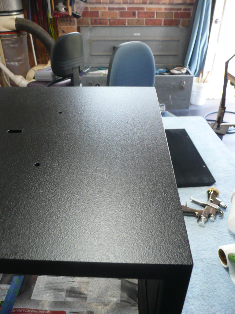

I did the respray today & am happy to report all went well.
Originally I was going to spray the colour coat on all surfaces but have decided to only coat the outside of the large boxes as that is all you will see once the grill covers go on.
Getting a good coat inside the boxes is a real challenge.

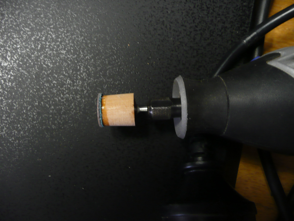

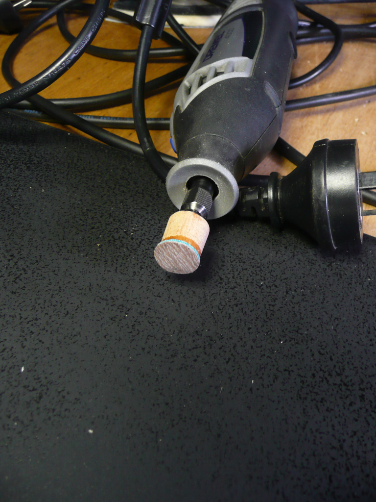

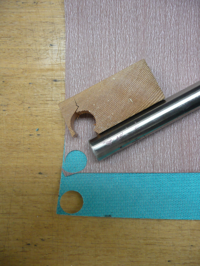

While I was at the auto shop buying the paint I saw this De-nibbing tool & sanding pads 3M? Perfect-It? Denibbing System - YouTube, great idea but a bit expensive so I made my own which I will use in my Dremel.
I used an old dremel bit, Araldited on a Western Red Cedar disc, which was cut using a sharpened piece of SS curtain rod, I then sanded the disc so it was perfectly round, coated the end of the in Araldite, stuck on a piece of self adhesive hook & loop, cut a disc of P1500 grit hook & loop paper & $350.00 was saved, the $350.00 doesn't include the pad larger disc sander in the clip. 🙂
Cool , how about the foam between the sand paper and the arb .Have you used it yet ,make sure it doesn't run off across the job with something hard like the red cedar as a cushion.
Theres some great little tools out there .
CHeers
CHeers
CHeers
Hmm, maybe there is a design change in the offing, I probably have a bit of foam somewhere.
The Velcro does add a little bit of give, I have tested it but not on the actual finish, I was thinking of making an even smaller one, there is a couple of minor dirt flecks that I could sand out before the finish coats.
