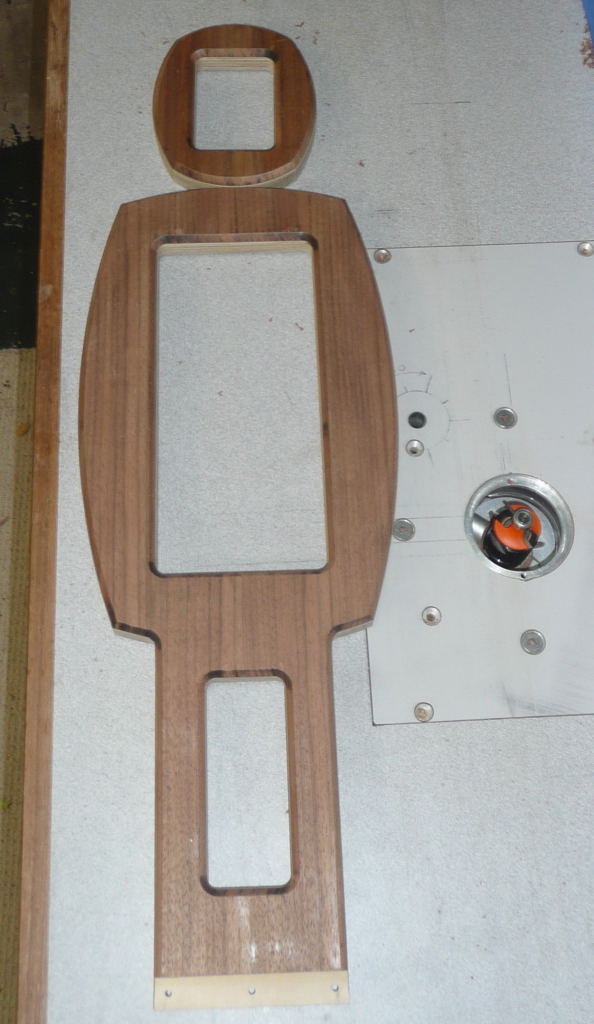

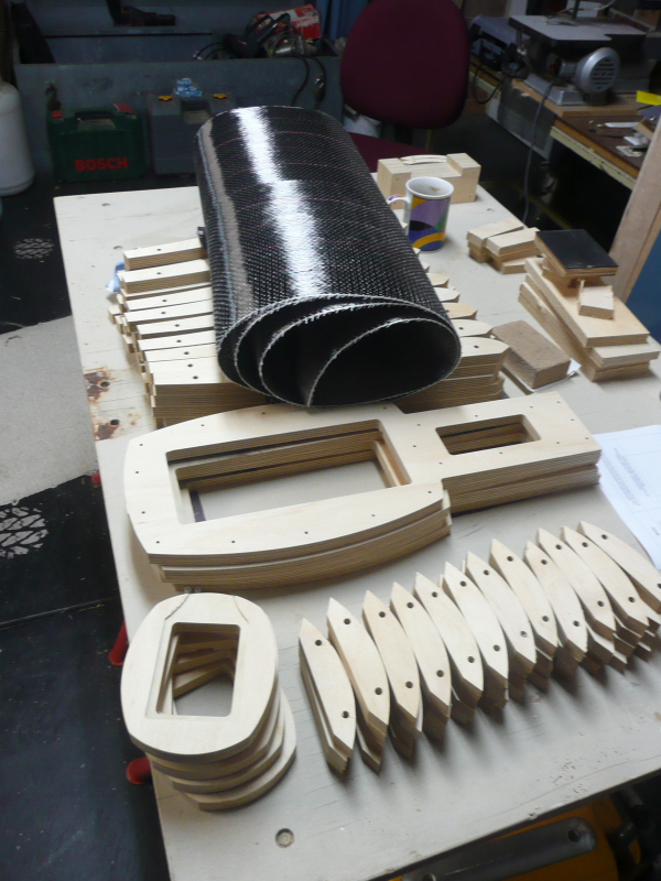

I have made some minor design changes, mainly so I don't need too much outside help to build them. Originally the "Man" was going to be fixing to the bass driver box via a steel bracket but have decided to try & stiffen the whole thing up using a carbon fibre veneer on the inside between the panels, at this stage I don't know if that will be sufficient but should have a better idea by tomorrow after the test piece is dry.
As the drivers are planars (Mid & Tweeter) and have very little inertia to deal with, (no big cone racing back & forth), the Man doesn't need to be as stiff as it otherwise would.

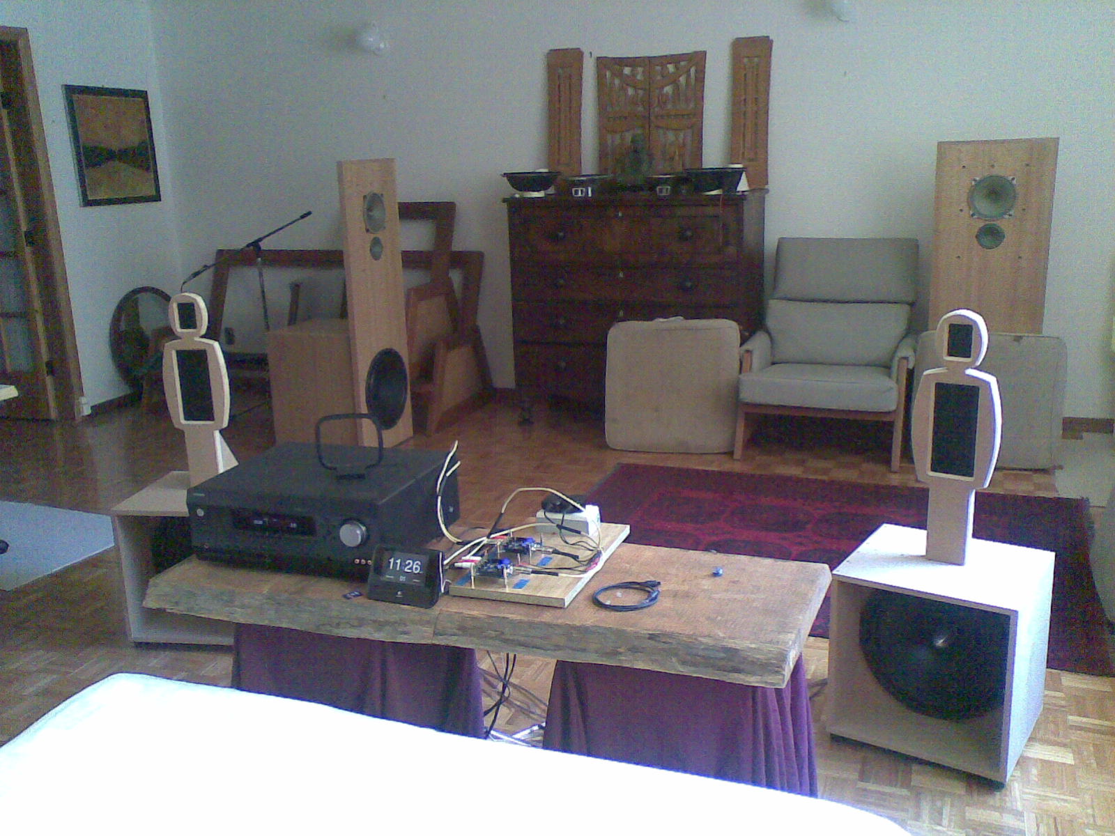

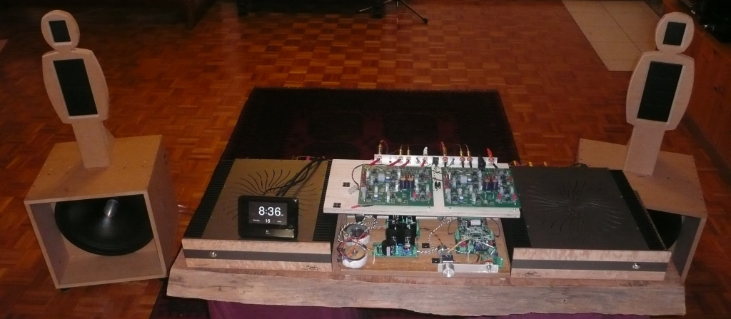

Iv'e pretty much stayed with the original setup except the crossover is know a modified version of the Linkwitz ASP.
I cross the mids over at 290Hz and the tweeter at 2550hz. at this point I am happy with the sound so it's time to finish them off.

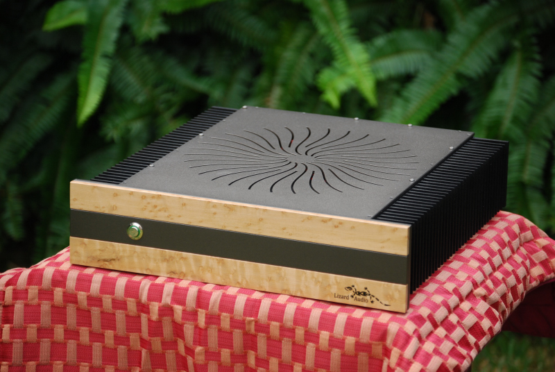

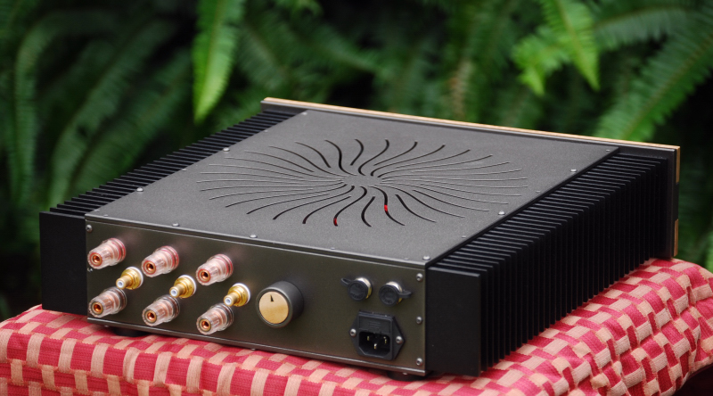

I've been busy building a sub & bed for the daughter 18th and spent a LOT of time building a pair of Mosfet amp's based on Aussie Amp Modules, I'll have to say they sound pretty good as well. Not to mention repairing the front end of my son's car that he smashed two weeks after buying it.
At the moment I have too many project running at once. I have just put together a Twisted Pear Dac & am building a Tub-i-zator valve output stage for it. I still need to build cases for the dac & crossover so will be busy for some time.
With the speakers I was sick of looking at the pine board prototype & have declared this as the year to get things finished, you seem to be good at getting things finished.
The TP dac will basically become a preamp & I will use the Arduino boards to add a remote that will control the whole system, well at least that's the plan 🙂
What have you been up to?

Beautiful amp david, nice the Vfet modules?

The modules I used are these & yes they are very nice.

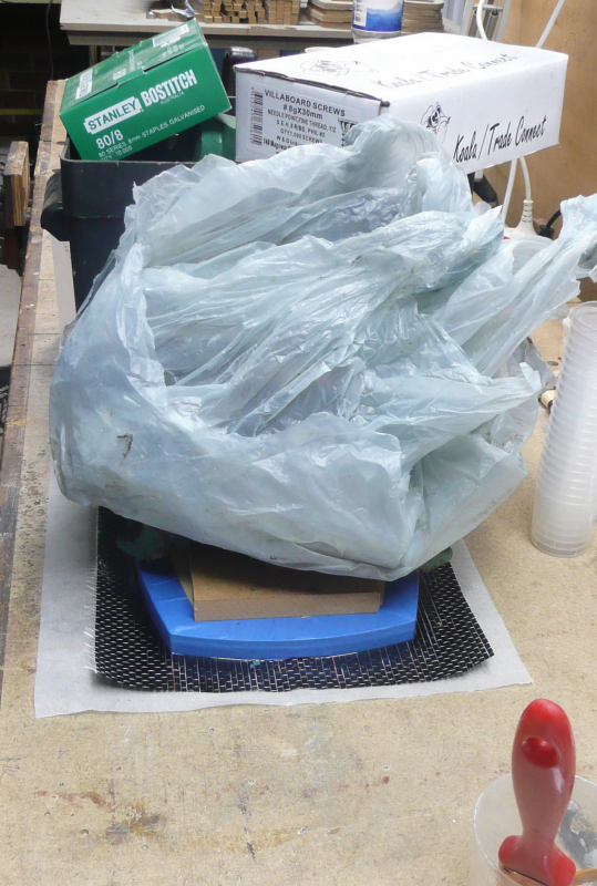

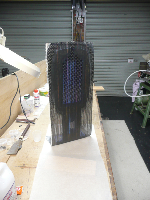

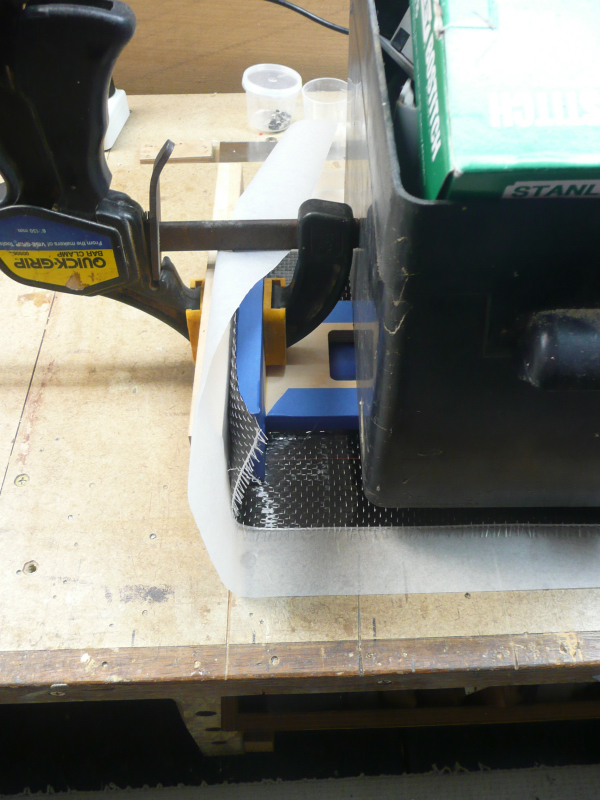

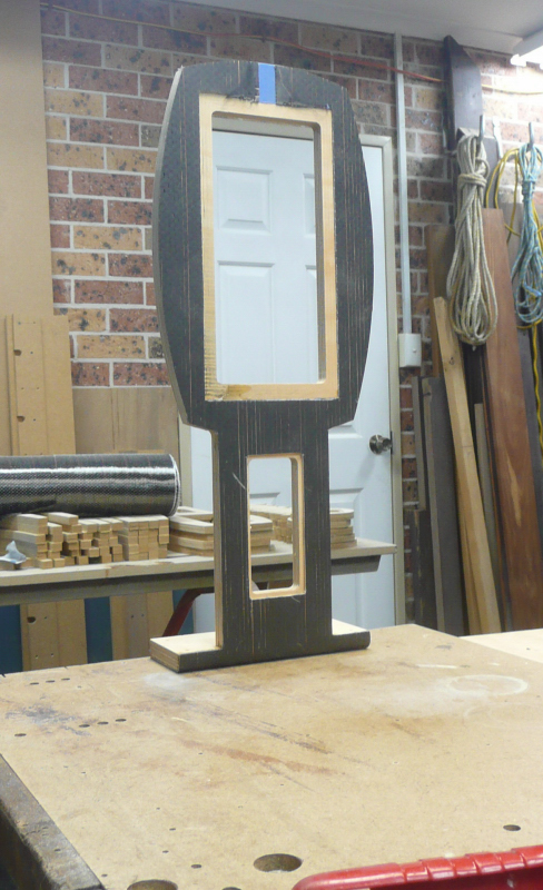

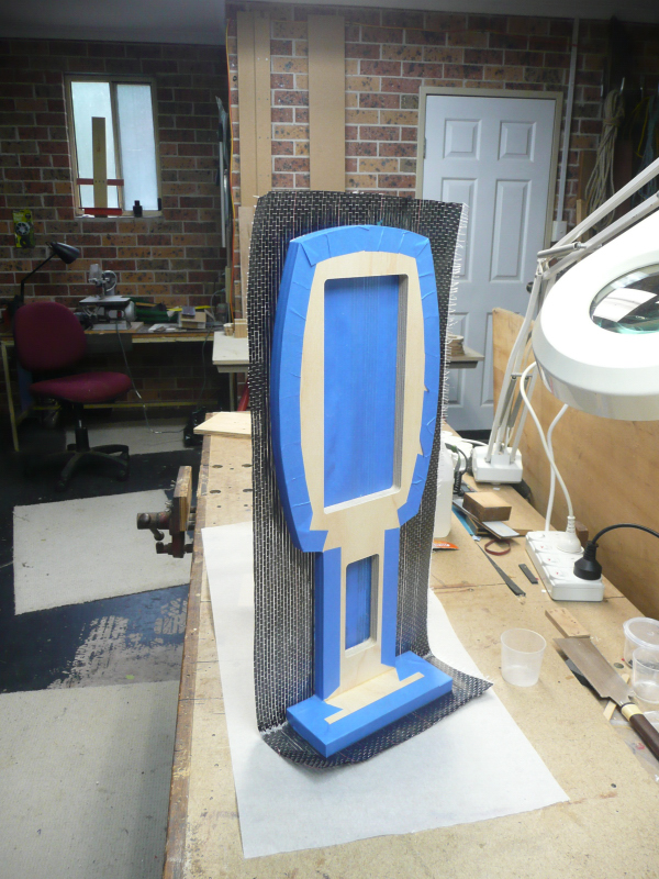

I'm very happy to report the carbon fibre worked a treat, its as stiff as you could possibly hope for. I have also learned a few lessons on the way. Its a bit time consuming & will be especially so when I do the opposite piece, as it has all of the recesses for the cables, so the taping & removing the excess carbon will take for ever.
I have realised I need to veneer the front faces first then round the edges then put the base on and carbon after that. I am going to veneer the faces with 3mm to 5mm solid wood veneers which I haven't made as yet & will need to buy some wood for the job, so the project has come to a halt for the moment

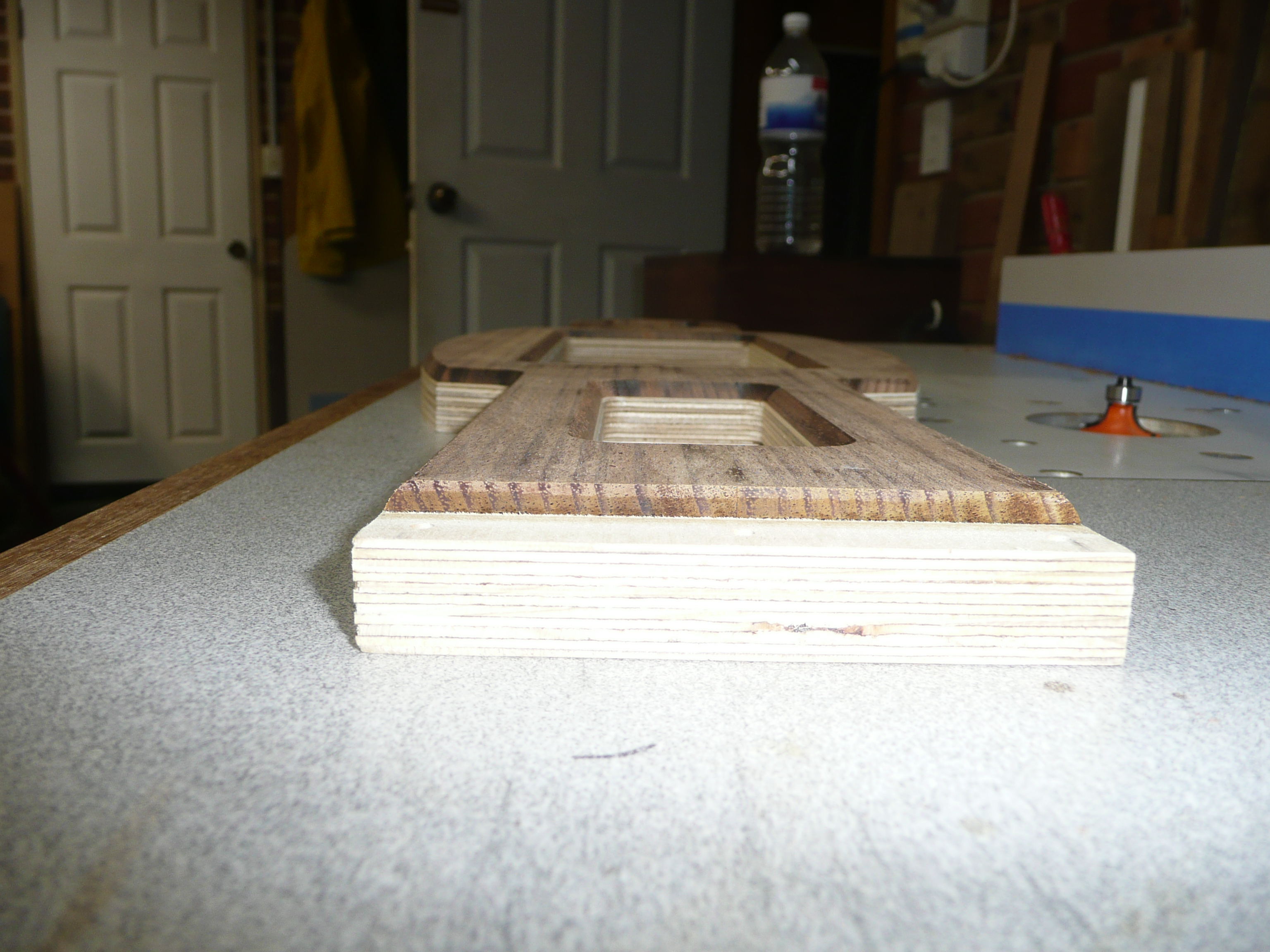

Progress has been very slow, too many projects, too many interruptions.
I have cut Tasmanian Blackwood to about 5mm thick & laminated it on the front face. Unfortunately when I route the curve on the edges the grain gets raised in the sections that the router bit is running against the grain. There is no way of avoiding going against the grain. I am using a brand new bit but still the grain gets raised & dug out.
I will try modifying an old bit tomorrow to see if I can improve things. As yet I have not cut the full curve. I was hoping to avoid using too much sandpaper as it will take the crispness off the curve, but I don't think I will have much chose.
The plywood edges will be black at the end of the day.
What I REALLY hate is having my fingers so close to the router bit when I'm curving the head section, scary stuff
