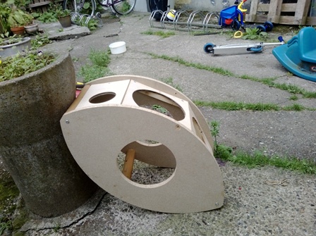

When the "baffle" is warped around enough to have five sides?When does an Open Baffle become and Open Box?
Or maybe someone could define the minimum required open area vs. the surfaced area in order to ba an open baffle.

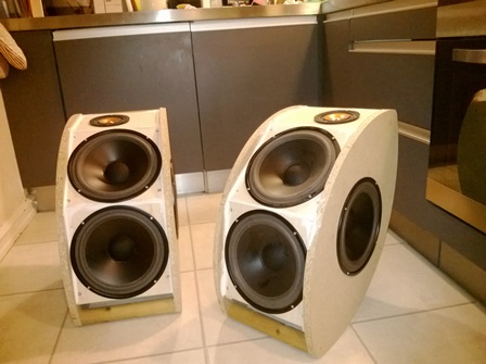

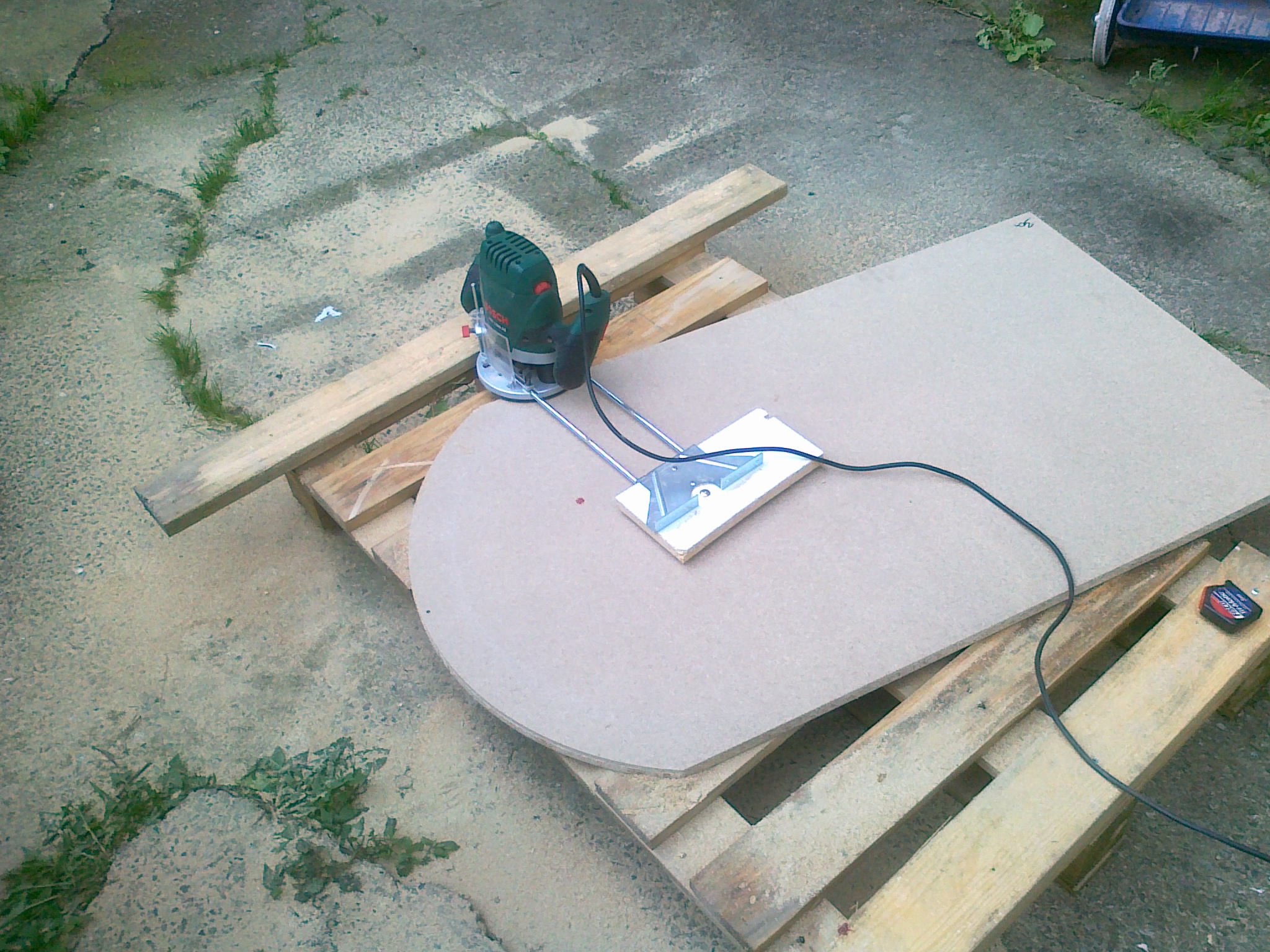

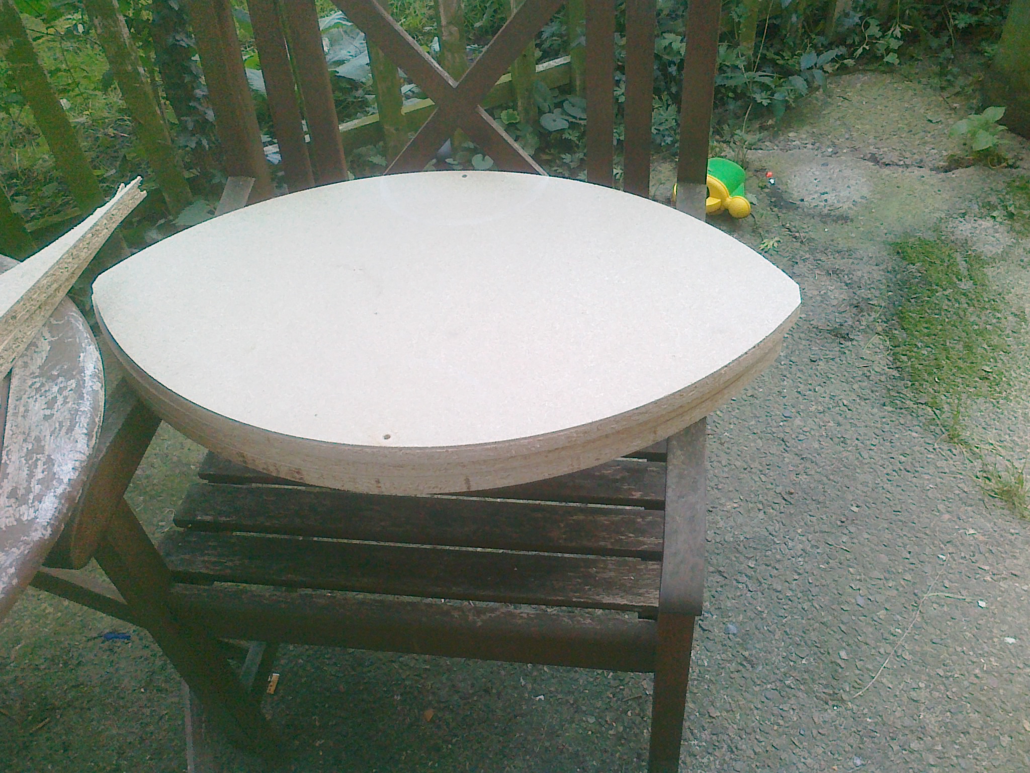

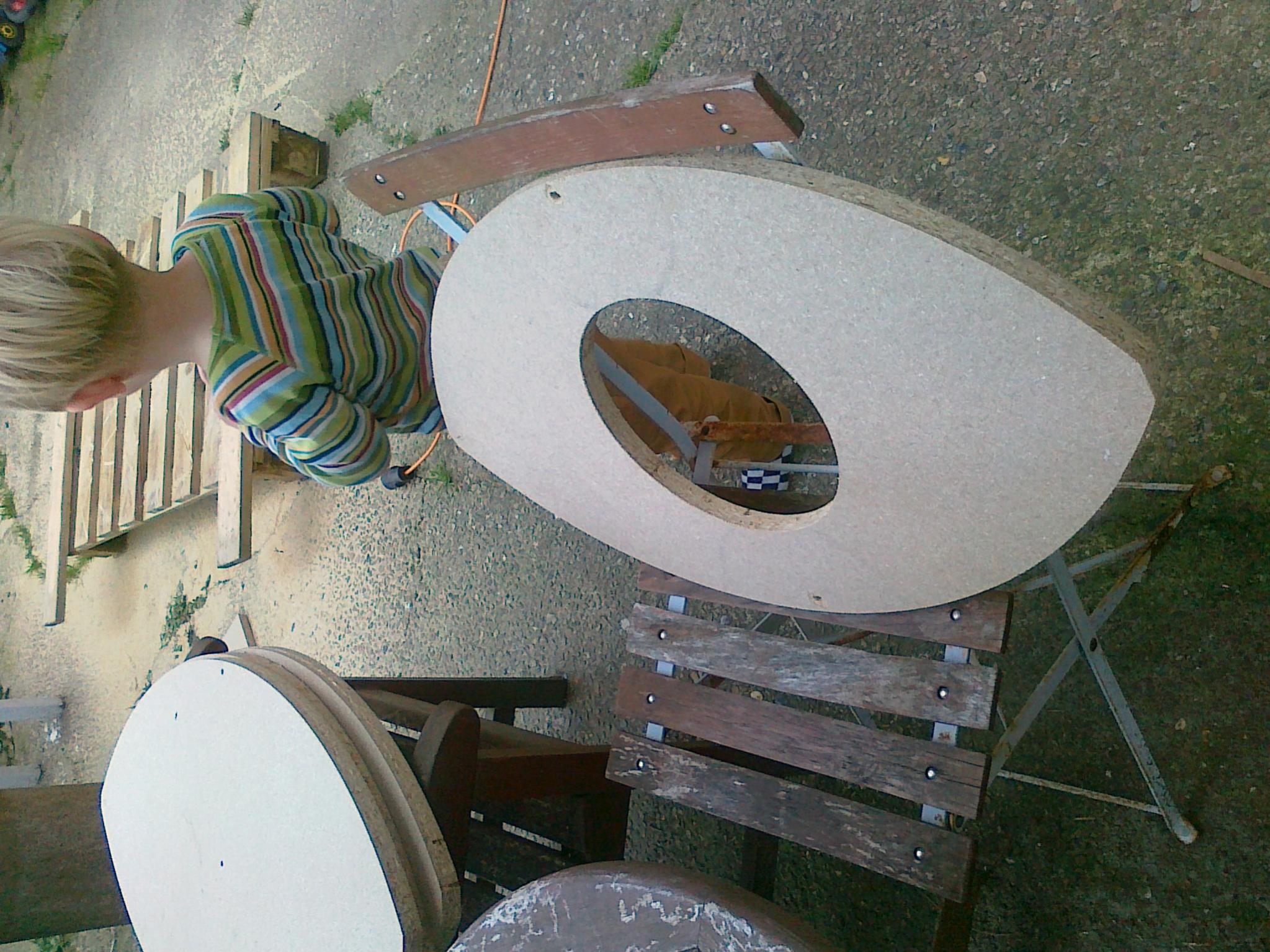

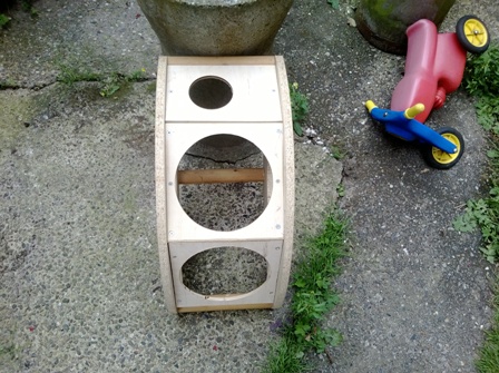

I know I'm not fast, but some progress have been made.
you will get there, eventually
I now have two raw cabinets.
looks cool
how many divers are you going mount in that .... thing ?

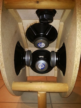

There will be four identical 10" woofers from Peerless, and one Mark Audio CHR-70 fullrange in each speaker. It will be two way. The side woofers could be a problem, and I will consider to cross them at 80 Hz or so, and then just let the two front woofers cover the full range up to the Mark Audio
There will be four identical 10" .....
..... side woofers could be a problem, and I will consider to cross them at 80 Hz or so....
or maybe try 2.5way
You will definitely need to isolate the full range.
But, this is open baffle - will there so much sound pressure?
if it moves more than it should you will notice it
I'm quite sure a single woofer would not cause any real big problem ... but with 4 woofers cramped into a very small space might be different than just a single woofer
btw, not sure I would call it open baffle, but more like folded, slotted, or open back, or something

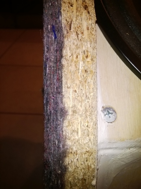

First try with the 10 mm thick sound absorbing felt. This will be used inside and outside and will be covered with a thin 2 mm layer of black felt.
WHERE!!! did you get that gray felt?!!
I have to import mine for a kings ransom from Sweden. I've been looking for years for a suitably cheap outlet for the stuff in Denmark (it really should cost next to nothing as it is a waste product).
It is the only other obtainable alternative to mineral wool in EU but seemingly impossible to get hold of unless you are a car manufacturer or furniture factory.
