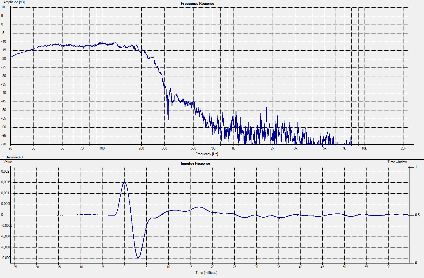

measurements woofer
Just had some more time to experiment. The integration is hard. I had to remove dipole artifacts quite dramatic. I had hoped for som soft adjustments. But, cleaning up over 300 Hz really helped a lot on overall sound. I started with crossing at 400 Hz, but that was to high.
This is how it looks right now. Measurements are raw - no smoothing and no gating. Measured 1 inch from cone.

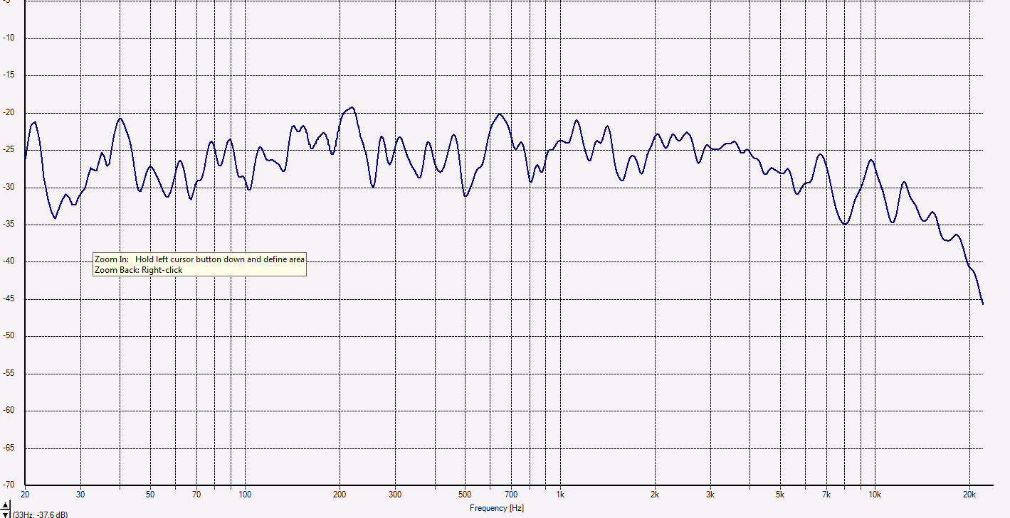

160 degree measurements in normal listening room

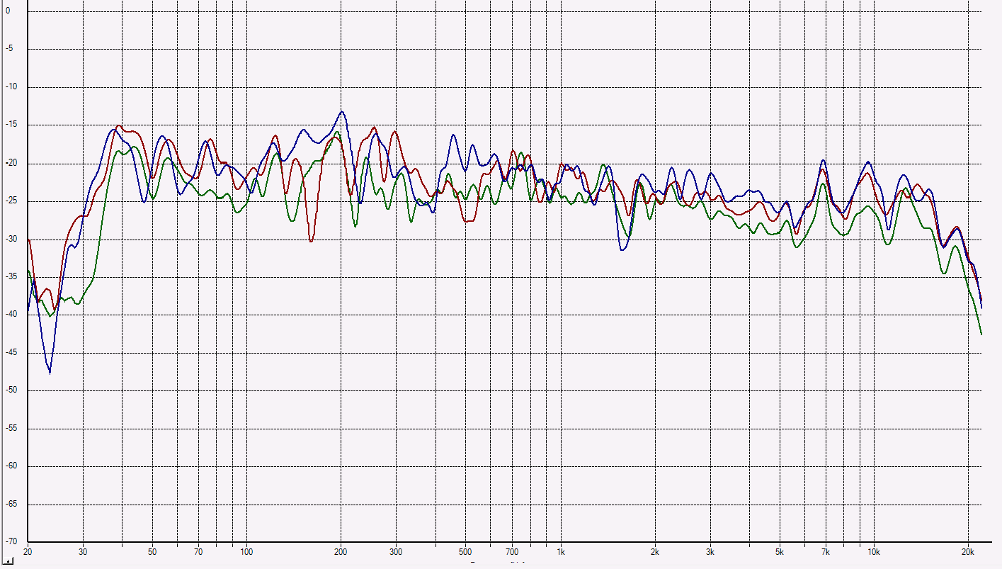

1 meter almost from side (80 degree) - direct in front (red) - and one meter from other side (-80 degree).

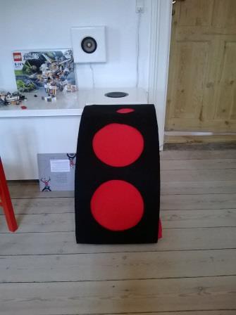

Mine are 55 cm high

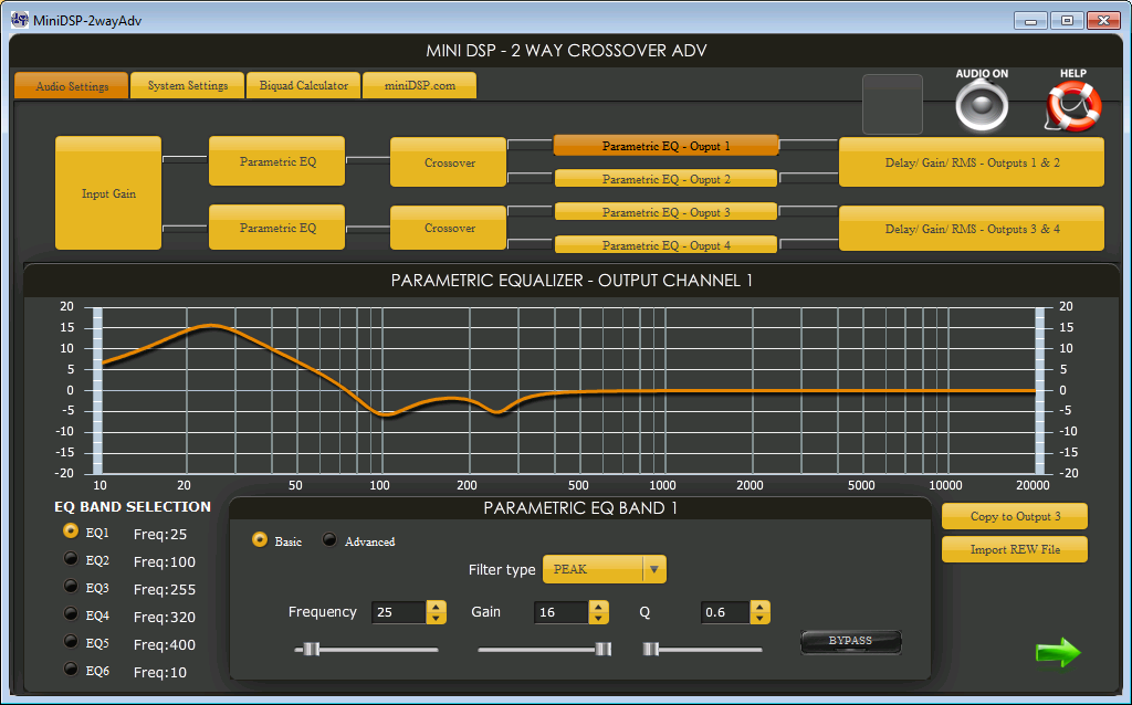

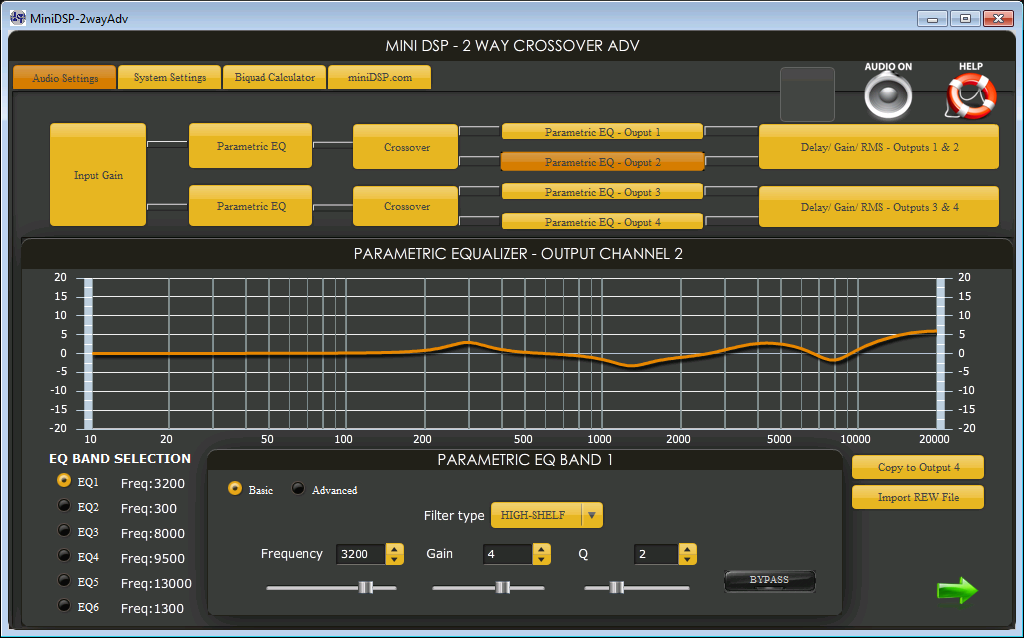

one more. 2 meter from loudspeaker and mic 1 meter up (before it was 55 cm above floor). I am not quite happy with using a 4" fullrange. It's to hard to eq so one day I will ad a tweeter
Eq
