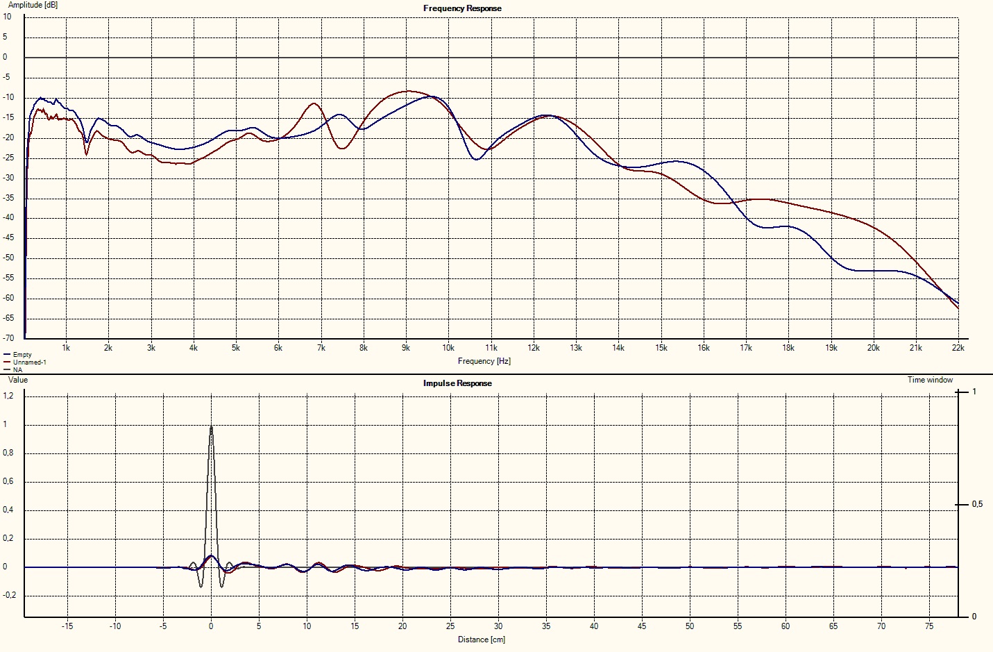

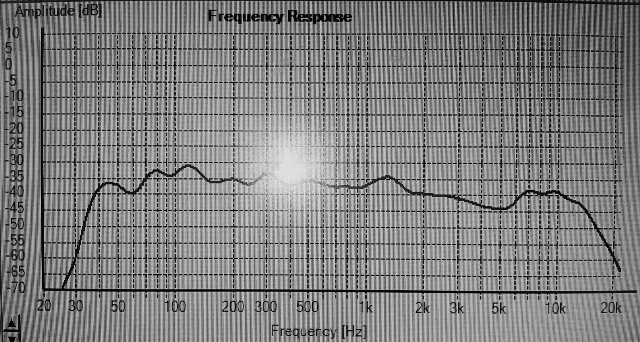

Could not find my measurement mic, but have some other mics that will do fine below 1 khz, so every above should be ignored.
Even though its not at all accurate, it's still easier to make adjustment than just using the ears.
This first simple measurement is with the speaker free from walls, and mic 1 meter away measuring the complete speaker.
First of all it does what I hoped for. The sound is very even, not matter where I stand.
I have also a decent sound overall. There are no major artifacts even though the speakers are partly upfiring. The sound does come from a space around the speakers, and not from the ceiling or from behind.
I have to get a good mic before I make some serious listening, and I also plan to make some furniture adjustments to have these speaker placed more freely. It's open on the back so close to the walls is not good (I have tried).

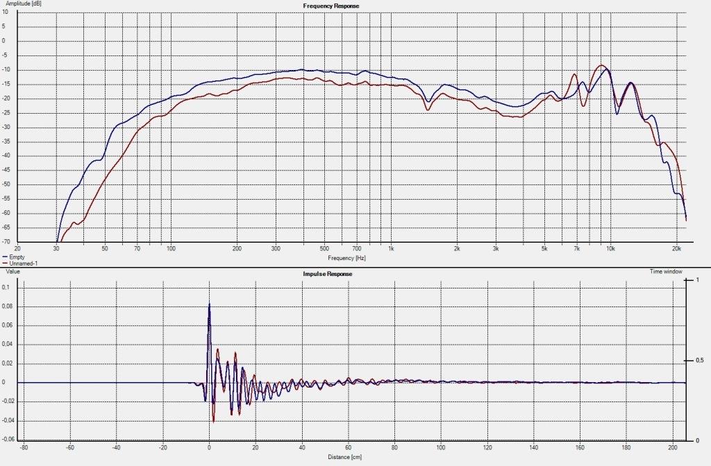

Distortions begins to raise under 300 Hz, but can I rely on distortionmeasurements, with and uncalibrated mic. If 300 Hz is correct, could I aim for 400 Hz between woofer and fullrange?
I also consider if the fullrange shold be open at all. I would like to cross over as low as possible.
See post #50 - It's open baffle so i did expect this. But listening to this combo, I begin to worry if I can get an even powerresponse. It's very good away from the speakers, but in between - in line with the speaker sittning on the floor, it's obvious that sound comes from woofer and fullrange - and not as one homogenous soundfield. Off course I'm sitting in a dipole null, but the woofers are also side firing and no doubt the cause for this negative effect. Thats why I would like to go lower with the fullrange.
