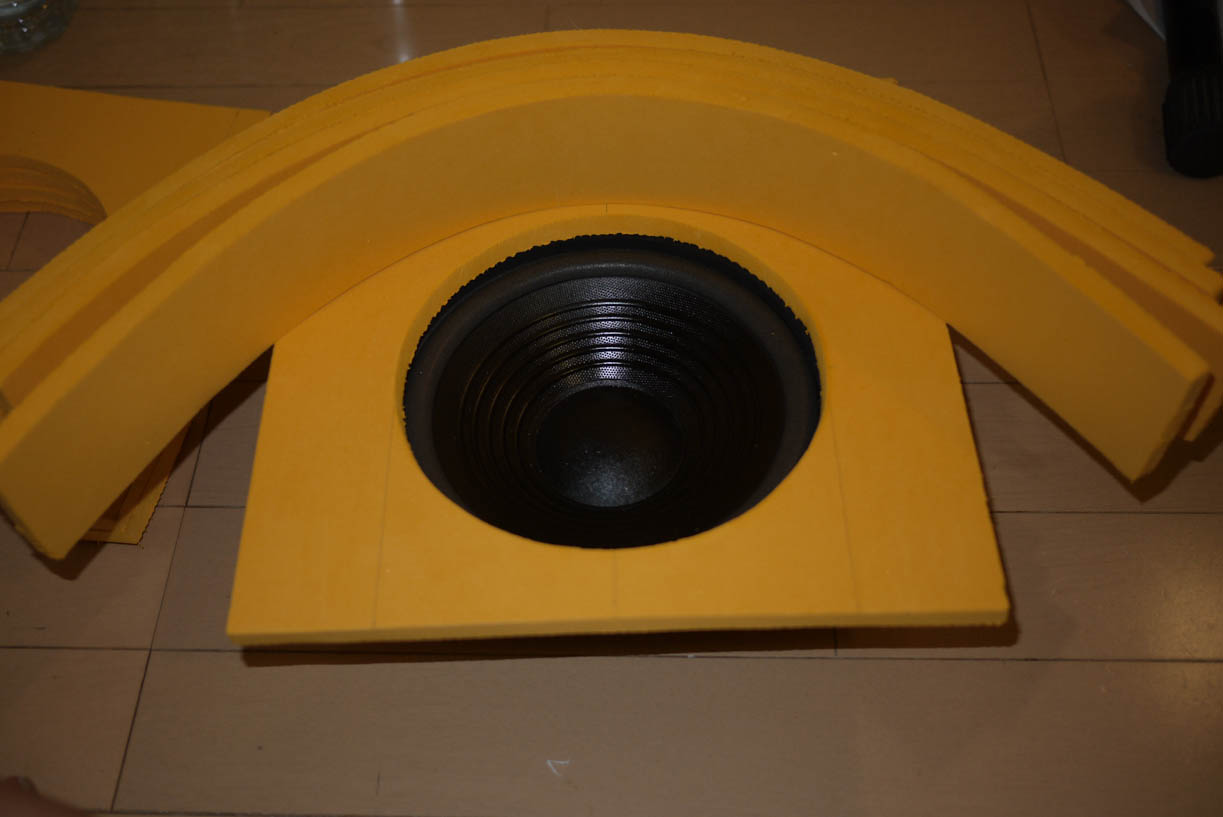

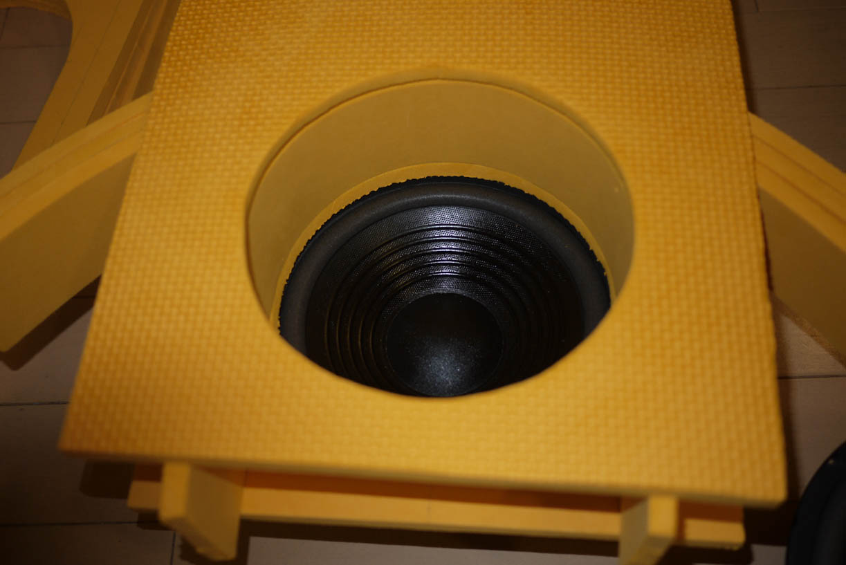

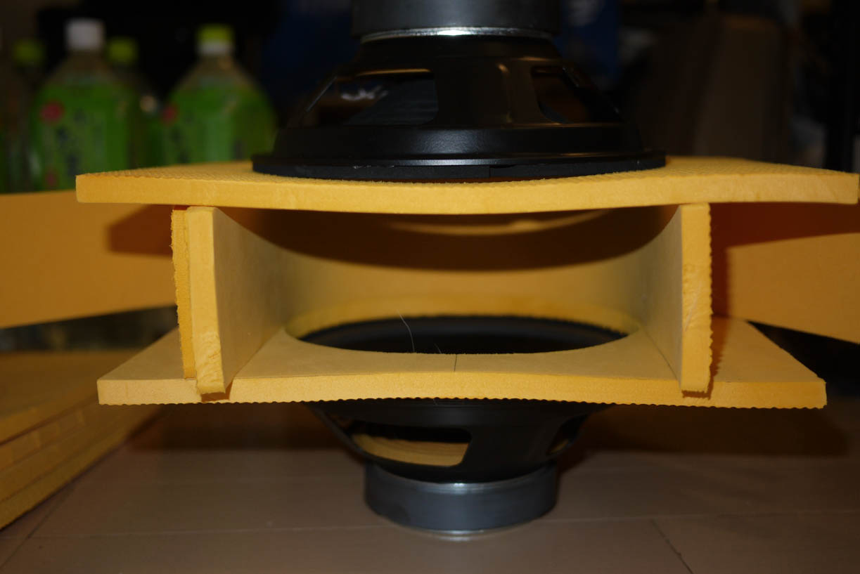

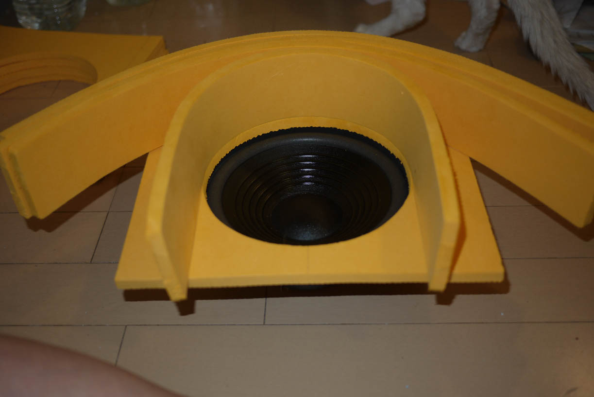

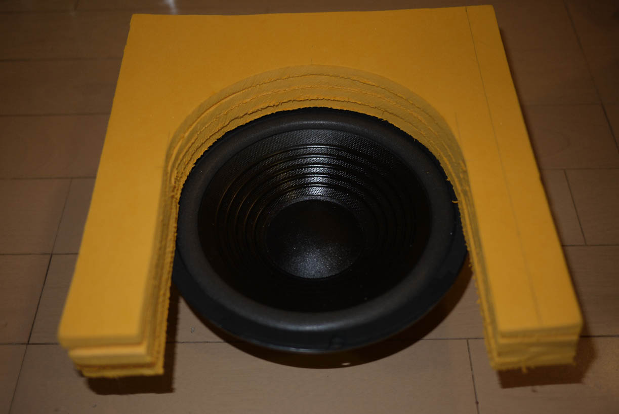

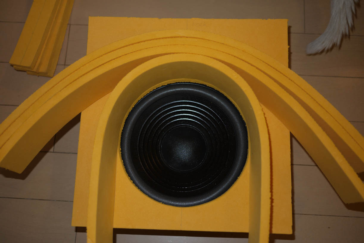

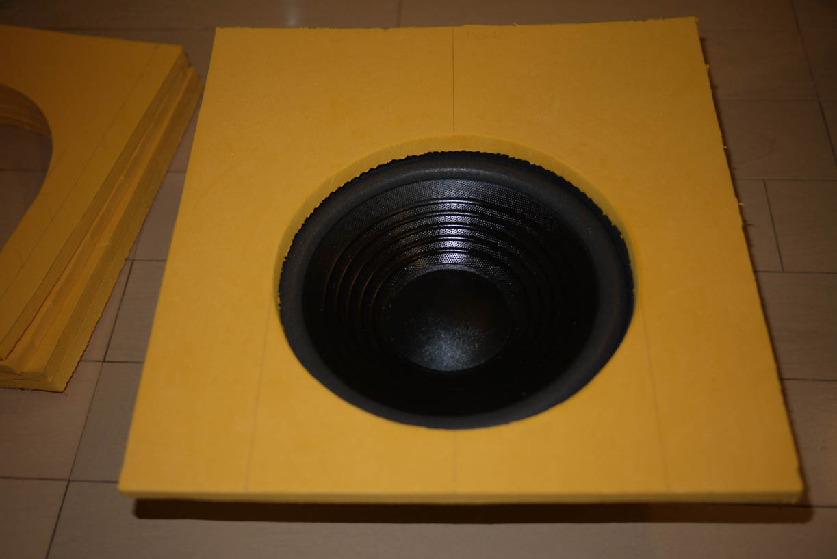

OK here are some pictures of the EVA foam I have cut for the slot-loaded open baffle. This is the slot apparatus and the drivers are GRS 8PF-8
I started by following the nelson pass original design which cuts a curved slot shape into multiple layers of material (in his case MDF, in mine EVA) and laminate them to create the compression channel. But when I started building this way, I realized that it 1) wasted a lot of material that had to be cut away and 2) it created a very rough interior surface that would need to be sanded smooth. Since this channel is compressing the sound/air, I am thinking that the inner surface should be smooth to create as little turbulence as possible.
I then realized that I could take advantage of the ability of EVA to curve very easily. So I cut 4 strips, 70mm wide (my slot channel width) with the plan to laminate them to create a solid structure. I might be able to get away for 2x layers, but I plan to make 4x layers to make it very solid. Combine with panels top and bottom and then rear mounting the driver with threaded bolts going through the 90mm of solid EVA. For these pictures I pinned the inner strip to the rectangular piece. I may laminate another layer on each side, around the frame of the driver to give those rectangular pieces more rigidity, especially in the front which will be bolted up to the driver.
This structure will form a solid module (EVA slot plus 2x 8" drivers) which can be faced with several baffle shapes. With such a module, the front baffle and folded wings do not need to contribute to the structural rigidity of the speaker (absorb vibrations, nor hold the driver baffles rigid). The front and side baffles will only need to provide the baffle shape for controlling the destructive interference of the rear sound wave. Plus this module can also be oriented vertically or horizontally since it is a solid structure.

one of the reasons I have been slow to glue this up, is that I am not sure I like this orange EVA/PE material. It has these nasty bumps on one side (non-slip floor tiles), and it is much lower density and softer than the white EVA (koyo soft board) that I normal use. Plus the label says it is PE foam (polyethelyene) and not EVA. But it feels and smells like EVA so I am not sure. But it was very cheap. I was able to cut all this orange from about 250¥ (~$2) worth of these orange EVA/PE floor tiles. If I would use my normal EVA it would cost about 1500¥ (~$12).
There is another EVA/PE floor tile I can get here which is covered in a thin layer of cork and does not have the bumps like this orange stuff. It only comes in 300mm x 300mm tiles but that should be enough for the top/bottom square and probably the front baffle and side. It is also very cheap and the cork may work well. I may pick a pack of that up and try it. If I don't like that, then I may just use my normal white EVA for the rectangular pieces, keep the orange curved strips. I need these rectangular pieces to be slightly rigid and to make a good seal with the drivers.

It's all on the back side so orange color won't be so visible. The final curve in the slot is visible to the front and make that one layer white. You could paint it all black and won't matter anyway? Looking good though. I was going to do same thing with curved foam core panels for the channel. Mine will be 6in about in diameter.
From what I recall (or think I recall), OB/SLOB 'projects' its image farther and for that reason I would've thought its impact would be lost.
Have you found this to be so?
My one OB/SLOB project was mono so not sure if I can say but I am not sure why image would be thrown farther away except for fact that there is a rear reflected image that adds ambience?
The orange color doesn't really bother me. It is more that the bumps make it hard to get a good seal with the drivers and make it hard to laminate layers. The bumps are also very difficult to sand off for some reason (maybe a coating on that side). Also this particular foam is lower density. These all just have me a little concerned, but it might not be so bad.
But maybe I just give another go at sanding the bumps around the driver hole so that I can get a nice seal, or maybe replace the front foam on the drivers with neoprene to help with the seal.
And you are right that I can always paint it black. But the orange color is not bad and it would be kind of cool to have the hint of orange showing on the inside of the slot 🙂
