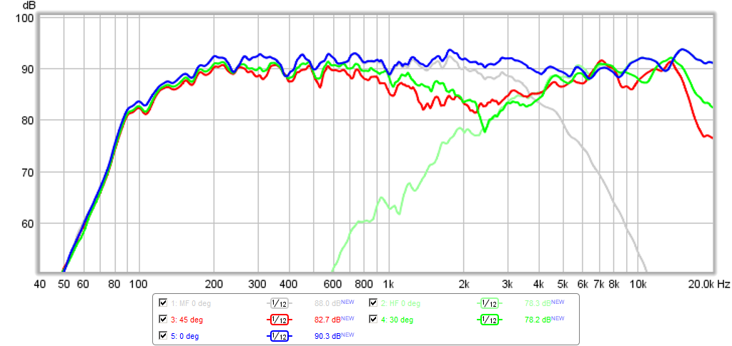

So a vertical polar at 0deg, 30deg, and 45deg should confirm if this is happening then? 30deg should have deep null?
Guess so, bear in mind the 100mm ctc distance set in XDir is a guess looking your OB pictures and if this is way off must have precise data then.
Because you use advanced Harsch XO with a certain delay setting and to rule out if any misalignment in acoustic center alignment suggest take measurements every 10º to give better picture :).

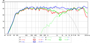

Byrtt,
There is some lobing, but it appears to be a soft effect and 10dB deep at 2.4kHz. On the other hand, the response in the HF is very good up to a high frequency with minimal variation.
This is at 0 deg, 30 deg, 45 deg with TG9FD-DC28F-TG9FD.

Byrtt,
Okay a smiling response with a null dip at 30º thanks plots its not invincible and makes some difference compared to had it been a single TG9FD at these angles, you right higher HF is very good where tweeter gets on its own.

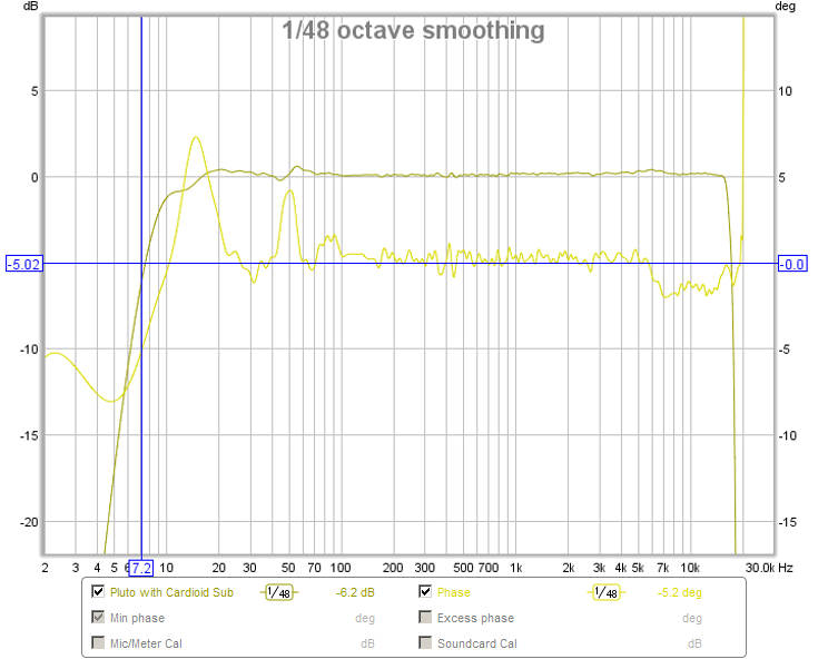

Nice. What drivers are uses in the cardioid sub? Is the response down to single Hz?
Monopole sub is Peerless 830500 XLS in 14" x 14" x 20" sealed box; dipole sub is Dayton RSS315HF-4 in 14" x 14" x 20" U-frame. Monopole is stacked on top of U-frame placed on floor.
Crossover to Pluto is 90Hz FIR filters. Sub system is run mono.
Frequency response:
Setup is capable of square waves from 8Hz-3.5kHz.

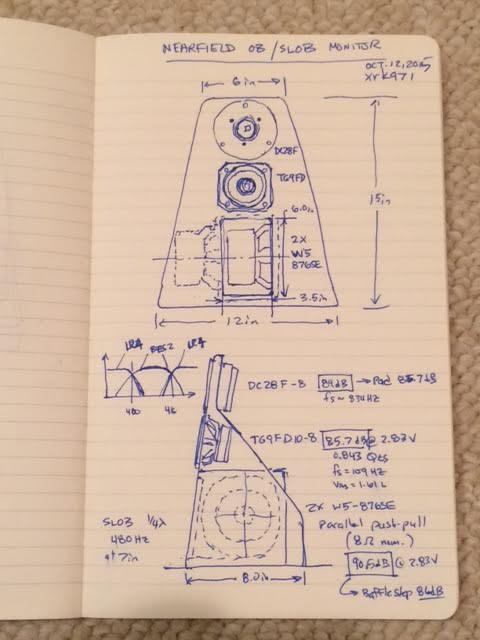

DC28F/TG9FD/2x-W5-876SE SLOB NF Monitor
Jeshi,
Hope you don't mind me posting here - but I am going to follow along and try building something similar as well. I have seen that the TG9FD coupled with a silk dome tweeter sounds wonderful. I have had luck with slot loaded OB's (SLOBs) before when I used qnty 6 x 6.5in buyout polycone woofers and a TC9FD on top - see thread here. For a nearfield, I think a couple of 16ohm Tang Band W5-876SE's in parallel will work out nicely. It looks like everything will come out about 85dB sensitive after baffle step losses. The DC28F will have to be padded down from 89dB and everything will run at the native sensitivity of the TG9FD10-8 which was measured to be a little over 85dB. Here is a sketch of my plan. This is an EVA foam thread but I will have to make it out of conventional paper-faced foam core.
The 7in deep slot will have a natural -6dB/oct falloff at 480Hz and I can probably use that to advantage to design textbook LR4 or BW4 target with BW3 electrical at about 400Hz. The TG9FD will be symmetric hole-filler with Bessel 2 electrical and acoustic band pass at 400Hz and 4kHz. the DC28F-8 will be electrical and acoustic LR4 at 4kHz. These are guesses and will remain to be seen. I will do it properly this time by measuring raw FRD's and using PCD to determine acoustic offsets and design the active EQ and filters all in simulation prior to implementing in miniDSP. Hopefully, I will end up with a transient perfect B&O Hole-Filler XO. :)
Thanks for creating this new thread.

I don't mind, I was just worried that if we really keep the discussion going strong that it will get confusing when the thread gets split and the old posts get merged into here. I sent the message to the admins so now just waiting for them to split the thread. For now best to keep the discussion here until after the split happens. Hopefully the time stamps on the original posts will remain the same so after the merge it will make sense.
I love the look of this design! I am still playing with my ideas. I really want to make a landscape style in the ilk of the KH310 and ATC SCM25A since I am planning to use a pair of 8" woofers in a folded SLOB for my version and with the slot to the side of the DQ25/TG9. But this would mean a very asymetric OB for the DQ25/TG9 or having the TG9 share the W with the SLOB which might give a bit of TL-like loading.
I am planning this sort of design for my SLOB. The slot-loaded-W-frame fold rather than the large front baffle that Nelson Pass did in his first version.
Subwoofer Origami
But your woofer design is more like a W-frame open baffle rather than slot-loading.
According to Nelson Pass's original article, the slot should be smaller than the combined Sd of the drivers by a factor of around 3:1 or 4:1
The air coming out the front is squeezed at a ratio of about 3 to 1.The rear wave not so much. Remembering that the motional energy is proportional to the square of the velocity, we expect more energy out the front than the back. The response is not symmetric – the rear wave that wants to come around and cancel at bass frequencies is not as strong as the front wave, and its ability to cancel is diminished. This is the raison d'etre of the slot loaded open baffle – greater velocity out the front and less out the back.

Jeshi,
I think we both have similar W frames, I may end up going with a non-push pull design to keep the mass distribution symmetric as offsetting both drivers to one side make this a very tippy speaker to one side. Not sure if that is worth the reduced 2nd order harmonic distortion reduction. I like your horizontal format concept - very handing for mixing/mastering bridges - and I think the integration of the tweeter and mid may work out better. Dual 8's is going to give you a very nice amount of bass with a total Sd of circa 440cm2 vs my 188cm2 Sd.

I will have to play with the slot loading ratio in Akabak - making it narrow and high loading gives more efficiency but at the price of an overshoot peak right before the cutoff frequency. With a 3.5in wide x 6in tall slot I am at 1.4 compression ratio.
I would have to go with a 1.4in wide x 6in tall slot to achieve 3.5:1 compression ratio. I could do that and actually it would look nicer and allow me to make the bottom trapezoid narrower for a smaller speaker footprint. The drivers are 3.5in deep ea x 2 + 1.4in + 2in clearance = 10in wide.
interesting! I just wanted to first follow Nelson Pass's formula to see if the loading works they way he says (more directional energy forward, lowering Fs), before going to more common W-H-U-Z frame. Common concern with slot-loading is that it could introduce distortion or artifacts because it is compressing and accelerating the airflow.
I want to get some real world experience with this slot-loading concept.
