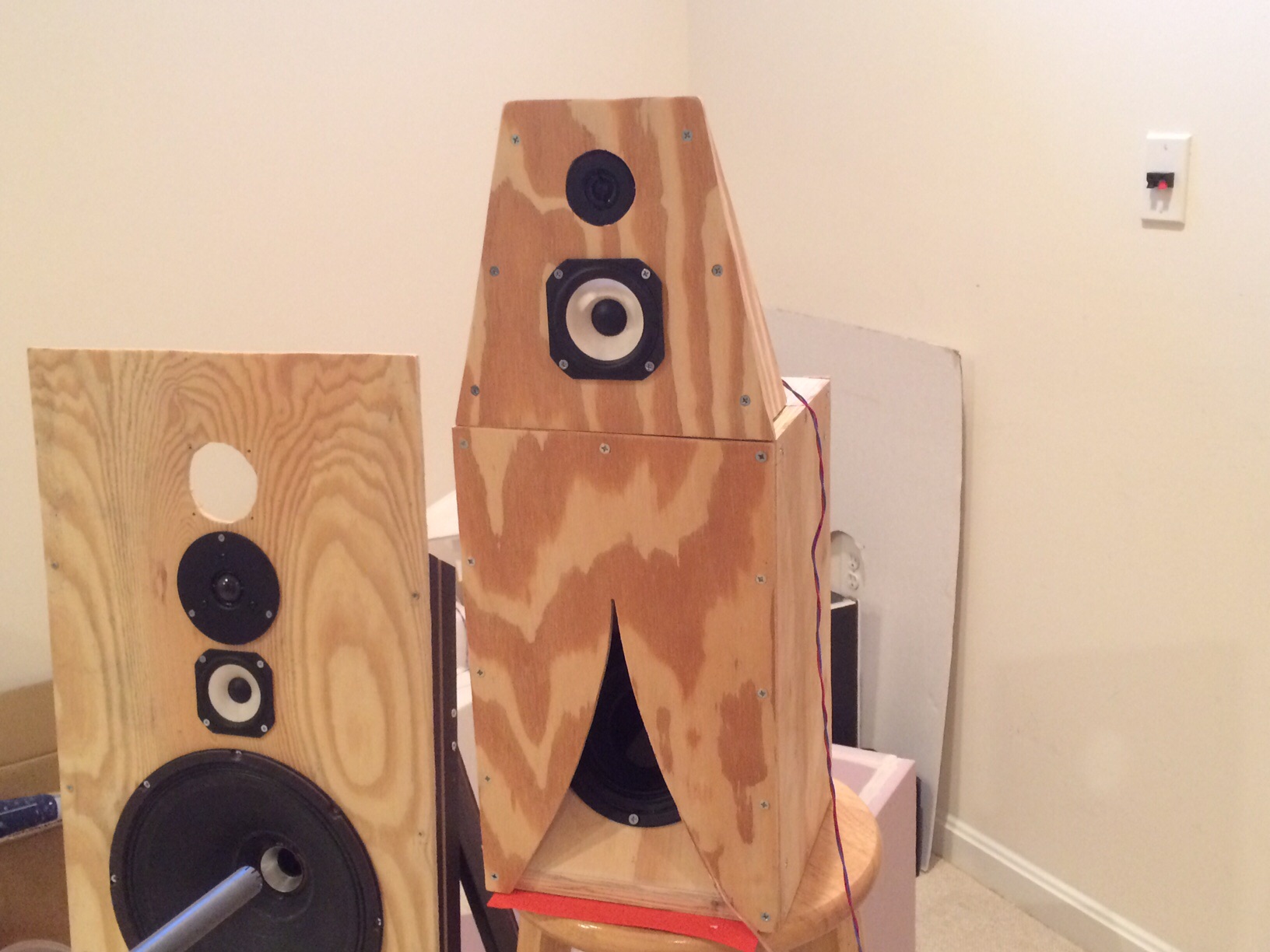

Progress on the kaZba dipole desktop bass unit

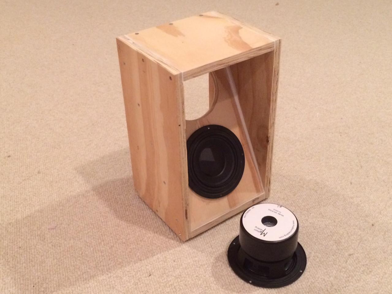

My first build with all 3/4in plywood. That's some heavy stuff but I don't think it will rattle. I have a mess of sawdust around now - what a pain. All cuts done freehand with a sabre saw.
Waiting for liquid nails to dry. Clamped with construction screws.
Looks good. A jig saw can be just fine one smaller builds, and at least the dust isn't MDF dust!

I think I just outgrew the desktop option and graduated to stand mount. The Kazba is already 15in high. Once I add the trapezoid OB for the mid and tweet that is another 9in or so. So at 24 in high already. It's going to be an LX521 style stand mount though.

This is why I really want to try to make the SLOB work, since I think it is the only compact way to do an open baffle (sub)woofer which can get down into the 30-40hz range. I am going to see if I can make my SLOB in a modular manner so that I can use the long threaded rods to allow changing of the curved slot to change the slot width from 70mm to 90mm to maybe 110mm.
70mm -> 3.3x compression
90mm -> 2.6x compression
110mm -> 2.1x compression
Nelson Pass recommends 3-4x compression for the SLOB so by 2.1x it is more like half way between a SLOB and a W-frame (but with the drivers on the outside and firing inward). A Ripole might be another option to try to keep the width down, but this would put more stress on the rear panels.
Right now my SLOB is looking like it will be 280-300mm tall, about 280-300mm deep and maybe 300-350mm wide. Add in another 100-130mm to the width for the DQ25/TG9 baffle and my final size might be 300x430x300mm HWD landscape and within my target. Hope I can make the 70mm 3.3x compression SLOB work.
I will get some new EVA/Cork tiles tomorrow along with some threaded rods and will start gluing this week.

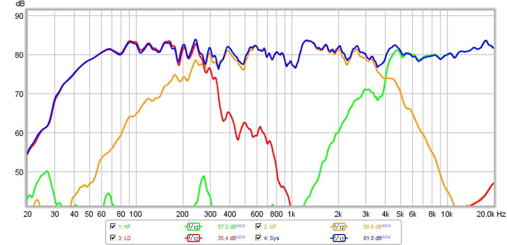

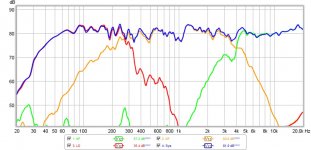

Here is a rough cut at the XO so far just to make sure the woofer actually crosses the mid with good overlap. I am running the mid 1st order electrical for 2nd order acoustic and woofer 4th order electrical. The Harsch XO will work fine here.
Still a lot of work left to get delays and acoustic offsets correct. I will do it methodically in PCD with FRD files. But this is done by eye to see if it can even get there.

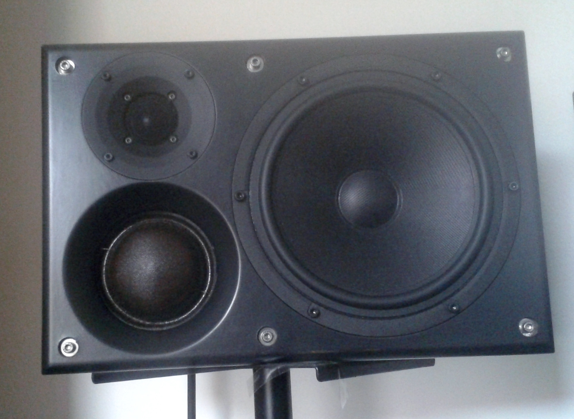

I've made a clone like this 😀
Chassis:
Woofer: Scan Speak 22W4434G00
Mid: Tang Band 75-1558SE (in a small Waveguide)
Tweeter: Seas 27TBCD/GB-DXT
One Hypex AS2.100 per side.
Crossover
Woofer - Mid/Tweeter: active LR24 at 500Hz (with Hypex)
Mid/Tweeter: passive LR24 at 2500Hz
burnett, that is a brilliant kh310 clone! Excellent combination of drivers. I am using GRS 8pf in this "experiment" 3way, but if it works, then I want to upgrade to either the 22w4434, 22w8434 or 830667. Also Seas 27TBCD/GB-DXT is on my short list of alternate tweeters I want to try in my Satori MW16p-4 based 2way (currently using the Dayton/Usher RS28f). I also like the mixed DSP/passive approach and have been thinking if I might be able to do that with my 3way design, but so far it looks like I am leaning toward going fully active with a pair of miniDSP and 4 stereo amps.
