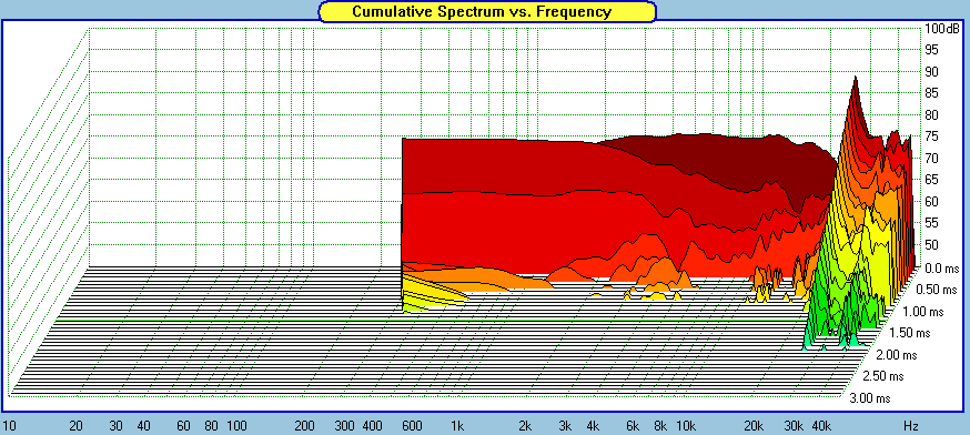

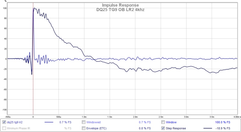

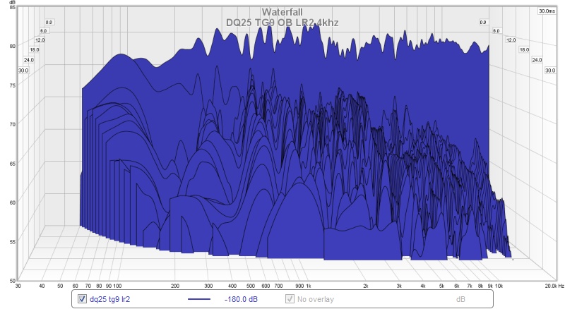

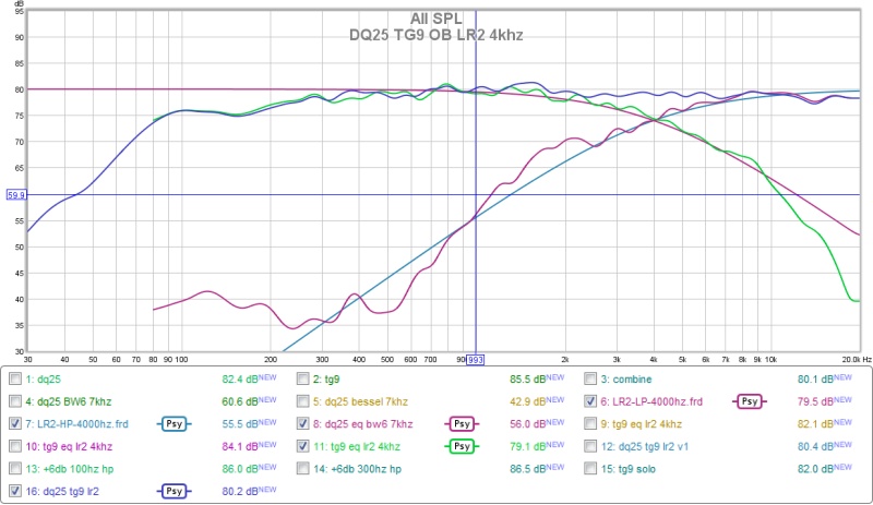

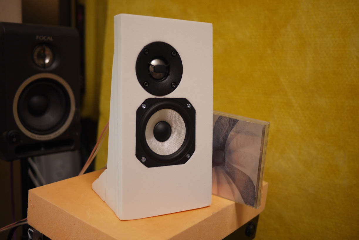

But here is a DQ25 + TG9 open baffle test platform for the start of this compact 3way project with XRK.
My idea here was to test an open baffle with the TG9, and also test if I would prefer the TG9 alone or with a small neo tweeter. I choose the DQ25SC15-04 since zaph gives it really high marks and uses it in several of his speakers. It is also a titanium dome so might be quite different to the silk dome RS28f that I already have. I have put it into a relatively simple EVA rectangular open baffle and have just offset the drivers slightly to try to control the baffle diffraction.
The center to center spacing of the drivers is only 77mm so I can do any crossover under 4800hz. I decided to aim at a 4000hz LR2. After a little EQ I was able to hit the LR2 target really well with excellent summing. I time delay the tweeter by 0.06msec to get the drivers time aligned. Somehow manged to get a linear phase and near perfect step response. Maybe because of the really high 4khz crossover?
Should be easy to mate this to a woofer maybe around 250-350hz. All measurements at 0.5m and approximately 80db at 0.5m.
I may have over eqed this, but I will start with this and see how I like it. Getting the DQ25 to hit the LR2 4khz target was pretty easy. TG9 was a little lumpy in the rectangular open baffle.
dq25
peak 1900hz -8db q0.5
BW6 7khz 0.06msec delay invert phase
tg9
LR2 4khz
low shelf 400hz +7db q0.7
peak 3400hz -2db q5
peak 1540hz -6db q10
peak 880hz -5.5db q2
not sure I would want to do this with a passive crossover though.
So first impressions are really good. So far I am fairly certain I prefer it with the dome tweeter compared to just the TG9, but the eqed TG9 sounds pretty good. Easy to mute the DQ25 and remove the XO to hear the TG9 fullrange.

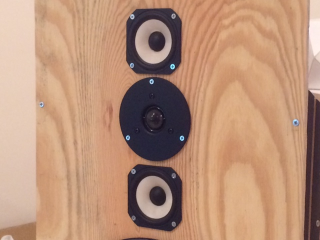

Still playing around with setup. It's also my first open baffle build so leaning. But I live with acoustat electrostatic speakers so I know how a dipole open baffle speaker sounds. 4000hz is really high even for such small drivers, so I might also try an LR2 in the 3000-3500hz range. But so far I am impressed how well these two drivers sound together in an open baffle. Might be one of the smallest 2way open baffles out there
Also built an MTM version with a pair of 4ohm TG9FD10-04 (post #128). Still evaluating which I prefer. Might prefer the simpler TM version but the MTM does seem to have lower distortion, it can play louder, and I also like the look of the MTM better.

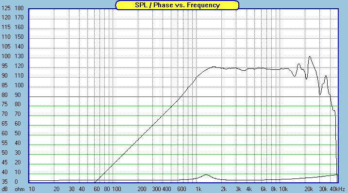

Very nice work! Yes, it certainly is the smallest 2-way OB I have seen.
This white foam is defintly looking fine !

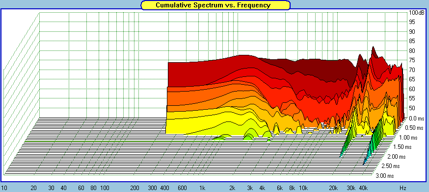

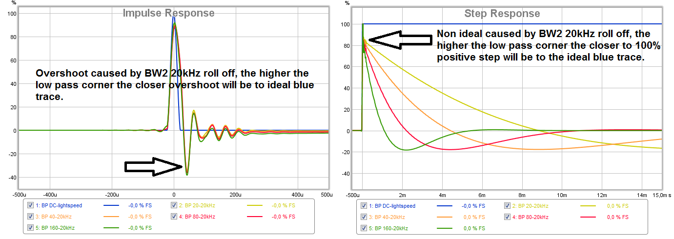

Does it need a low pass after 20 K because the resonance peak of aluminium ? maybe not seen by the ECM-8000 because above 20 K ? What happens if you apply such electronic EQ with a steep LP ? Nicer at the ear... The passive filter is correct enough ?
Having an aluminium, I can say I like it a lot but there is not the savour of a T33 tweeter (SP1191) from Kef in the 80s' 104/2 ref ! While the aluminium have a greater sound precision with piano, some guitars ! cymballs ! Hey metalic instruments.

The DQ25 resonance peak is above 20khz and not so large and it doesn't really ring. From zaphs measurements
In comparison the 27TBFCG rings a lot more, but it is at a higher frequency. Also the 27TBFCG is a large device (not a small neo) so I would not be able to get such a close 77mm center-to-center distance with this design.
So far I am impressed with the little DQ25 and I can see why zaph calls it "The DQ25 is one of the best neo domes out there in anywhere near 4 times it's price range".
I don't need to do any filtering in the 15khz and up region. Although I felt I needed to do that with the SB65, I don't feel that need with the DQ25.
I am not sure yet if I like sealed, aperiodic TL or OB yet with my small drivers. But the sealed RS28f/Satori is still without any doubt the best speaker in my collection and one of the best 6+1 monitors I have heard.

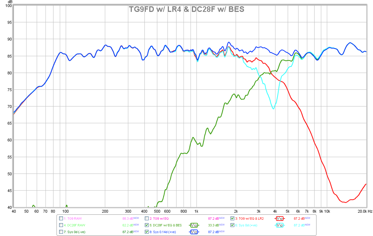

Ok, I am going to try to follow your experiment but do it a little differently as I already have a setup with dual TG9FD's and a DC28F silk dome on an 18in wide plywood OB ready to go. So mostly a DSP XO topology experiment...
I am going to take a slightly different direction on the XO, sort of aiming for Harsch style or other asymmetric transient perfect design.
Here is a photo of the setup:

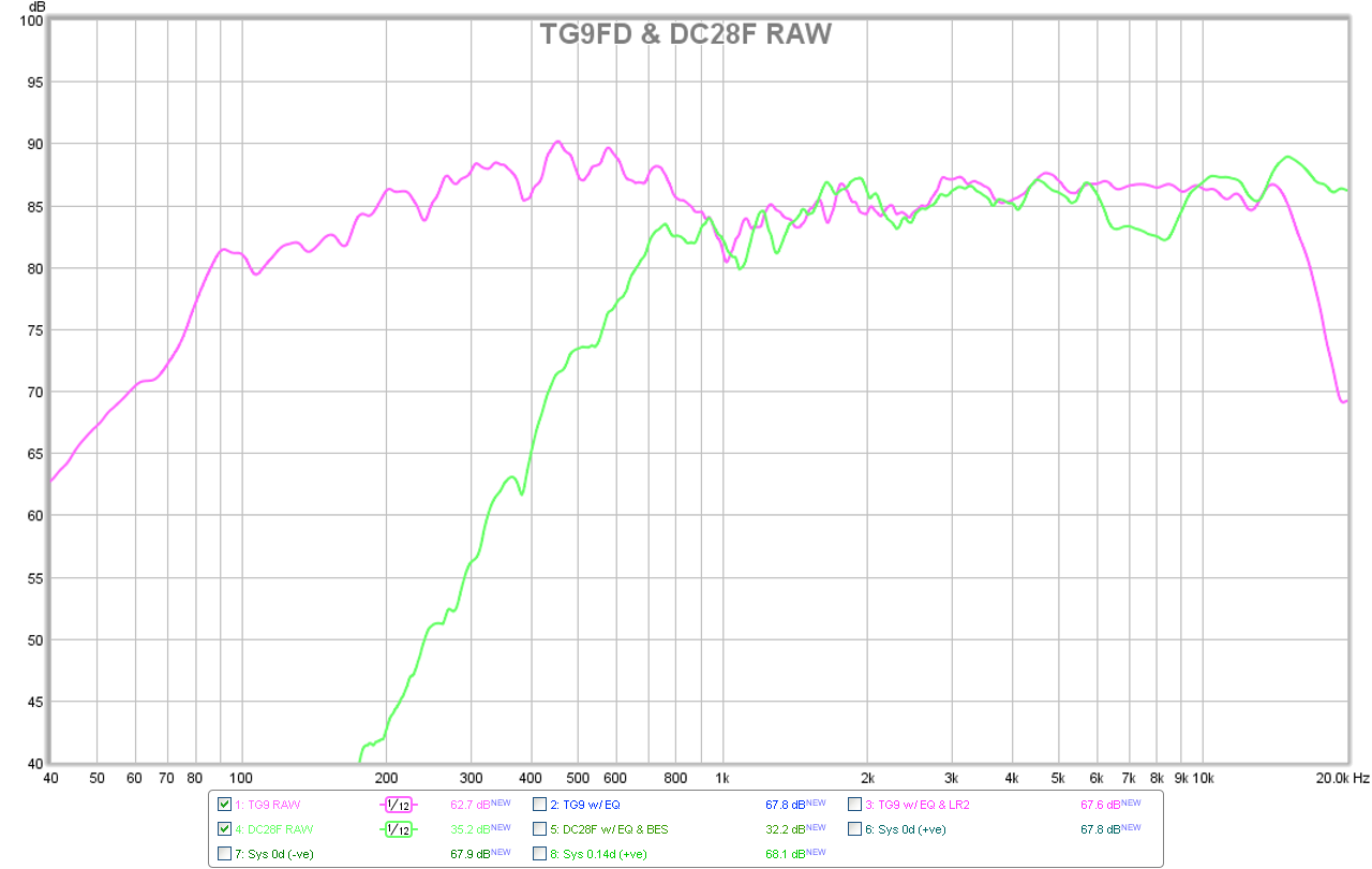

Here are the raw responses (an 18in baffle gets you a lot more bass extension before falloff):

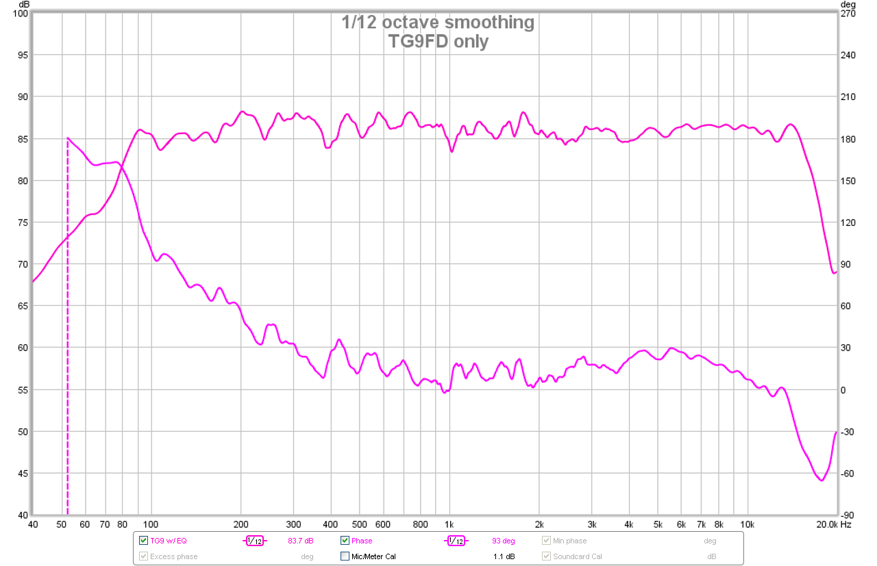

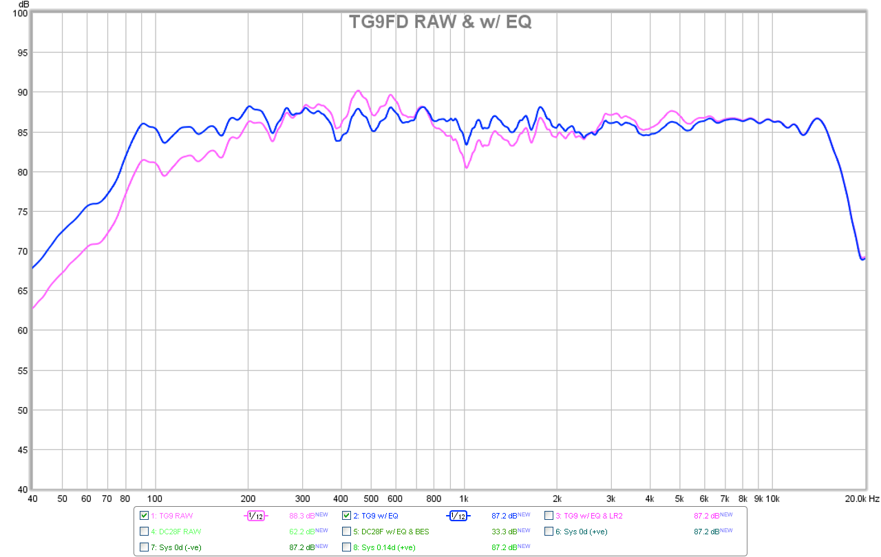

Here is raw and EQ'd response for TG9FD:

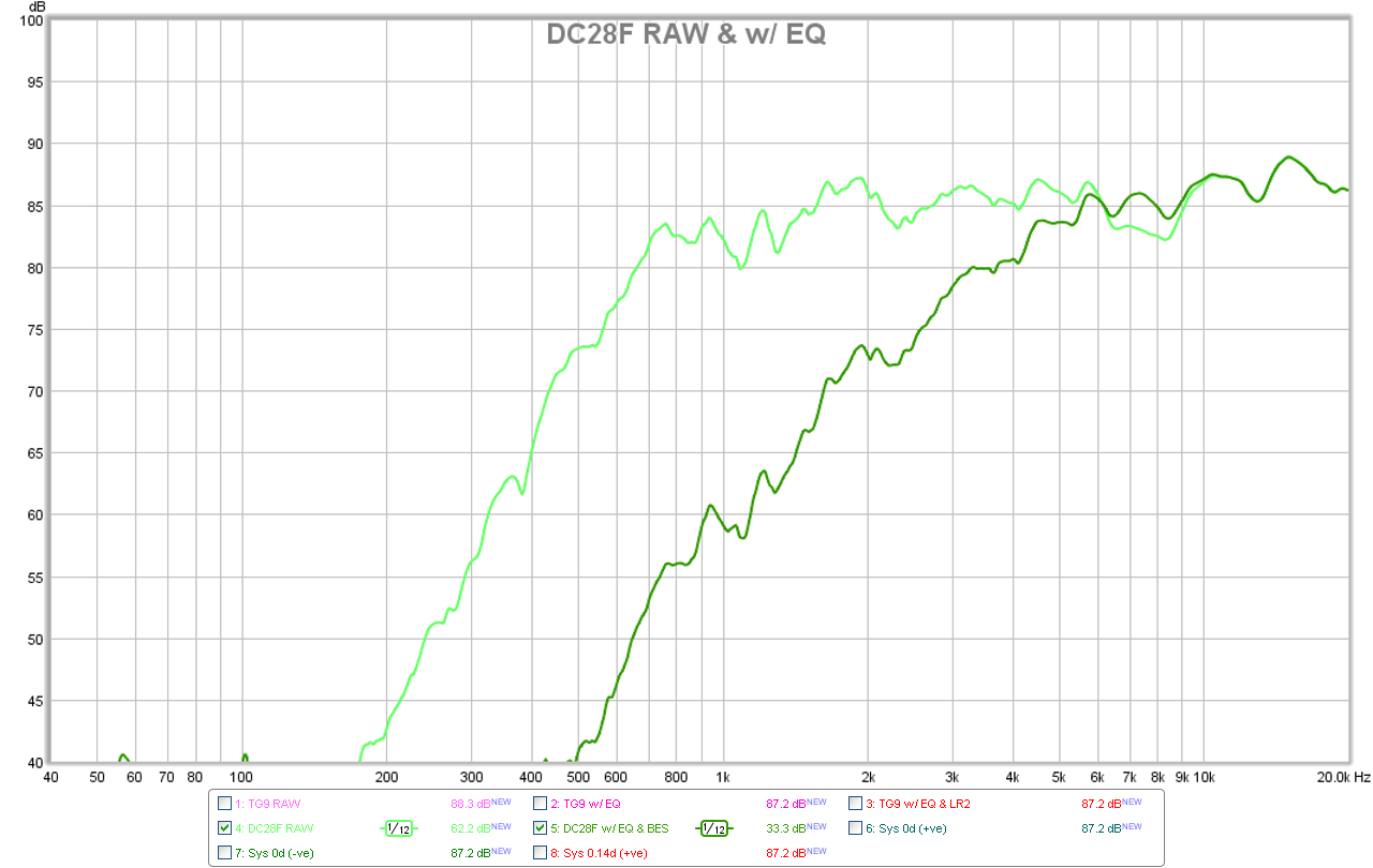

Here is raw (700Hz 2nd order Bessel HPF for protection) and EQ'd response for DC28F (with 2nd order Bessel at 4kHz):

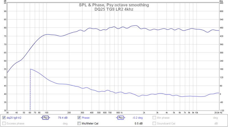

And here is the combined acoustic response with 4kHz LR4 on the TG9FD LPF and 4kHz Bessel on the DC28F HPF, resulting in 3850 Hz acoustic XO frequency as demonstrated by null from positive polarity and zero delay. However, adding 0.16ms of delay on tweeter (close to Harsch value with acoustic offset of TG9FD) and flipping to all positive polarity we get a nice integration:
Here is the phase which is pretty looking linear:

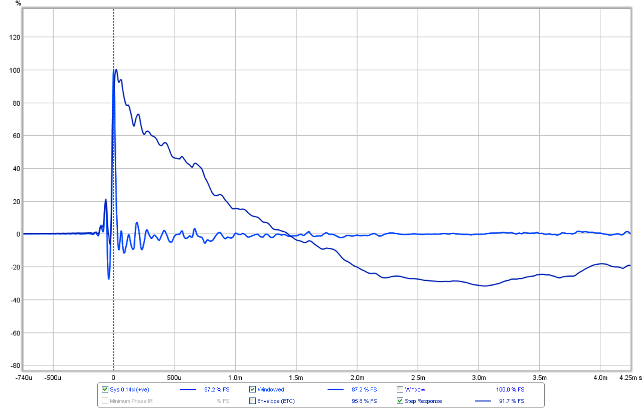

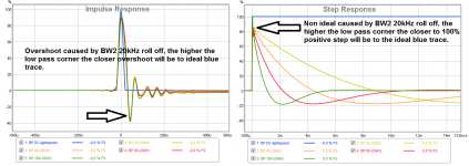

Here is the corresponding impulse and step response - transient perfect like yours:

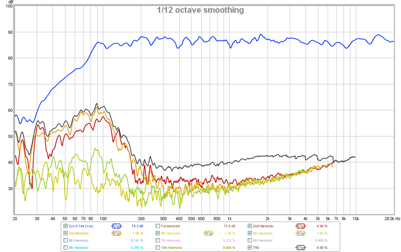

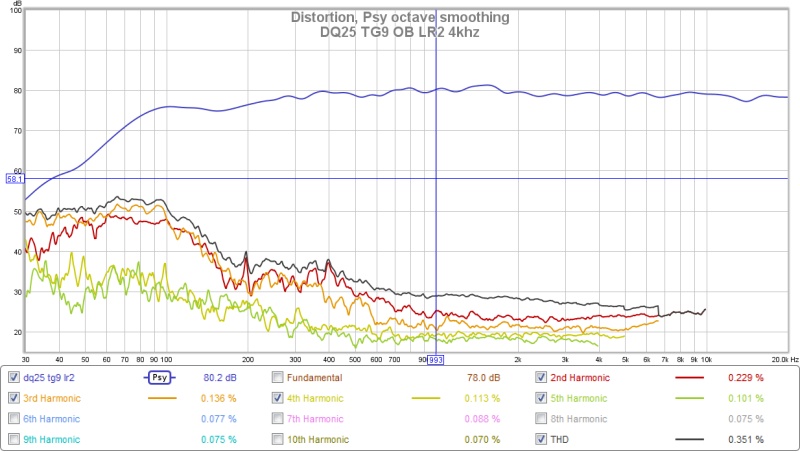

Here is the distortion - which says that when I add the woofer for a 3-way, if I cross above 400Hz, distortion should not be an issue:
So, it appears that a transient perfect can be obtained from an electrical LR4 and a Bessel. Probably in acoustic domain if I over-laid the textbook functions we are close to Harsch's BW4 and BES2 recommendation. However, the sharpness of the rise on the SR is better than what I normally achieve with the Harsch, so this may actually, be different. The key is to keep all polarities positive and adjust delay until integration is smooth and null dip goes flat.
I listened to one song and it sounds quite good - characteristically transient perfect. Bass is a bit thin

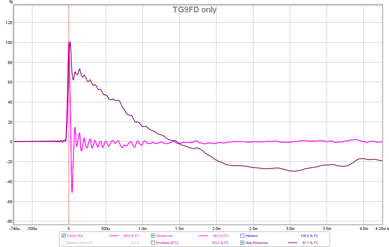

One may ask, why not just use the TG9FD all by itself, it seems to look pretty good after EQ? Well here is the TG9FD only phase:

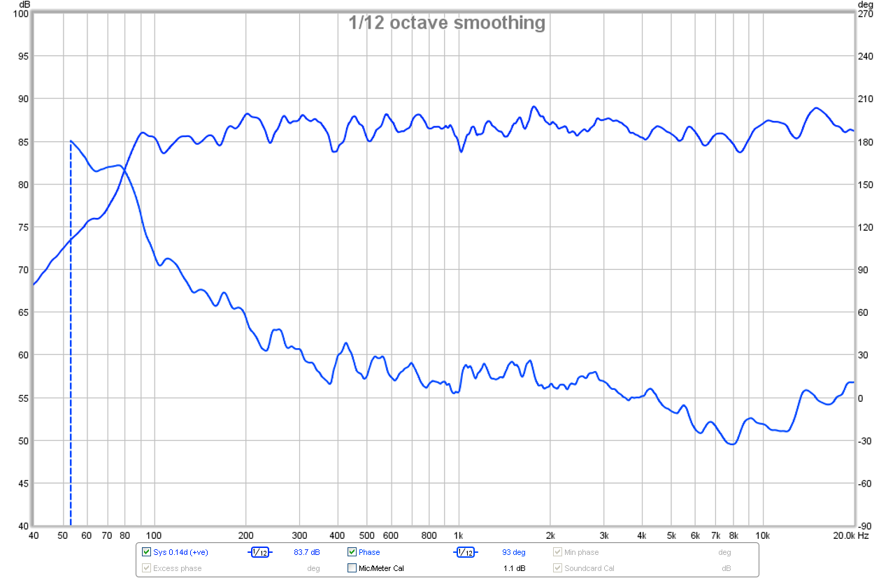

And here is the TG9FD only IR and SR - not as good as the combined 2-way sysem - mostly because such a steep cutoff is acoustically imposed on the driver at the high frequencies. Byrtt has shown electronic experiments that show this causes the overshoot and ringing in the IR and leading peak on the SR.
Excellent work and fast too (as usual). Mine is bass thin also, but the plan is to add a woofer so it really doesn't need bass below 300hz. Yours is definitely flatter before EQ though and appears to need less EQ adjustments than my tiny OB. With the miniDSP this is not a problem, but if we wanted to do a passive crossover then the large OB (or sealed or dagger or TL) would probably make more sense.
The dual TG9 definitely seems to have lower distortion though in the 200hz and up region. I think I am at a lower SPL than you but the pattern seems to hold. Both builds highlight the extra distortion that shows up below 200hz when run without a woofer

What is PSY smoothing? I don't have that option on my REW (maybe need to update?).
Psychoacoustic based smoothing?
That is very interesting. So all you need is a LR4 LP and a BE4 high pass, ad .16ms delay, and you get that... Very nice. I suppose you could do this with an acoustic offset if you wanted to use a passive XO.
I wouldn't call this STEP transient perfect but it has a good continuous flow in the phase. Transient perfect STEP would be flying higher for a longer duration.
My step on the same scale shows the difference:
See how it's still way up in the air? The triangle theory is fine but you have to look at the scale it is plotted on. In theory with flat response (the above STEP is with a different target) my step "crosses" the zero line at about 15 ms. Now this is of coarse a highly manipulated result. But that's how it looks if you get a flat phase result that follows the FR. The results Barleywater and BWaslo showed are also still flying high at ~4 ms. Of coarse it also depends on the low end extension. But the example in Stereophile of the Dunlavy IV was actually a bad example. It was measured way to close to really see it's step response. The speaker was optimised for coherency at a much larger distance. Once John Atkinson realised that he published a measurement at 3 meter:
which shows the step is still above zero at the 4 ms point (end of graph) and without knowing what the actual design distance would be the result could even have been better at 4 meter.
But the results you both are getting here show a smooth phase turn throughout the entire bandwidth. I.m.h.o. that is a good thing. It means the crossovers are smooth, the named targets are one thing, actually hitting them acoustically is key. This shows that EQ-ing to hit the target helps in getting a smooth transition from one driver to the next. It would also make it possible to straighten the phase with Rephase (for example) to get that transient STEP.
You might want to check the STEP at the listening position if you play with delay of the tweeter vs the woofer. The distances to the microphone are different if you step further back. I'd want it optimised at the listening position.
That's probably true in Jeshi's case with the small OB setup but I can't imagine listening to that rather big MTM at say 0.5 meter distance? So optimising and measuring the STEP at the listening distance would make the most sense. That's why you shouldn't measure the STEP of a big Dunlavy IV at close distances. The arched baffle, crossover and (passive) EQ are all optimised to hit target at that listening position. The big problem we have is room effects messing up the measurements to get it right...

@GregB, the Bessel is 2nd order electrical. There is some EQ shaping to flatten things before the XO so it would take more of an effort to have a good baffle that is either offset, trapezoidal, or rounded edges to minimize diffraction and also flush mount the tweeter bezel - which I have not done here.
