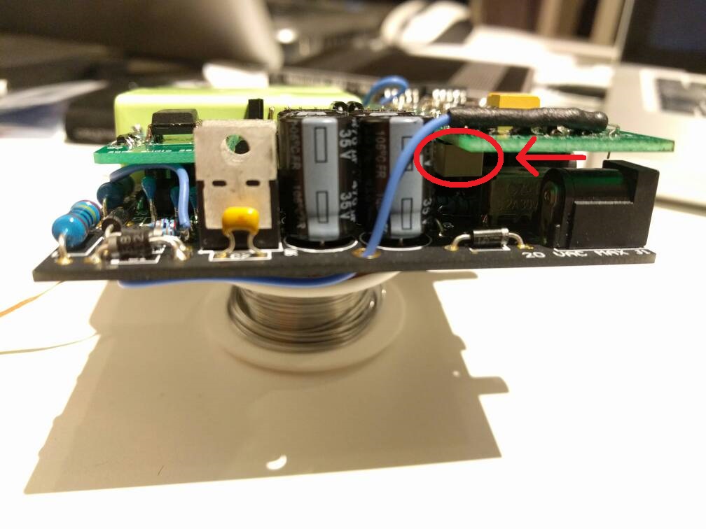

I just wanted to share with you my latest O2 upgrade with agdr's excellent booster board.
This time it is my battery powered low power version O2 that gets boosted up!
As I wanted to keep things as low power as possible, I went for OPA140s, which are agdr's second choice all things considered, an first option if lower current draw is a priority.
Anyways, 'nuff chitchat, let the pics do the talking!
The board was sent to me already populated by agdr, except for the opamps. That turned out to be my first surface mount soldering experience. It wasn't too bad, I think...
As you might notice, I removed the LEDs since I won't be making holes on the face plate, and it might save some battery power!
As it was getting crowded with the latch board in place, I decided to route and solder the anti-thump wire underneath the O2's board:
Quit snug, IMHO [emoji41]
Thanks again agdr for the quality of your work! [emoji122]
CHiroshi - thank you for posting those nice pictures!
I like your idea of routing the relay sense wire through the O2 board hole and underneath. Looks great. For anyone out there looking at the Booster Board the first time, I've circled the headphone relay in CHiroshi's photo, below. I have it upside down underneath the
Booster Board to fit in between the stuff on NwAvGuy's O2 board. 🙂
Excellent soldering work on those op-amps! The O2+Booster Board does make quite a boxful, taking full advantage of the vertical space. 😎
Enjoy! 🙂

Yes, those holes come in handy when adding stuff to the O2! You probably noticed that I first soldered the resistor sort of straight, but it was a tight fit with the surface components when closing the case. In the last pic you can see how I corrected that by having the resistor in the same "direction" as you would if soldering the wire the usual way.
