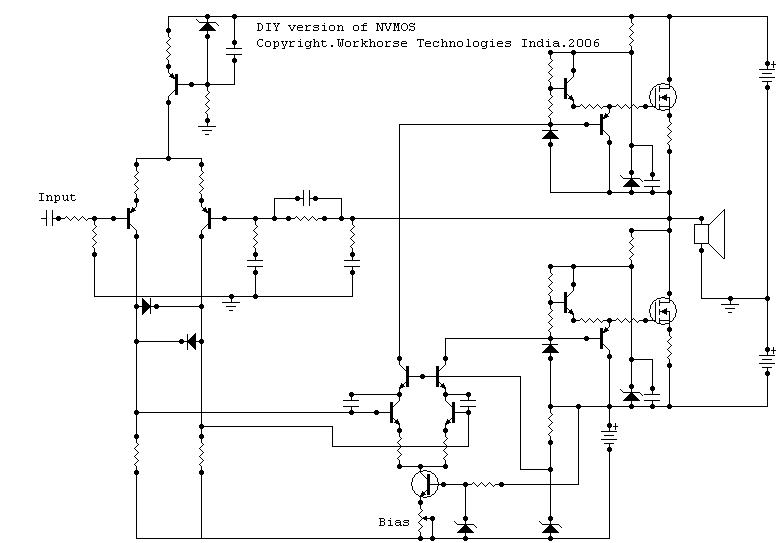

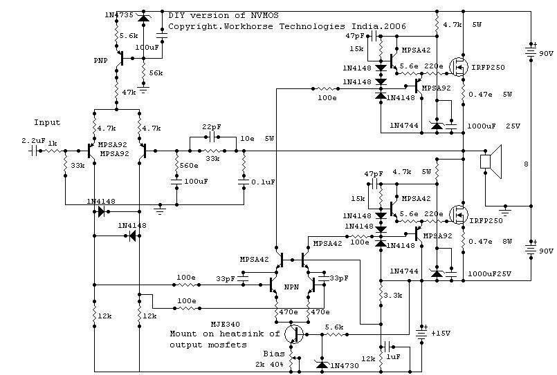

Now I have to post the Full Version of the DIY version...for you guys to move into making PCB's
Hi Friends,
A new updated NVMOS for DIY
K a n w a r

Hi Kanwar,
Great to see the design is finally ready.
What is the actual status ?
Built and tested by you and working well.
Only simulated on the computer.
Basic design which others can build and troubleshoot and refine .
Since you are loaded down with 'real' work it looks like it's rather unlikely that you can spend time with the design.
