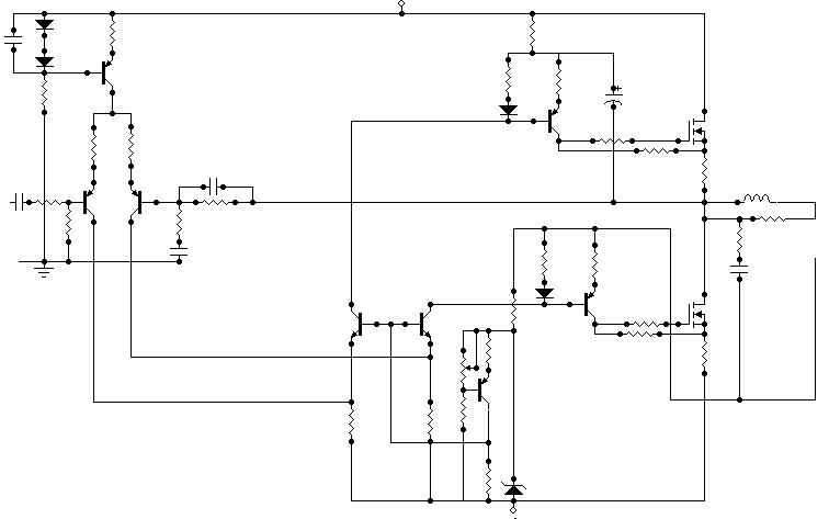

Hi Quasi,
Bootstraping is used to boost the drive signal to get maximum swing. This is how it works.
in no signal conditions the cap will be charged at a refernce voltage between the resistor and output. When the lower mosfet starts conducting the the out put swings negative and then the Voltage across cap will be Vref+Vnegswing and then it gets charged to high voltage and again when positive signal appears, the the gate of mosfet sees an elevated voltage due to charge stored by cap and it gets an extra voltage at gate by the virtue of virtual supply emulated by the cap between resistor and output , thus the output swings to rail.
This technique is always used in Class-D drivers to get max High side mosfet swing.
hope you understand it.

Sorry quasi at this time,
This type of arrangement is not valid in your design, because the driver stage is itself act as a differential also.
But you could very well adopt my circuit in yours to get this desired effect.

lumanauw said:Hi, Kanwar,
I think your design of full Nch+folded cascode could end up in a good DIY amp. Please keep up the good work 😀
Thanks for the supportiveness and thanks for further encouragement.🙂
darkfenriz said:Sorry Kanwar
I wanted to ask you:
why don't you join pnp driver's COLLECTOR with mosfet's source?
this could change voltage drop on source resistor at HF.
Suggestion noted!
Thanks for the comments
New update schematic.
Yes, that's it.
wondering if you still need gate resistor now... as slew should be fast and pretty symetric compared to other types of driving.

Using source resistors goes against rail to rail swings, don't you think? Of course, you have no choice if you go paralelling output devices.
I would not connect the C of the driver to the source of just the 1st MOSFET, as it worsens current sharing at switching. Not much of a problem for resistive loads, but for reactive...

Hi DarkfenriZ,
In reality one must use gate resistor or Ms Oscillation would welcome unintendedly...............😉
Thanks for the information.....
and thanks again for your effort
What are your views regarding the new biasing regulator and push-pull drivers .....
best regards,
Kanwar
Hi darkfenriZ,
I simulated the design but, its slew rate is nod good and again it has very low open loop gain , thats why i am going to implement second differential + cascode loading in the place of folded cascodes, thereby facilitating the increase in gain and elimination of miller effect to some extent as well.

Hm... strange
everything seemed OK.
push-pull drivers were good idea,
bias regulator did not provide thermal stability, but it shouldn't affect slew
maybe you've overcompensated fequency?
I'll try to simulate it too and maybe change some bits and pieces.

Yeah , the PP drivers were a good idea😀
The bias regulator has nothing to do with slew or gain.
I donot even use the compensation cap at the feedback till now.
Waiting for your sim results................
cheers,
kanwar
I just simulated this amp with some tweaking and now the results are far better than previous ones.
Just a question ever tried to drive the mosfets with the opamps.
I just saw QSC PL9.0 uses opamps to drive the mosfets.

The folded cascodes are just good for less phase shift at high frequencies , but the open loop gain still suffers alot, i need to check it throughly... but very busy, but might give some precious bits of time to this DIY amp and it will be a project in reality very soon.

back again.......
just going to test the very much appriciated design of mine.......😀 😉
input -> differentials with cascode loading....
VAS -> again differential with something extra....++
Driver stage -> DarkfenriZ Current Mirror style or Kanwar custom driver ++ pushpull effects...
Output -> all of you know that will would be our N-Channel mosfets
regards..

End result Kanwar, in measures we can appreciate? The ++ features are great for the marketing dept. Results count cross ref'd against a BOM and for DYI degree of difficulty?

hi dark fenriz,
Your current mirror decreases the openloop bandwidth and also causes stability problems in high frequency region....
rolling back to push-pull drivers and folded cascode increases the performance and using regulated bootstraped driver supply eliminates the seperate supply issue and solved the prblem alot....
regards,
K a n w a r
regards,
K a n w a r
Hi
about mirrors in HF region you are probably right, they are not best choice as far as HF is concerned. How do you drive output mosfets now?
