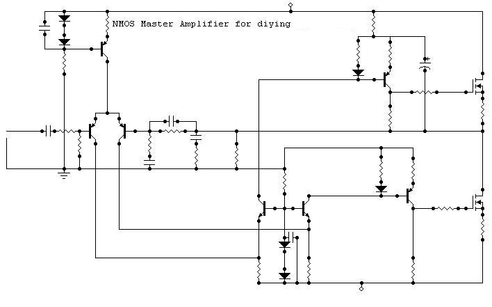

With the original circuit:
1) potentially very serious, if the driver stage fails to provide the driving current for any reason, the outputs are fully biassed ON (= lots of smoke!).
2) driver LTP must be able to swing down very close to -V rail if you want to switch off the lower transistor, which requires a very low voltage reference for it's CCS. At 100 deg C for high threshold MOSFETs you are looking at close to 2V up from -V, this could have been a problem. The current mirror approach solves this.
Darkenfriz, I would say that the top MOSFET in the original schematic was also a current cource (disregarding the PSRR issue for now) as it's driving voltage was locked ONLY to the driver stage current and not to the output voltage, by virtue of the bootstrap cap. In other words, the output impedance of the top half is also very high. It is certainly true in you implementation with current mirrors.
I still have an issue with the bias generator. I think Darkenfriz is on the right path as the IRF610 will definitely do a good job of thermal tracking. However, the circuit has gain from Vgs of the thermal sensing MOSFET to the output MOSFETs Vgs, equal to Rgs _outputs / 2*Rgs_ccs. Thermal tracking depends on this 'gain' as the thermal gradient of Vgs threshold is also amplified. This is always the tricky bit with such topologies.
I once had such a problem and this is how I solved it:
1) You need the voltage on the CCS current sense resistor (the one across IRF610 G and S) to track equally with the bias Vgs of the output MOSFETs. In order to do so your MOSFETs need to have proportional Vgs threshold, or the tracking will be off. The simple solution is to aim for equal threshold, which means you need to chose the sensing MOSFET that is built on the same cell technology as the output MOSFETs. In this case, gain will be ~~1 and Rgs_ccs ~~ Rgs_output/2. In other words: carefully evaluate the MOSFETs to use and adjust the CCS 'gain', you cannot just use any resistance ratio.
2) Consider adjusting the idle current by adjusting the resistor* that feeds the junction of the base of the BJT and the drain of the IRF610 in the CCS. Increasing the current requires increase of the IRF610 Vgs, which provides the means of adjustment. At the same time, the current sensing resistor remains the same, and so does the Vgs 'gain' of the CCS with respect to the output MOSFETs.
*At first glance one would expect a constant current source to be a better choice in this place, but in fact a simple resistor has the ability to compensate changes of MOSFET Gm with Vds, which apply equally for the CCS MOSFET as for the output MOSFETs. In order to use this 'feature', MOSFETs built on the same cell technology have to again be chosen.
You also want to reduce idle current modulation by power supply droop. In order to do this, split the adjusting resistor into two and connect the midpoint to -V rail through a large cap (in other words, add PSRR to the CCS by bootstrapping it's reference)
Yes, you're right.
This is the new schematic with folded cascodes implemented to achieve good high frequency response.😀 😉 😀 😉
Bias generator is absent , but i will think again to implement it in this type of circuit.:angel: :angel: :angel:

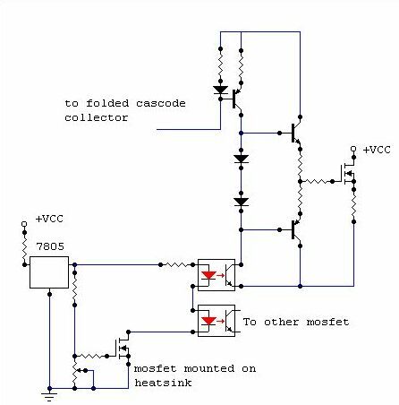

hi every body,
here is a new update to the schematic with Push-pull drivers and optocoupled biasing with mosfet as thermal referencer.
hope you all like it, our new creation I will name it "THE GLADIATOR"
regards,
Kanwar
Seriously Kanwar,
This folly of yours is starting to look like 'one with the lot' - great for marketing I'm sure. Let's see, it's got N CHANNEL, it's got FOLDED CASCODE, it's got RAIL to RAIL ( does it still have that?), it's got SIMPLICITY ( no it lost that way back), it's got OPTOCOUPLED bias (coming),....
It's also got complex thermals, electro's in the signal path, and DC offset? It's got THD? It's got slewing? It's got COMPLEXITY.
It's DIY scary is what it is. GLADIATOR indeed.
amplifierguru said:
Seriously Kanwar,
IT is still a regular and simple circuit to achieve less thd ,RTR swing, good high frequency response.
RTR swing- is prime importance of every PA amp to achieve max efficiency.
N-channel - for low cost good solution.
Folded cascodes- again for high slew rate
optocoupled bias- for simple yet effective biasing.
Gladiator-its simple name [or you still have the difficulty to even pronounce it well]
All this is a simple , not a complex amp.
Hey man aren't you the Great GURU of amplifiers .
You shouldn't be talking like this on DIY forums.
i still respect you alot but may be there is a little misunderstanding between us due to your misconception regarding certain points in proamps.
regards,
Kanwar
Don't worry I'm sure it's going to boil down into a simple, efficient, forgiving, self-healing, DIY gem and not a complex, prone to smoke in public, burnt offering. I for one am ready to throwaway all my P9240's for the sheer ritual pleasure such enlightenment brings.
Well said, how about we add some more complexity to the design by adding some mechanisms to prevent further catastrophy, starting with a thermal shutdown, DC protection, peak detection, softstart, etc.
Best regards,
Sander Sassen
http://www.hardwareanalysis.com
Workhorse said:
hi every body,
Hm... way too complicated for my liking...
How about input PNP LTP feeding second stage NPN LTP connected to a PNP folded cascode driving the outputs directly?
2nd stage LTP and folded cascode terminate at the bootstrapped supply.
The disadvantage with this is increased losses in the driver stage as 2nd stage LTP and folded cascode spans ~full rail voltage and has to provide all the driving current since the folded cascode has no AC current gain.
Also reference voltage of the folded cascode terminates in the bootstrapped supply whic means you need to use a current source pull down for good PSRR.
Advantage is relatively easy biassing - provided Re of cascode is equal to Rgs of output MOSFETs, the reference voltage for the cascode bases equals bias Vgs + one diode drop. Also, current drain from bootstrapped supply is constant due to the differential action of the LTP/folded cascode. Finally, current limit is easy as maximum Vgs voltage swing is defined (Rgs * Itail of 2nd LTP at most).
For amplifierguru: don't worry, this is just a mental exercise 😉 at least for me...
Hi Kanwar
Why don't you join pnp driver directly with mosfet's source?
I think it could give better HF switching. What do you think?
And give 3rd diode (or use 1 LED) to prevent drivers from B-class working at HF. Remember that you need lower gate R now..
just suggestions...
regards
forgot to mention:
it would be easier to modify ref. voltage for folded cascode (from your post25) by Vgs multiplier except these diodes to keep bias steady.

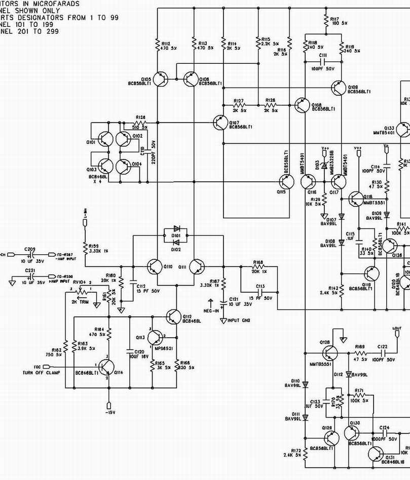

Hi, Kanwar,
This could be a good design 😀
Here I attach a proposal for thermal compensation scheme, Q113 is attached to heatsink for thermal compensation.
Also the driver of the final NCH mosfets are totem-pole Q128-129 (biased with D110-111) and Q118-119 (biased with D107-108)
I think this will simply increase something i dont like .......
darkfenriz said:
Hi Kanwar
just suggestions...
regards
forgot to mention:
The PNP driver will then has to be ascertained to deliver more current to charge the gate at high frequencies. Driver improve turn-off capability as well.
Regarding cascodes, shouldn't the VGS multiplier degrades its performance by changing it operating voltage thus current through it and eventually the voltage gain, if not then it will be very easy to implement it.
lumanauw said:
Hi, Kanwar,
This is surely a complex thing not recommended for diying purposes. May i could give it a consideration too, but I am very busy right now.
