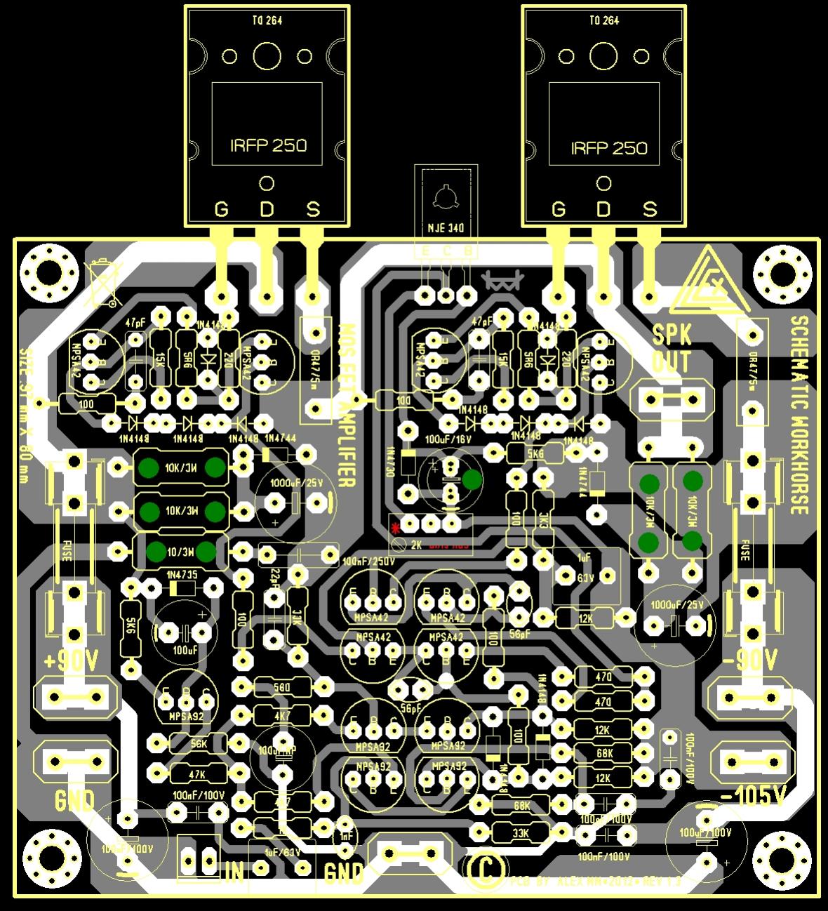

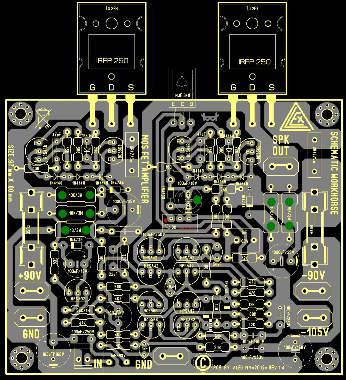

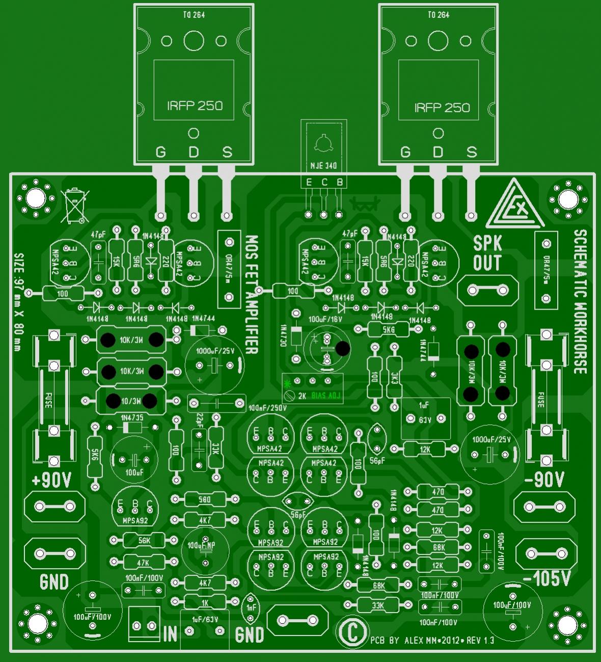

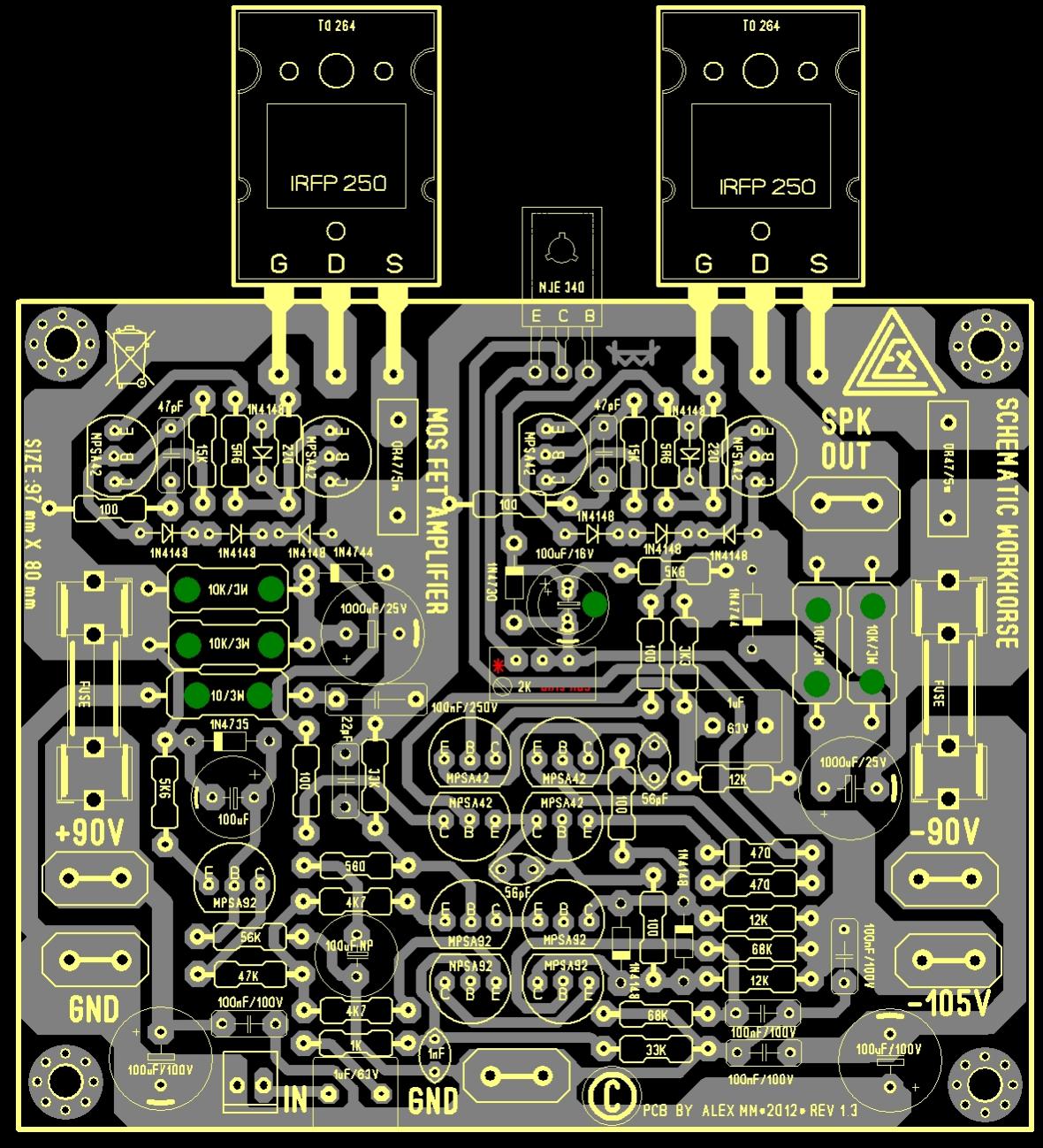

....Updated PCBrev 1.3 I need Q.C if it's correct layout .....
All the best Alex.
Change the pinouts of differential as well as gate driver transistors as per latest schematic to BC556/546 devices. Pins should be swapped. Rest are ok with MPSAs.
Nice work Alex

Hello to everyone,
Presented here is a simple n-channel mosfet amp [block diagram]capable of delivering rail to rail swing without the need of extra complexities such as seperate driver supplies to keep the regular DIYer in a simple and safe state at the same time enjoying the pleasure of using N-channel mosfets.
Suggestion and comments , subjective or objective, constructive or destructive criticism are most welcome to further develop it into a design which will be a very simple and easy to build a excellent sounding amp.
So comment and enjoy the spirit of DIYING
Kanwar![]()

With a single pair of regular IRFP260 / IRFP360 / IRFP460 mosfet properly mounted on good heatsink with aluminum bar, one can easily get around 400W into 8ohms on +/-90V rails.
For more power one can parallel the mosfets to suit the needs.
FR xtends beyond 40khz, RC compensation is used to avoid oscillations.What's the frequency response and the adding of the 33pf,100e resistor?
What happens If it's left out?
