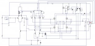

My New thing under creation is Full floating Grounded Bridge 2 step Class-G with ALL N-FETS 😉
is this schema create by "circuitmaker 2000"?
if yes, please open the button "OPTIONS" and then "Schematic" and then disable the field "Show Pin Dots" about "General"
Then the circuit is better to read and to understand like my H-bridge circuit in the pdf attachement (based on the "virtual complement" concept, introduced by Bengt Olsson, Electronics World, Dec 1994)
Your circuit has 2 main flaws.
1. No common mode error control, your bridge needs balancing like a bridge centering servo.
2. The Bengt olsson stage you are using suffers from huge cross-conduction at high frequecies above 1khz, because the upper mosfet doesn't turns off properly while the lower mosfet is in conduction.

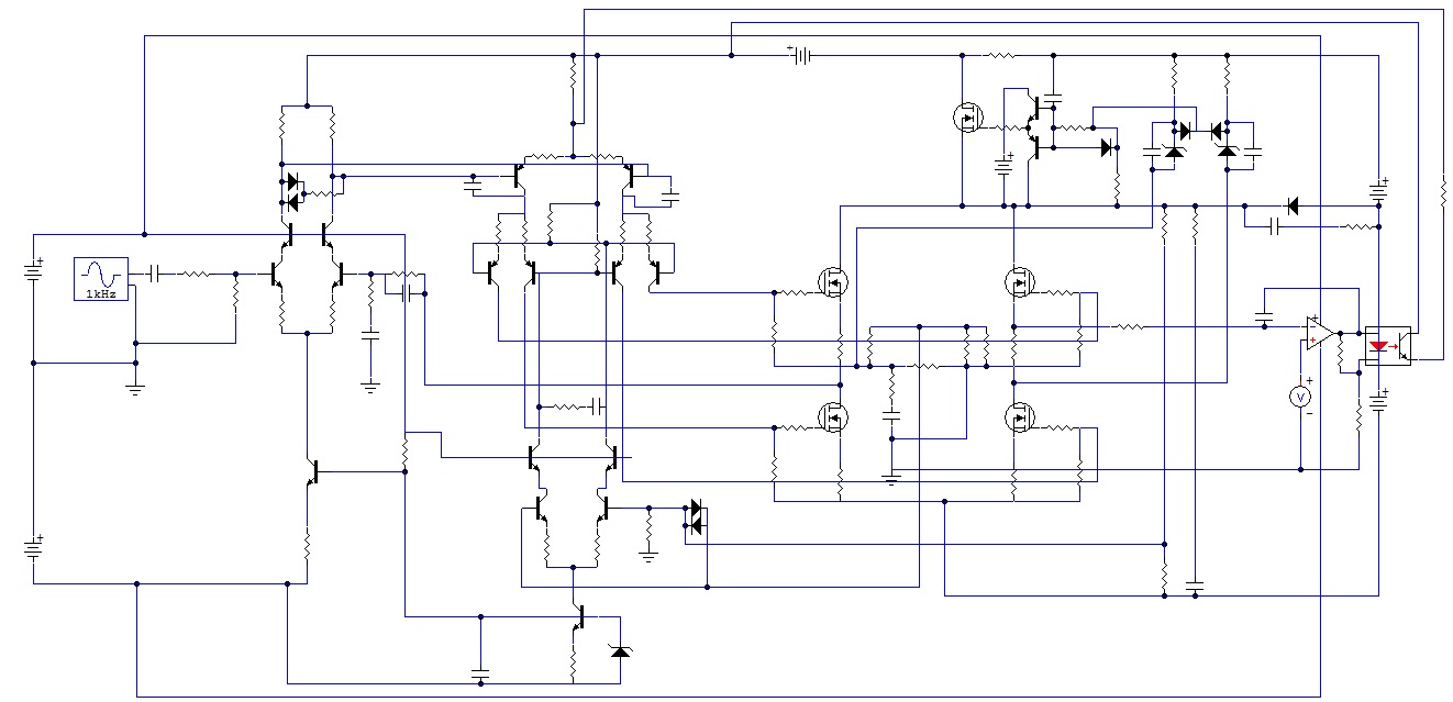

Here is the updated one.
Kanwar
Thank you for redraw and this advices. First advice I understand clearly, but for a simulation task this isn't necessary. Please note: the GND (earth) symbol is arbitrarily set (for getting simulation results) and have not to do with the actually GND line.
Also second advice I also understand, therefore it is to get proper sound only by class-A (hard running) mode.
The same I observe by the last topology from the pdf URL
http://www.ant-audio.co.uk/Theory/N-channel D-MOSFET output stage with improved linearity.pdf
My Opinion was until now, such MOSFETs in general loves idle currents above at least 300mA.
Mr. Bob Cordell and an other member tell me by post #14 about
http://www.diyaudio.com/forums/soli...s-ab-overview-p-spice-urls-2.html#post2569135
that is no true - 7mA are enough for good results, as to observe by several power amps from the brand "Peavey" (without mention of model No examples). If I have time, I will investigate this.

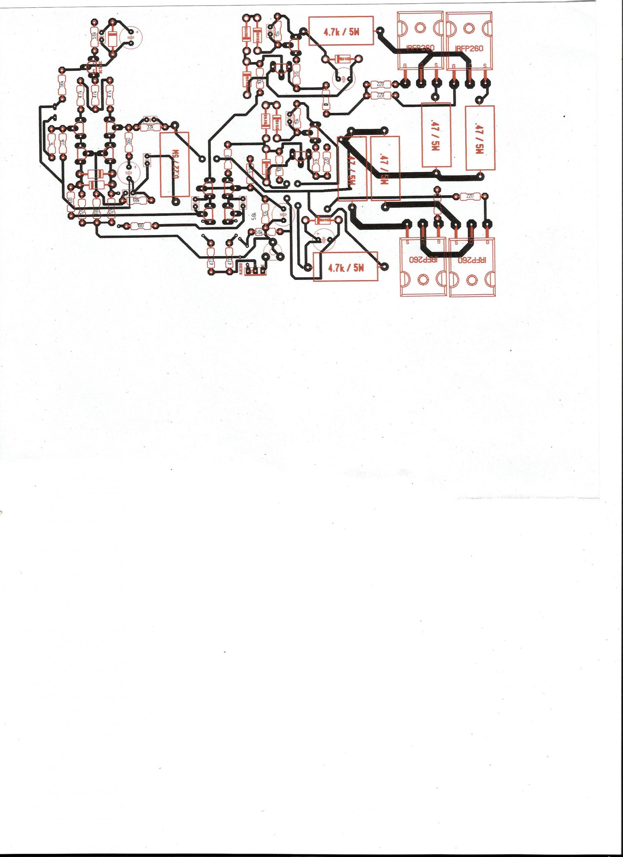

Hi Alex mm
greetings can you please refer to which schematic you are following
for pcb you posted waiting for you to complete pcb to try out how amp performs
warm regards there is also a positive15 volt supply
andrew lebon

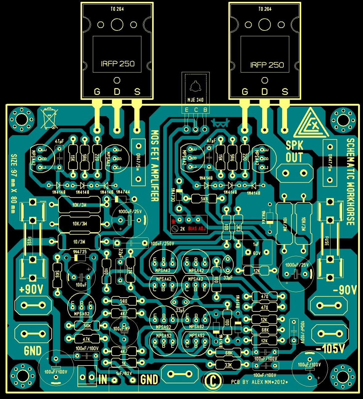

..... PCB for post # 252 layout in few hours 🙂
Regards Alex.

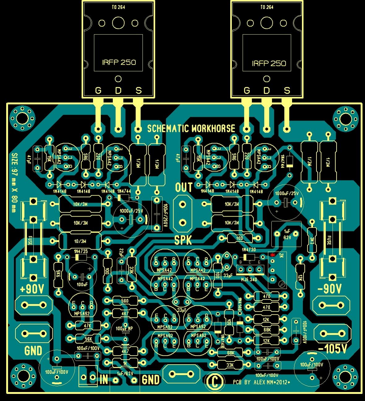

Nice attempt,
The MJE340 must be mounted to heatsink close to mosfets, it controls the bias and needs thermal feedback from heatsink. Either change the layout or you need to mount the device through wires. Also the holes of Zener 15V 1W looks small. Pinouts of MPSA transistors are also wrong.
Quick Job
HI Alex,
I am amazed how quick you did the layout after talking to you about doing a board for the NVMOS amp.
Do the suggestions made by Workhorse who is the designer of the amp and it will be a slam dunk.
You made it more plain when you used -105 volts instead of -15vdc referenced to the -90vdc supply. Good idea,less confusing.
This board layout is from post #252.
Listen to what Workhorse says and you will come out with a great pc board.
Thanks for taking on this project.
Sam
